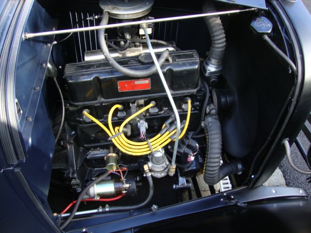

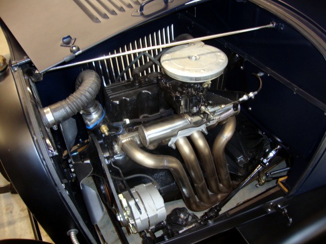

    here's shots of jersey suedes home made mounts
    motor wise yes the 151 heads fits and raises the compression ratio to that of what GM built the forklift/pump motors running on NG or propane with flat top pistons to 10.5 with dished to 9.2
    with lances car we used a stock marine grind cam sounds like a SB at idle yet sounds like it's a banger on acceleration

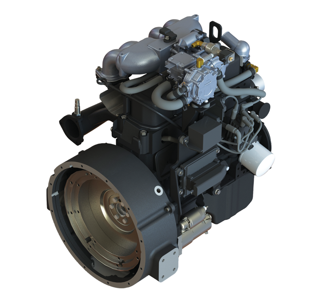

    origin engines had that one 3.6 liters https://originengines.com/origin-engines-3-6l/ and nothing more since that shown, it would have been nice going by the chart inthe link ,4 bolt mains , roller cam,piston oiling jets turbo and non
    here's two more of lances a bone

    My Contact a PSI in IL that out fits engines for LP and dual fuel for industrial applications like forklifts and sweepers and such said there was some new China or similar import 4cylinder engine coming in that was like a GM but not made by GM . I was trying to get him to get me the details . They have exhaust and intkes tht will fit a alter head 3.0 mercruiser but my god the st
    Might be the same long block as this Origin engine . Not lot of Hp for that with 9.5-1 AND a turbo I notice but it is at a low RPM .

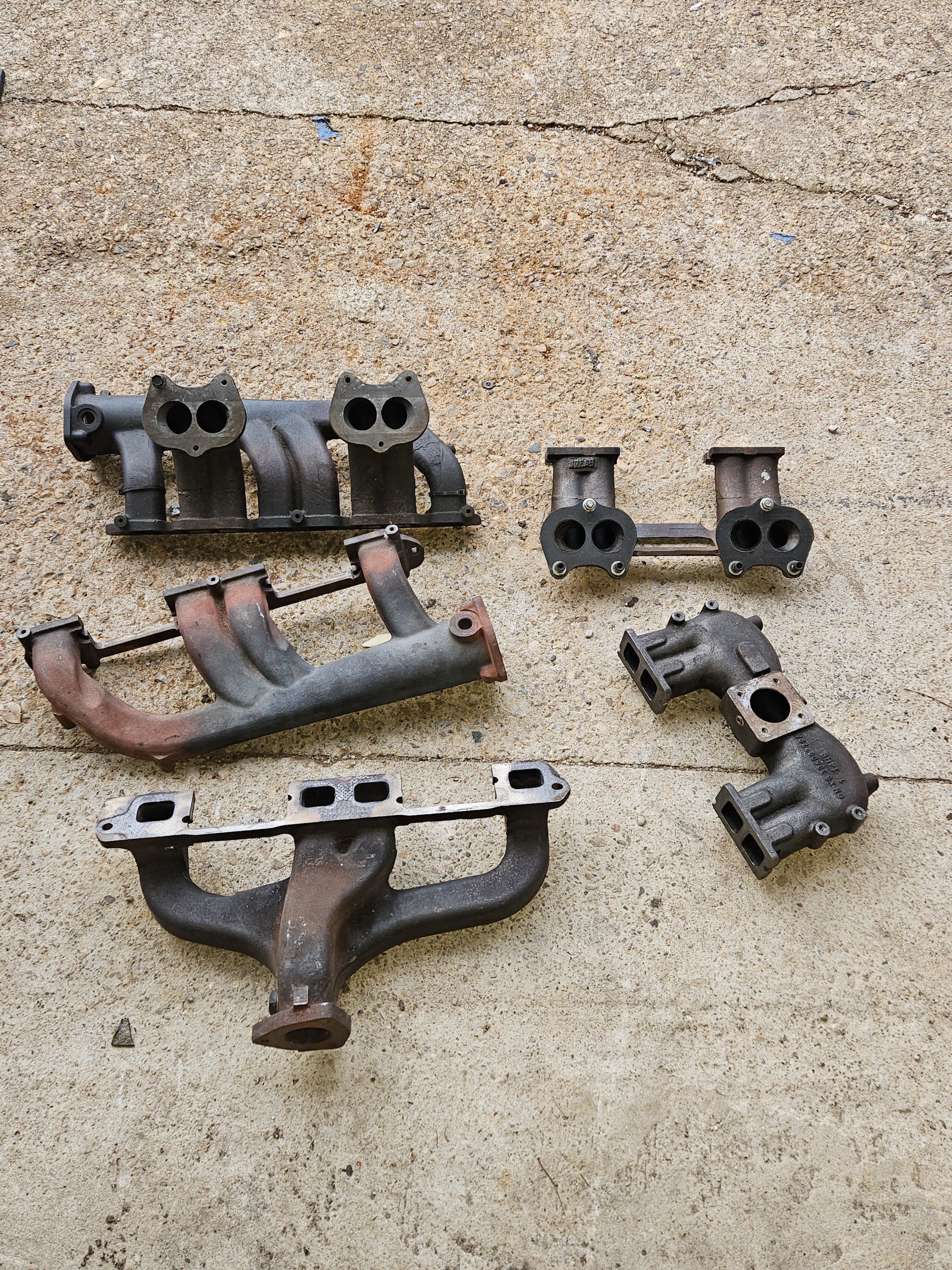

    These are all 3.0 GM manifold off a industrial application .
    The ones that look multcarb would have a aluminum plenum that bolts on that work go over the top of the valve cover .
    There all the smaller later 8 port type. I think a adapter flange could be used to work on the 2.5 heads fairly easy if not as is.
    The intakes do not have huge ports but I'd bet there better than a boat or a Chevy II ( MAYBE)
    IM hoping to get one on a 2.5 mercruiser engine on a run stand with a pair of rodchester 2bbls
