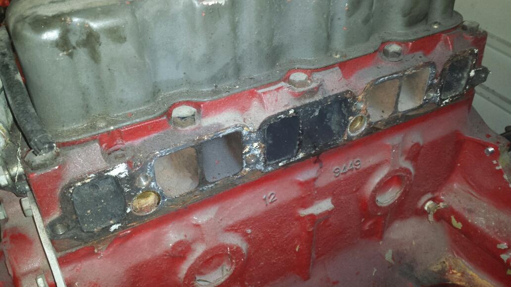

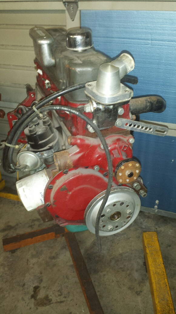

    I'd like to ask a VERY basic question. I just purchased part of an estate and in the 10 engines I got was an OMC (tag on the p***. side of block) 4 cyl. Is there any externally visual way to tell if its a 153 or 181 cid. There are numbers stamped into the OMC tag. Would that help me?
  18. Model A Vette
    Joined: Mar 8, 2002
    Posts: 1,075
    Model A Vette
    Post a picture of the tag or at least post the numbers on it.
    I think OMC engines are easily to id.

    I'll take a couple of pics. It has a header, chrome side cover and water outlet, Offy breather on the valve cover and has flex plate not a flywheel. Used in a racing application? I'll have to take the header loose from the head...check out the ports.

    According to one of the boat forums the Cu14d is a 120 hp twin carb engine. Pretty sure it is a 153.
  23. gearheadbill
    Joined: Oct 11, 2002
    Posts: 1,339
    gearheadbill
    If Charlie is correct about the 8 port head, then its a 153 with a 181 head?
  24. That 8 port head looks like what I am used to seeing on a 181 but since they interchange it is possible to be a 181 head on a 153. Have you tried contacting OMC with the numbers? Remember you should replace the cam before using it on the street.

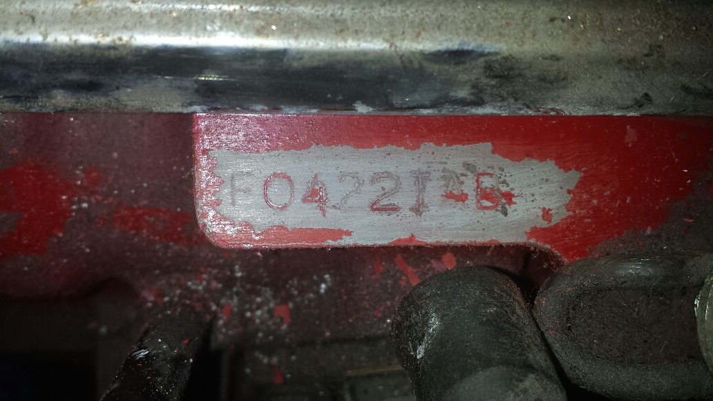

    I recorded the stamped onto-theblock engine number. It appears to be F04221AB. I ran a Google search but came up with nothing. Does this help to i.d. the engine?
  29. Try Googling some of the companies that supply parts for these engines and ask them.
    Charlie Stephens
  30. gearheadbill
