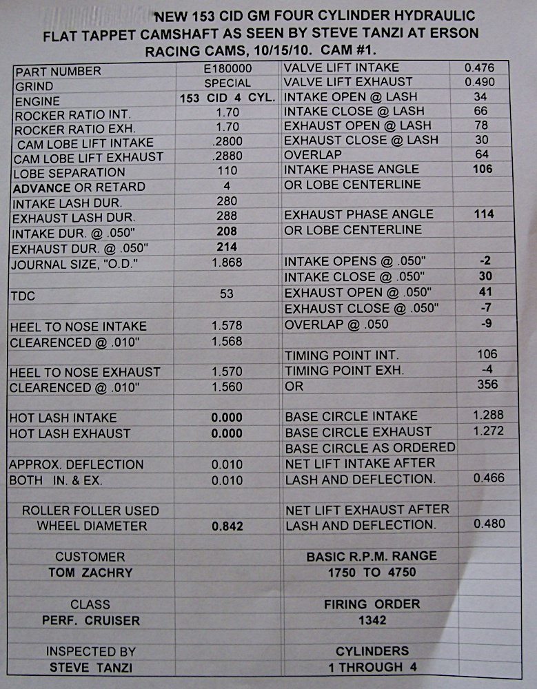

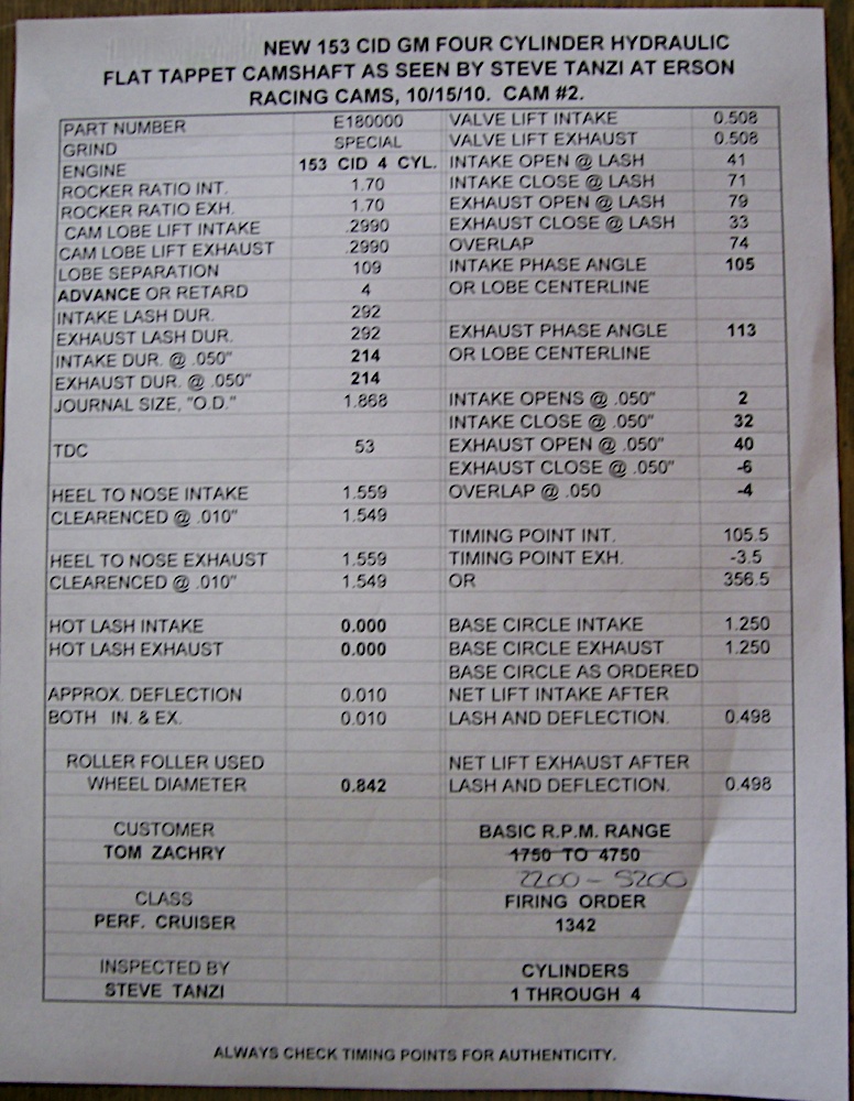

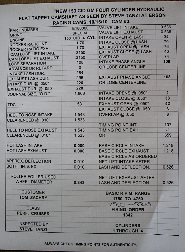

    Jim, Do you have a build thread? I'd like to see and follow your build. Mine is a '26 Chevy roadster. Here are 3 cam grinds that Steve Tanzi worked up for me before Erson moved back East. This was figured using big block roller rockers a 1.7 lift. I chose #3 and the final sheet shows a rocker ratio of 1.75. The springs are small block but I'm not sore which ones. The head work was done by Tom Lowe. 100_1910.jpg 100_1909.jpg 100_1908.jpg 100_2040.jpg

    Interesting data on your cam shaft grinds. Being an old "small block Chevy guy",(worked 30 years at the small block plant!) the approx. 290 duration on both exhaust and intake and around .500 lift at the valve are what works in a small block for the combo of cool "choppy idle" and decent response at low RPM. Do you think Tim Lowe did special work on the heads to accommodate the .500 lift? ...(a small block will handle it with every thing stock) Thanks again for your all of your info it helps alot.... Have you fired up this engine yet? .... are your working on your 26 roadster?

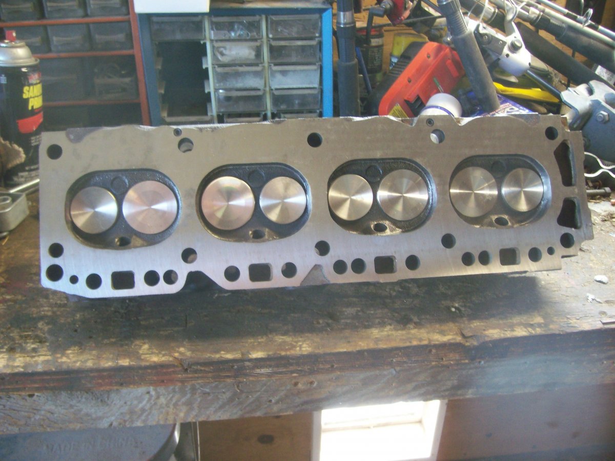

    My engine is still in pieces. I ran into a slight piston issue and it stalled me a years or so ago. East to fix but life gets in the way. Tom Lowe did a lot of work on the head but not in that area I don't think. It has 1.86" intakes and 1.60 exhausts. He installed lumps in the intake ports and removed the head bolt boss from the intake ports. These engines are 2/3 of a 230 six and use some of the same parts as small blocks.
