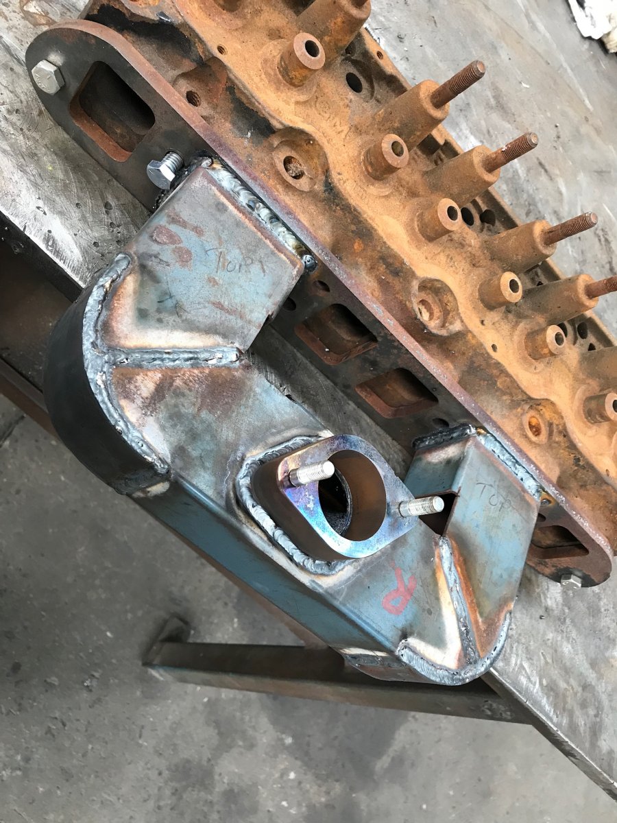

  30. RoddyB34
    Joined: Oct 13, 2009
    Posts: 542
    RoddyB34
    Almost finished our intake manifold ,it was the easiest way I could think of to do ,,internal corners will be radius formed ,the car is going in for the headers next Monday ,the exhaust guy is happy to make them on the one piece header plate , image.jpeg
