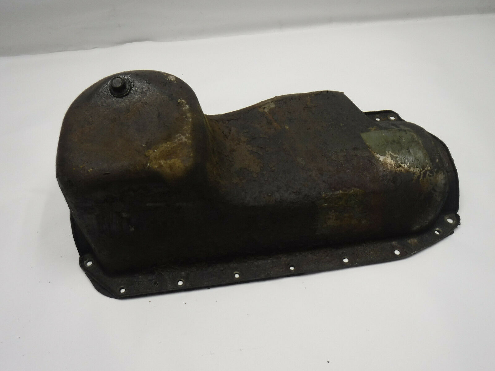

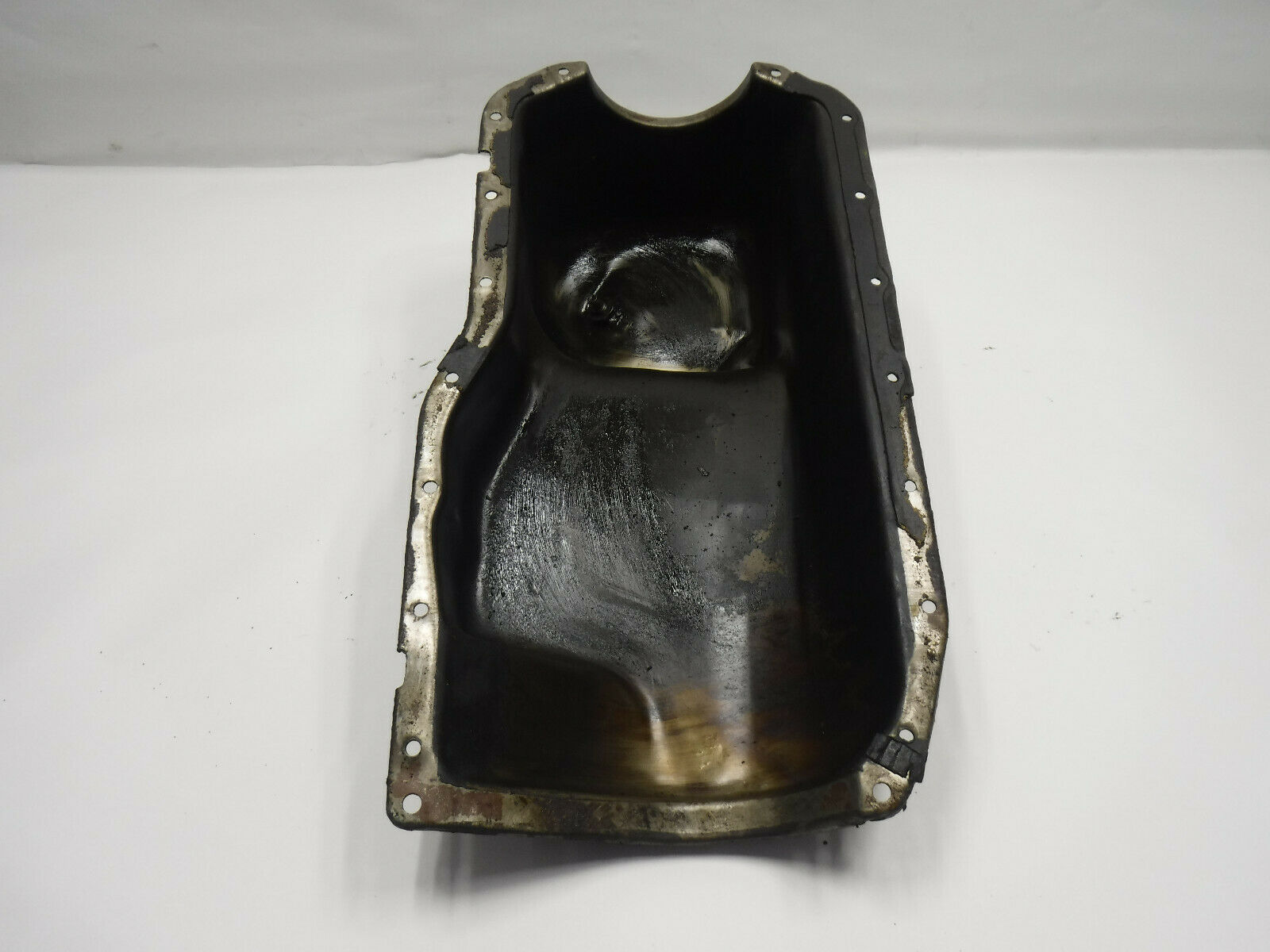

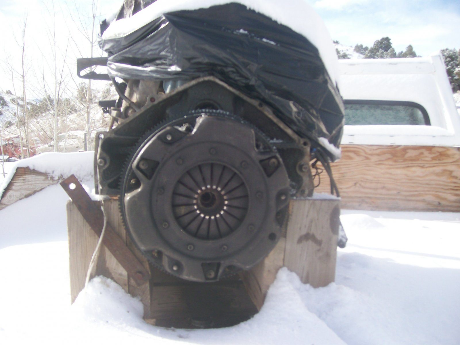

    I just bought a rear sump oil pan just to make sure it would would fit these. It is for an early a 2.5 from a Jeep CJ5,CJ7, CJ8 from '80-'83.
  8. Turbo67
    Joined: Feb 14, 2014
    Posts: 10
    Turbo67
    from Southeast
    I am unfamiliar with the 2.5 engine. Is is a GM/OMC/Mercruiser?
  9. Six Ball
    Joined: Oct 8, 2007
    Posts: 6,979
    Six Ball
    from Nevada

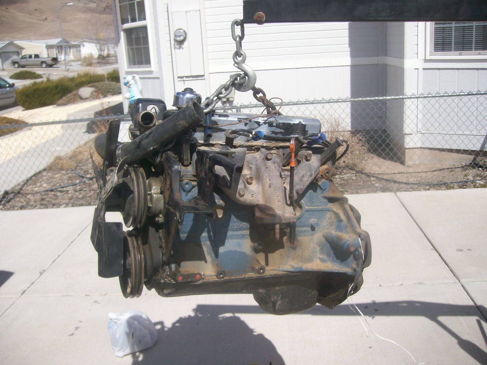

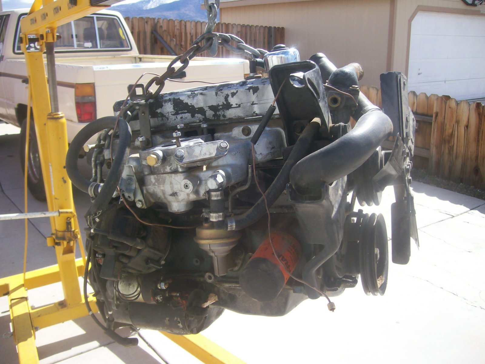

    During these years Jeep used a early version of the GM Iron Duke 151 ci 2.5 liter until Chrysler developed their own 2.5. I'm not sure where OMC, Mercruiser, & Volvo marine engines fit here. As far as I know they were all either 153 or 181 ci. The engines are different but closely related. The key to oil pan interchange is one or two piece rear main seal.
    This is from a 1980 Jeep. Note Chevy bell housing bolt pattern. ****** side is Ford I think.
  10. Maybe for the last time.. NOTHING interchanges between the 153 Chevy and the 2.5 PONTIAC Iron Duke..Not even the orange paint.

  13. Six Ball
    Joined: Oct 8, 2007
    Posts: 6,979
    Six Ball
    from Nevada
    Then google the oil pump, main bearings, timing cover gasket and pan gasket. The crank shafts will interchange between 151, 153, & 181 as long as they are the two piece rear main seal, sometimes with some machine work on the rear hub. That alone leads to other parts swaps. There are lots of versions of the 151- 2.5 Iron Duke they did not all come in Fieros.
  14. Okay..I should have said nothing interchanges without modifications..Yes, some gaskets are the same , as the Duke was built off the same original tooling as the 153.
    The later crank is 3.25 stroke , rather than 3.00...So, even with a similar 5.7 rod length, you would most likely need custom pistons.
    Why not just cut and rotate the sump, and just figure out an optimum pick up set up? We are hot rodders here. right?
    Be that as it may, I probably shouldn't have gone off on you last night. :oops:
    I'm just tired of people calling the 153 Chevy II an Iron Duke , and the ensuing confusion.
    tractorguy, 2OLD2FAST and Six Ball like this.

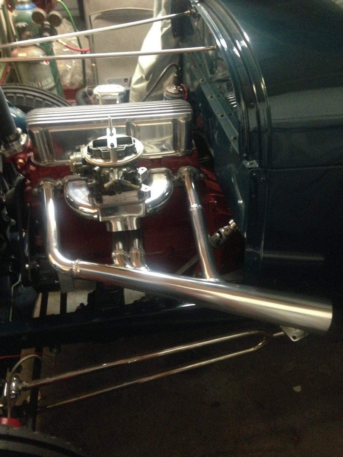

    Does anyone have a carburetor to recommend I run?
    I’ve got a 1963 Chevy II 153 in my Roadster. It’s got a street/performance comp cam.
    The head has enlarged intake/exhaust valves.
    Currently running a Clifford intake manifold with an adapted 2 barrel Weber carb.
    I can instal a 4 barrel. I just don’t want to bury it either.
    oh yeah… I’m also running a 5-speed manual s-10 transmission. And an 8” reared with a 4.10 posi.
    thanks for the help!!

    Good looking engine! Is there a problem with the Weber?

    Thanks! Actually the Weber works pretty good. Just wondering if I could squeeze a little more performance out of this setup.

    If I remember my bugs - I think that's the Pinto carb - small primary and larger secondary (32/36 DCAV??) So you might do a search to see what performance carbs are used as upgrades on the Pinto 2300.

    Are those Webers as tunable as the side drafts? If so you should be able to hone it right in. Anything could be put on your intake. I'm planning on running 2 28 Zeniths. It looks like we have the same rocker & side covers.

    funny… I just got the head back from the machine shop last week. I also installed those same intake lumps from 12bolt Tom. I used your pictures to show the machine shop what I wanted.

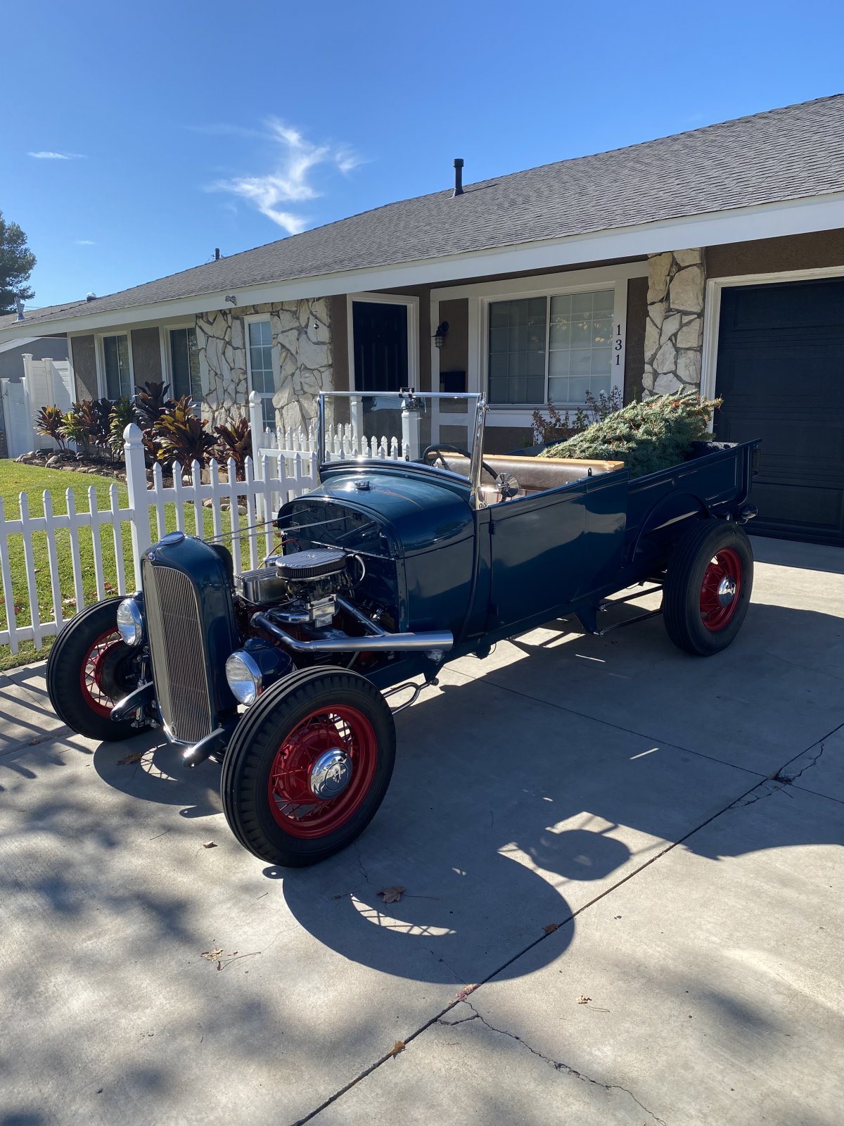

    That is cool! And you are so far ahead of me! How do you like driving your Roadster pickup? How does the engine compare to other hot rods you have driven? inspiration!

    Thanks! I’ve had a few stock Model A’s, and my other Hot Rods have 350 & 348 Chevys. But I gotta say I absolutely love this 153 4-banger!! It’s got a great “antique” sound, but with modern convenience.
    I also have the Mercruiser finned side cover. So most people have no idea what the engine is out of.
