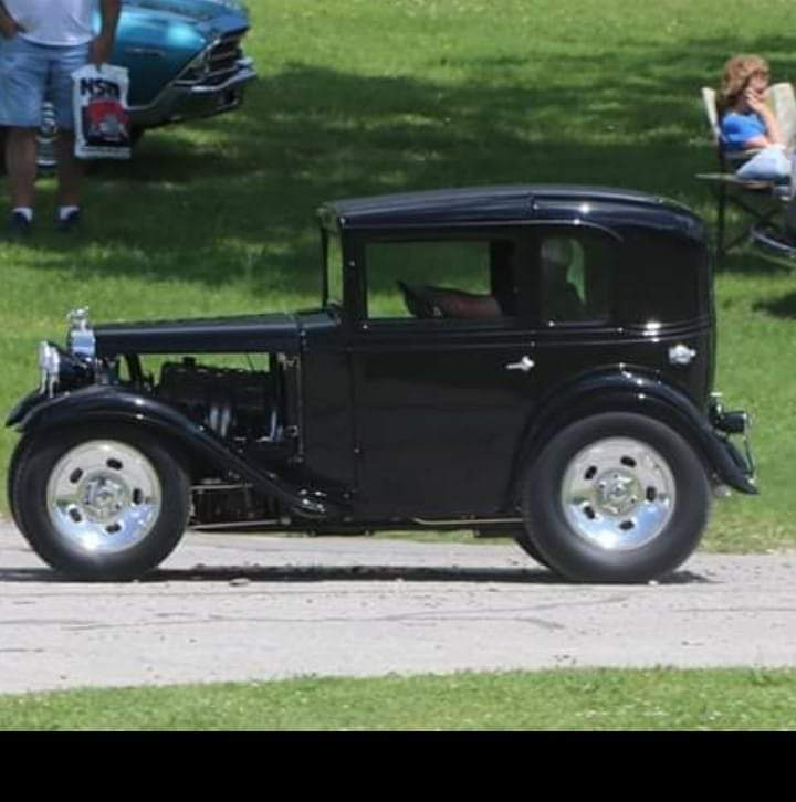

    My 1930 Austin 153, mercruiser head and internals, efi injection, t-10, halibrand quick.... fun LITTLE car... haha

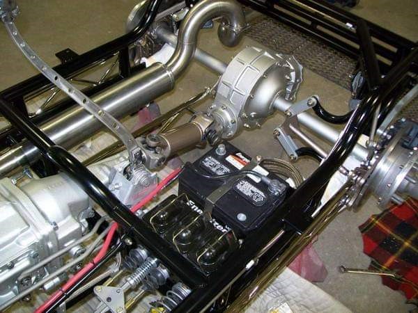

    Wow, that is probably the shortest driveshaft I have ever seen. Kool car.

    Any more pictures of it? Bet it was a blast to drive!

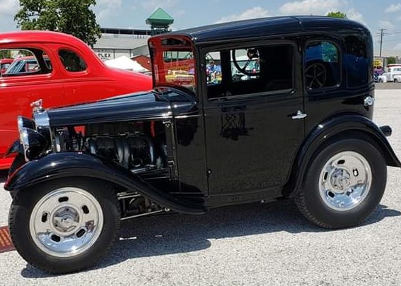

    Found another... I'm 6' 210lbs... it's not a terrible fit... about like riding in my buddy's chopped 32 5 window ...

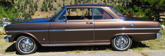

    His dad got him a brown color, two door 1962 Chevy 2 Nova. The styling had the factory lowered look. With the open hardtop and windows down, it was a perfect cruising sedan. When we all got inside, the Chevy 2 actually was illegal as far as the CHP was concerned. 4-5 big teenagers made the whole car so much lower than stock. We had to go slowly over driveway entrances and exits all of the time.
    upload_2022-2-7_4-25-22.png similar in color and looks

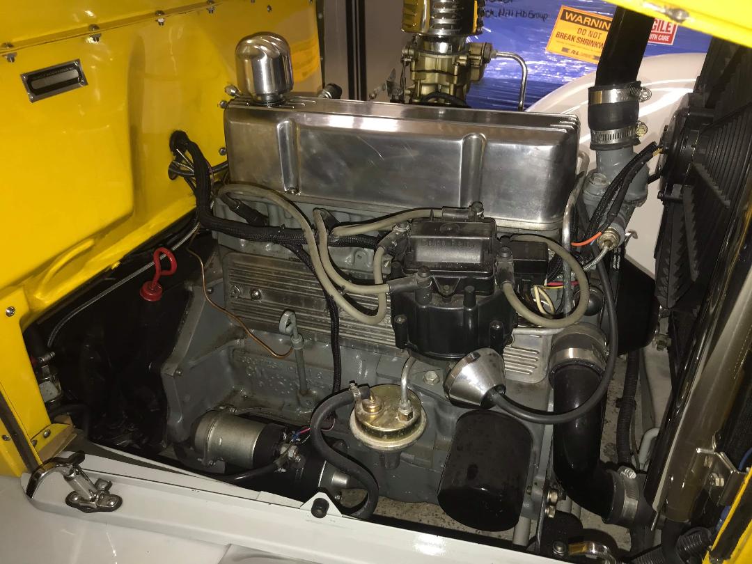

    Hotdodbob, What block do you have? The dipstick is further to the rear than mine? Is it a 153 or 181?

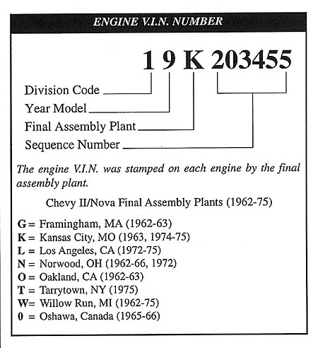

  27. hotrodbob
    Joined: May 7, 2002
    Posts: 521
    hotrodbob
    Casting number is: 3987746 this I have found as a 1968 casting. Stamped in numbers are: 19w467646 and V04I2AJ. I'm guessing the number breaks down as: 1= GM/Chevrolet, 9=1969, W = Willow Run Plant car ***embly. 467646 Original Vehicle serial/sequence number. The V in the second number seems to mean Flint engine plant. April build date, but the rest does not match anything.
