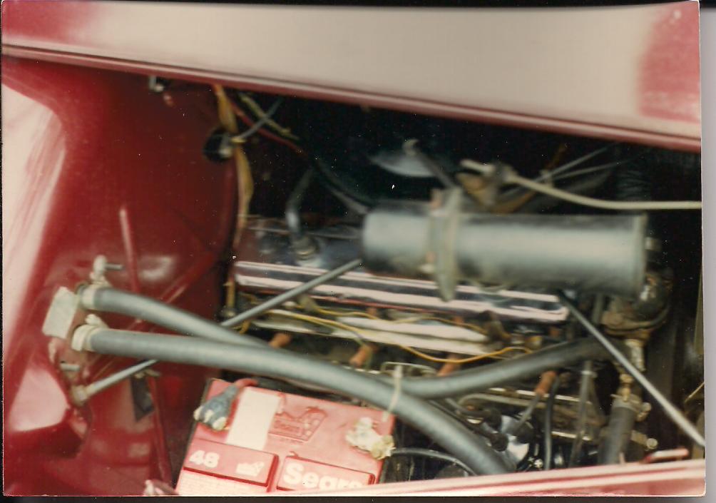

    Had this 153" Nova motor and air cooled powerglide in my 36 Willys sedan. Drove the **** out of it and was very happy with it. Sold it around 1979 and saw it again in the street rod nats around 88 in Columbus. Guy that now owned it loved it.

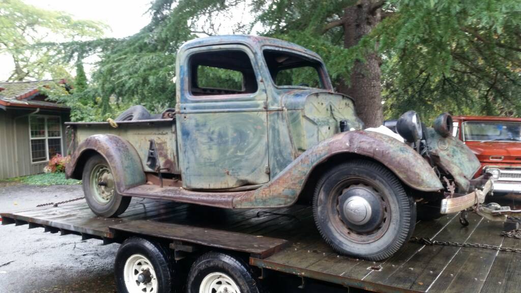

  28. jt1949
    Joined: Apr 13, 2009
    Posts: 185
    jt1949
    1936 pickup, 153 chevy, s10 5sp s10 2wd rearend
  29. jt1949
    Posts: 185
    jt1949
    525 saginaw box
