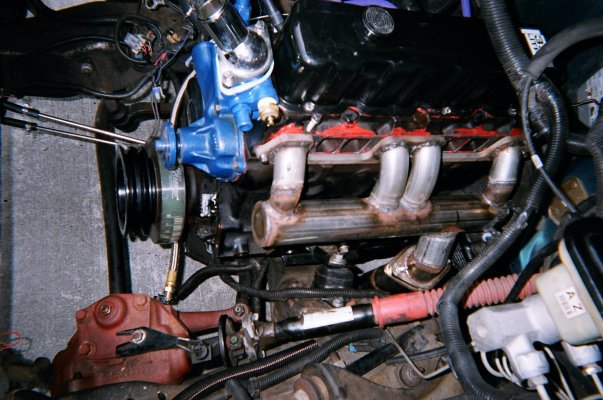

    Hello Everyone. My subject is the Chevy 153. I am new here and and not sure where to post, so I am taking a shot in the dark. Like Everyone here, I am a fan of the old cl***ics, I just don't have one yet. I do have a humdinger of a ride, probably unorthodox for this site but I need some help. Here goes: I happened upon a 87 or 88 3.0 Mercruiser and a 1962 Chevy 153 head. Removed Mercruiser head and marine stuff and donated to a muffler shop's s**** steel bin. Had machine shop go completely through 153 head, doing it all. After spending a few hundred bucks there, I bolted and torqued head on after doing a careful gasket search and left it alone for a while. Got a Clifford 153 intake later. Had a custom header made but it was more for the Mercruiser head. Very ill fitting, ports do not completely line up. Stainless flange, mild steel tubes, stainless exhaust tubing horizontal collector and stainless exhaust pipe connector flange at the bottom, all Jet Hot coated. -What a waste of money! Probably have $1,000 in that damn thing. It was put together one piece at a time over 2 years. A weld and grind here, a buff and coat there. I have a Weber carb on it and a Fluidampr balancer for a Chevy 250 six. Balancer neck was trimmed to fit the 153. Engine sounds great! Guess what it's in? A 96 S-10 ext. cab. 700R4 ****** is behind engine. I plan to post pics shortly. Ripped out computer and all wiring. Went back with a Painless wiring harness and I am imposing old school on this truck. The truck was an ebay find with a blown 2.2 and a new ******. I bartered the ****** for the shop to remove engine, ******, gas tank and rear end gear. Engine mounts were fabbed and a custom oil pan made. Everything else was cash and ouch! OK, so here is where I need the help..... I have seen some pics here of stainless intakes and exhaust made for the 153. Can someone here do that for Me and how much? I am not a rich man, especially after this 9 year project. In addition to paying a reasonable labor fee, I will throw in my ill fitting exhaust header free. It looks nice and may work for another application. The truck will be an oddball at car shows but will also be my daily driver. My new rear end gear is 3:73. I am hoping for a little power and great fuel economy. It will be my highway truck or "Efficiency Rod". Have no idea how it will actually turn out. Any stainless exhaust fabbers out there?

    Pics of the Frankenstein header were taken before the Jet Hot coating. Header looks far better now.

    Thank you, Sixball. I was about to buy but also found a non turbo repro, cast iron header. I am really wanting stainless but I can get this and do stainless later. Your note on flanges will be taken into serious consideration. When designing my header, I bought a 153 flange from them 10 years ago and bought a piece of 300 series stainless plate. The flange was used as a template and an exacting copy was water jet cut from plate. Strangely, the ports on my present header are quite off the ports of the old Mercruiser head and the replacement Chevy 153 head. The header bolts on but holes don't quite line up, causing serious restriction. I think that the header You suggested will do the trick.
