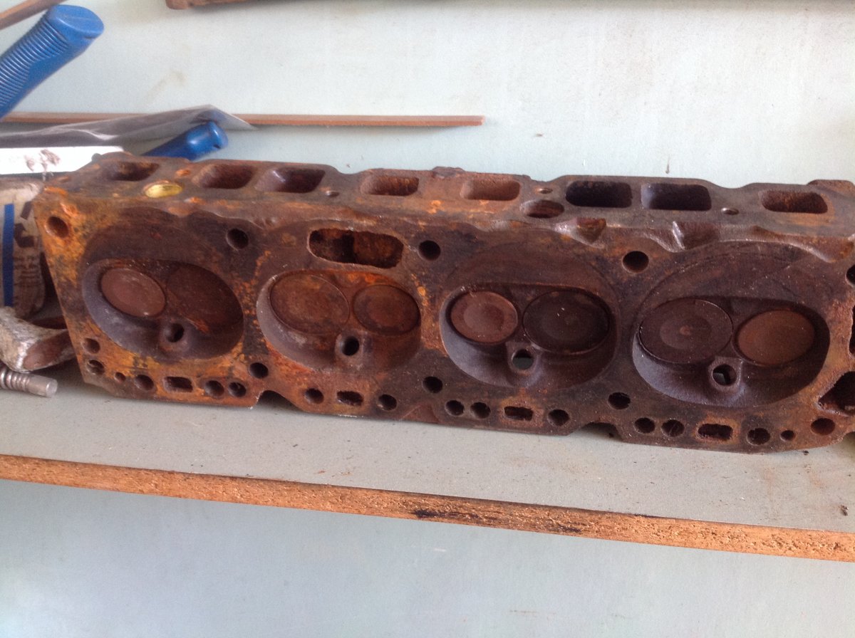

    Received my Mercruiser head from Charlie Stephens after its big trip to Australia,,I will use all the gear from my old head that has an extra combustion chamber on No 2 ,,,new head looks mint,,very happy with it ,,thanks Charlie ,,,engine going in my sons 28 coupe,, image.jpeg image.jpeg

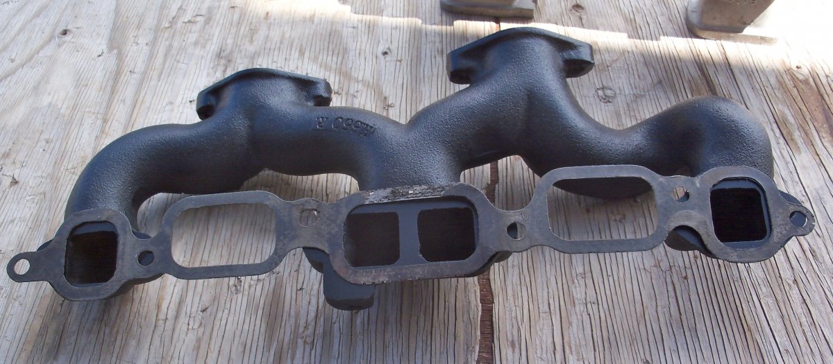

  16. RoddyB34
    Joined: Oct 13, 2009
    Posts: 542
    RoddyB34
    With Mercruiser 8 port heads there appears to be 3 different port styles that I have seen so far ,I will be fabricating intake and exhaust manifolds ,,thanks again to Charlie Stephens for my cylinder head ,,,still like to see any pics of manifolds to suit though ,,,

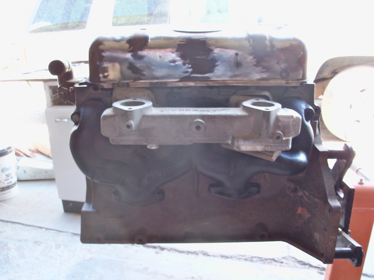

  25. Six Ball
    Joined: Oct 8, 2007
    Posts: 7,243
    Six Ball
    from Nevada
    Hey, That's my manifold and head. o_O So, yes on the 5 port heads the spacing is the same as the 6. I cut the back off of an Offenhauser 3X1 and will run 2 Zeniths. The exhaust spacing is the same as a small block but the 4 cylinder ports are larger. I'm working on adapting a Fenton Black Widow header. You can also cut down a set of six header flanges to build headers or even cut up a set of six headers. But this won't work on the 8 port heads.
    BigDTexasKid and RoddyB34 like this.
  26. Six Ball
    Joined: Oct 8, 2007
    Posts: 7,243
    Six Ball
    from Nevada
    I looked back in this thread and see that my pictures went away whenGoogle screwed up Picasa. Here three about this.
