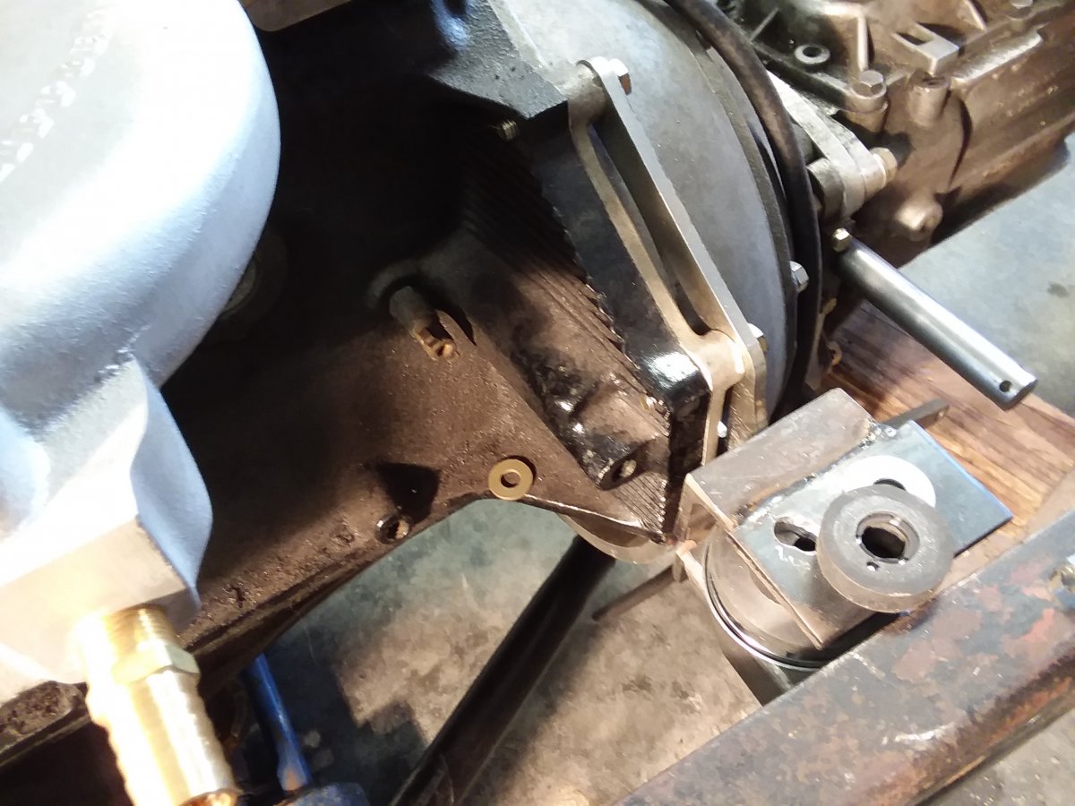

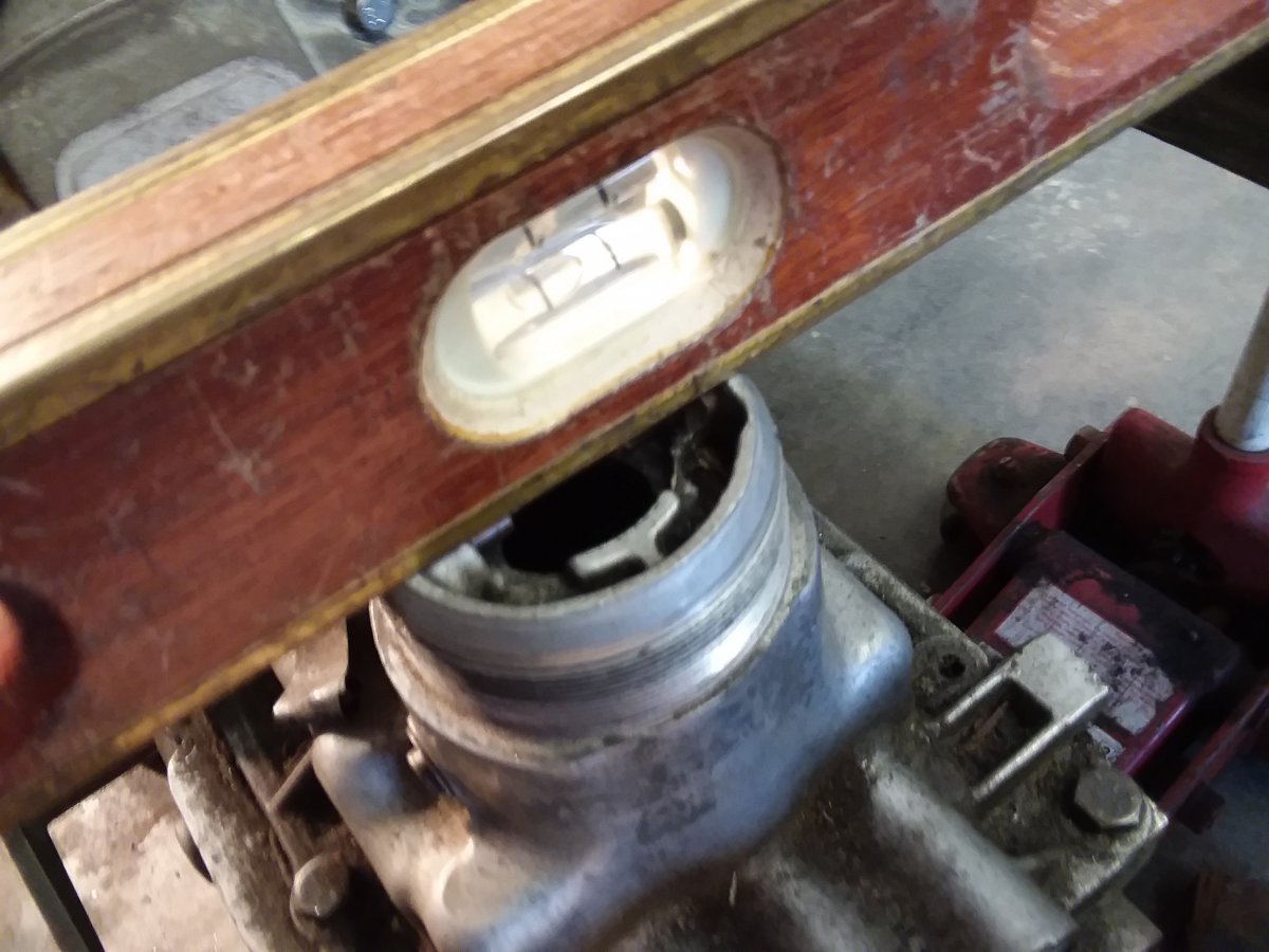

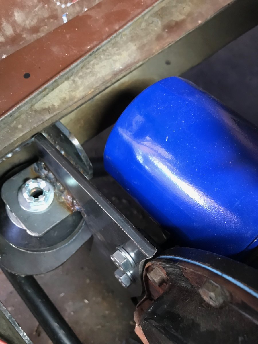

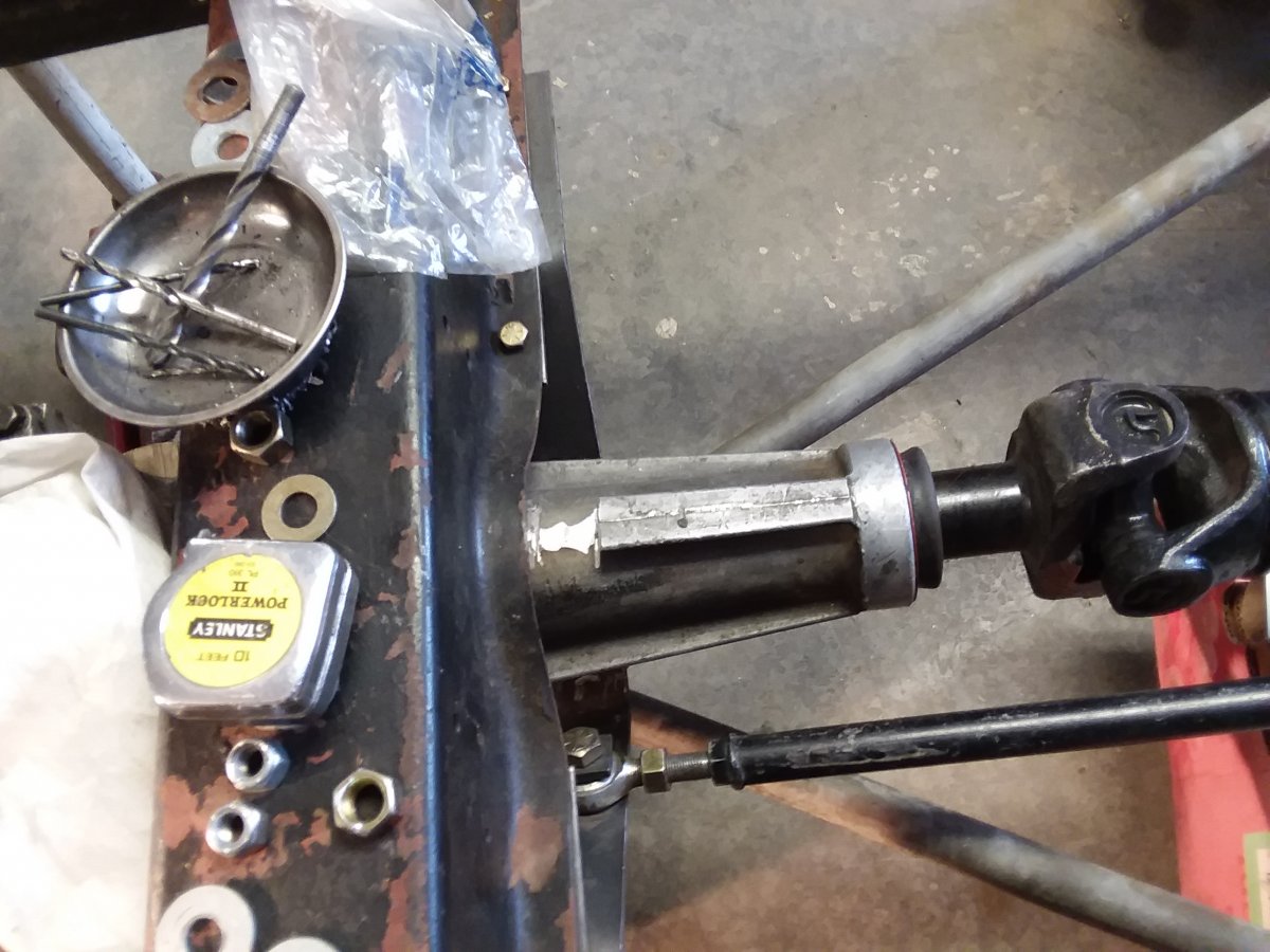

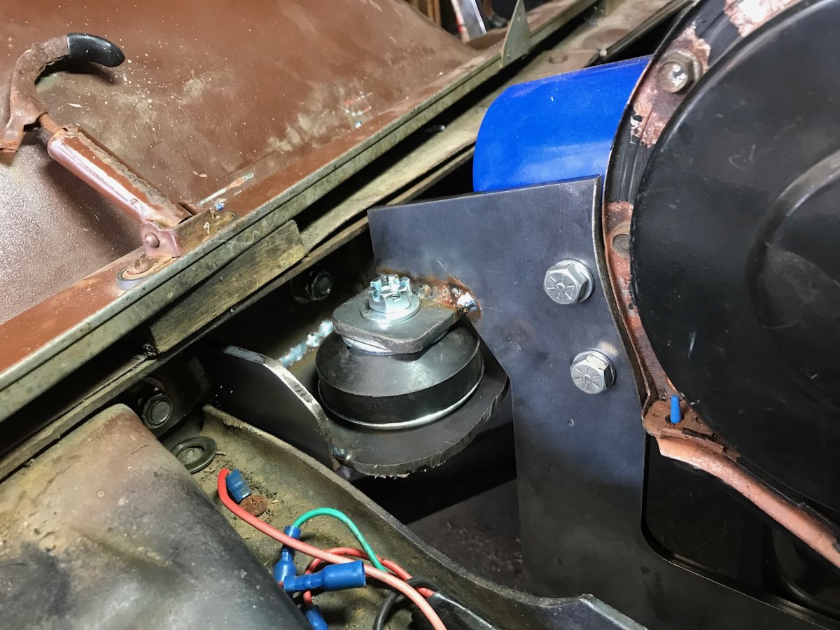

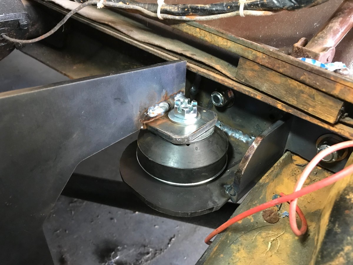

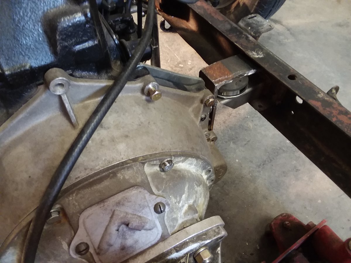

  1. chiliman sent me an email and said "did a little adjustingnow it is all level". Here are the pictures of his set up that he sent me.

    Thanks for posting those. My mounts are still in the plan stage and everyone's solutions are interesting. These are compact little engines and have the GM inline disadvantage of having a whole lot of stuff on the left side in the clutch, brake, steering, exhaust, shift linkage, intake heat, oil pressure port, and motor mount area.
  3. For what it is worth when I put mine together I had been advised to incorporate the original Chevy mounts to allow the engine to vibrate and avoid cracking the brackets. That is why they look like they do in Post #364.

  4. Six Ball
    Joined: Oct 8, 2007
    Posts: 7,243
    Six Ball
    from Nevada
    Mine is going in a '26 Chevy frame with parallel leaf springs. The trans is a T-86 BW with OD. It will be converted to top shift. The adapter is a stock small block power glide adapter to an old aftermarket aluminum adapter for a Studebaker. I like 3 point mounts so I'll use two in front and one on the tail of the trans. They will be rubber mounted partly because these engines have vibration issues. Top shift and one rear mount help with the crowding on left rear of engine. I guess swinging pedals would help but I don't want them. Actually looking at a bell housing pedal mount as used on the original Chevy 171 4 cylinder. There is a distant plan of being able to swap in a hot 171 for special events.
  5. DDDenny
    Posts: 23,425
    Many years back I went to NAPA to get motor mounts for a 69 Nova 4 cylinder car and was told they were no longer available, ended up adapting another OEM mount, worked great.
    I think if those biscuit style mounts are used it could limit the flexibility needed and like was stated the brackets will have to be heavier to deter breakage.
    Also, it may be wise to put a doubler plate at those locations on the frame if using the biscuit mounts to keep from cracking the frame rails.

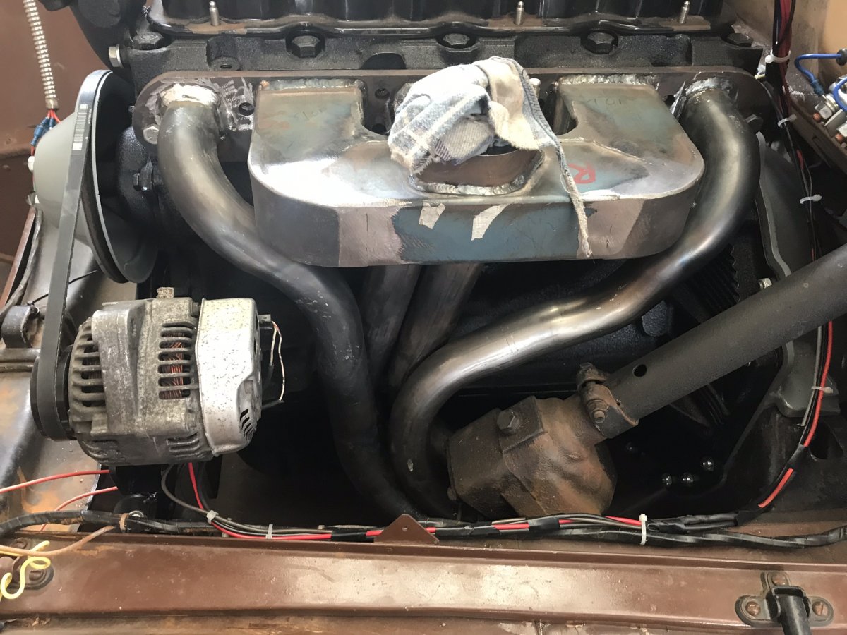

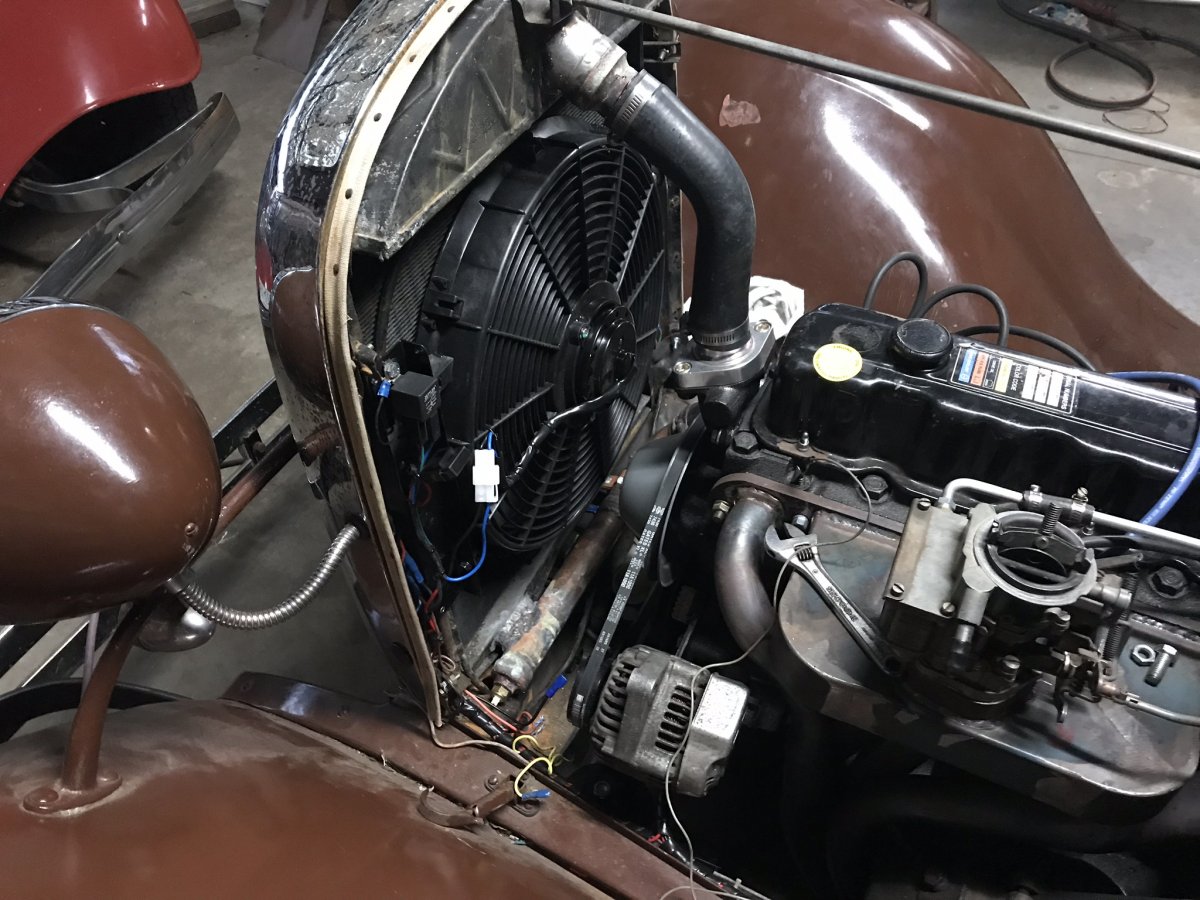

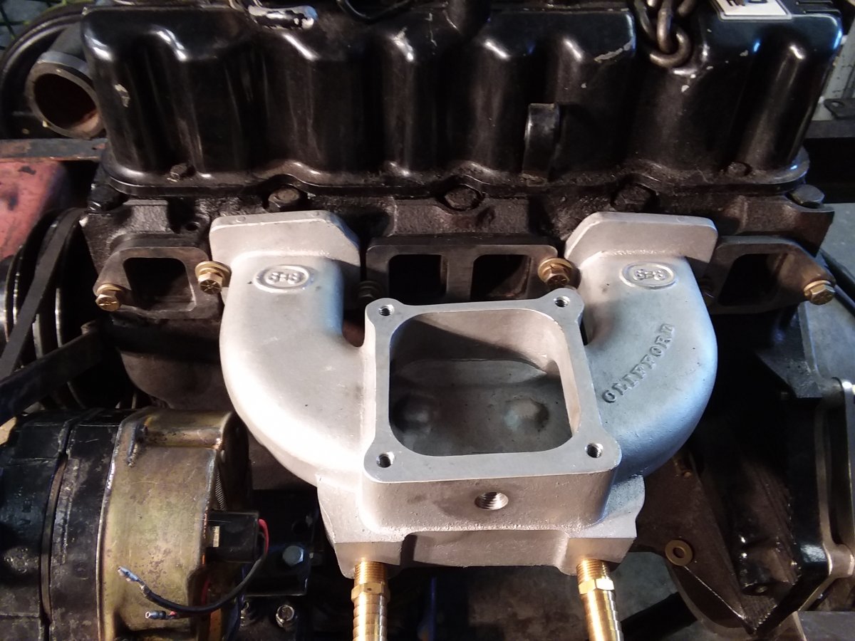

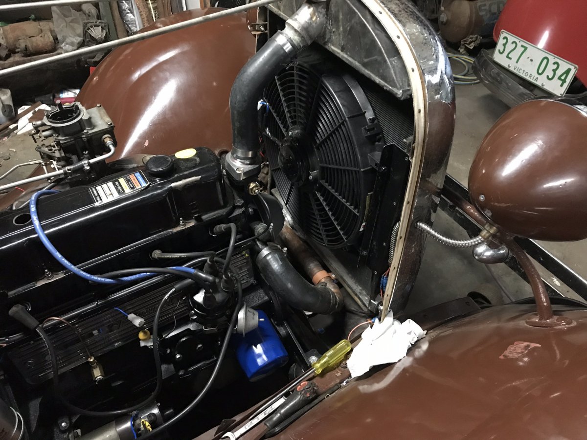

    43CEDE35-3D62-4349-9061-F3EB74C4417D.jpeg C222C896-80C4-4538-9BD6-8FDFAAA90B98.jpeg 031A5525-6048-45DC-9DBC-A52A60756907.jpeg 351D70DF-FE20-46E4-9218-D3EA60A8D299.jpeg Getting along with our conversion,,with the manifolds finished we were able to fire it up to run the cam in ,,as the radiator was ok I needed the bottom outlet changed to the other side,,the local radiator shops weren’t keen to reverse the tank so as a plumber I got to thinking I could solve the problem with a cross pipe ,,works a treat ,,a bit more tidying up in the engine bay and we can put the bonnet (hood) on ,,starts on the key and push ****on,charges the battery, thermos fan cycles on and off ,the diff is the next job and the brake lines ,,won’t be long now,,
    Tim, 29EHV8, flyin-t and 1 other person like this.

    I am glad to see that you put a small piece of rubber line in your fuel line at the carburator, because the engine vibration can cause a flailed line to crack if mounted solid to the firewall. That's a good looking A.
