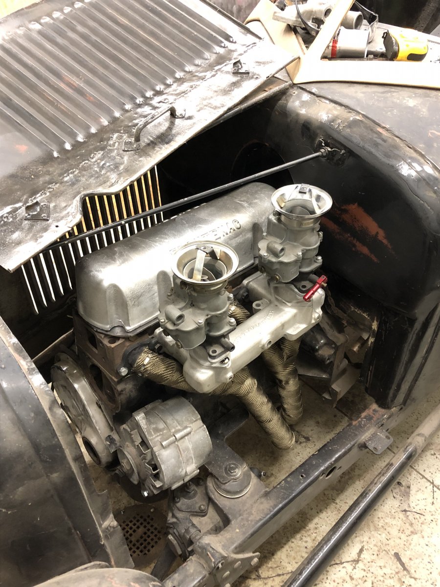

    Hoping to have my T with the 153 on the road by spring. Lump ported head, dual 97s, Frontenac cover with and adapter, Isky cam, flat top pistons. Mated to a T50 5 speed should be a fun little car. Only question I still have is what are people doing for distributors? I have one with a vacuum advance and several Mercruisers AF92FD0B-1D2B-4085-90E7-A704E4DB9E17.jpeg without.

    Looks like you took my 3X1 Offey intake mod to the next level with 2X2 instead of my 2X1. Looks great! A Harper approach to a part of 97s on one of these engines would be fun to try.
