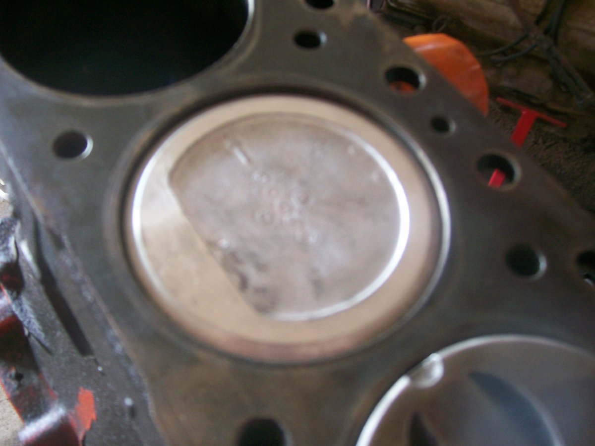

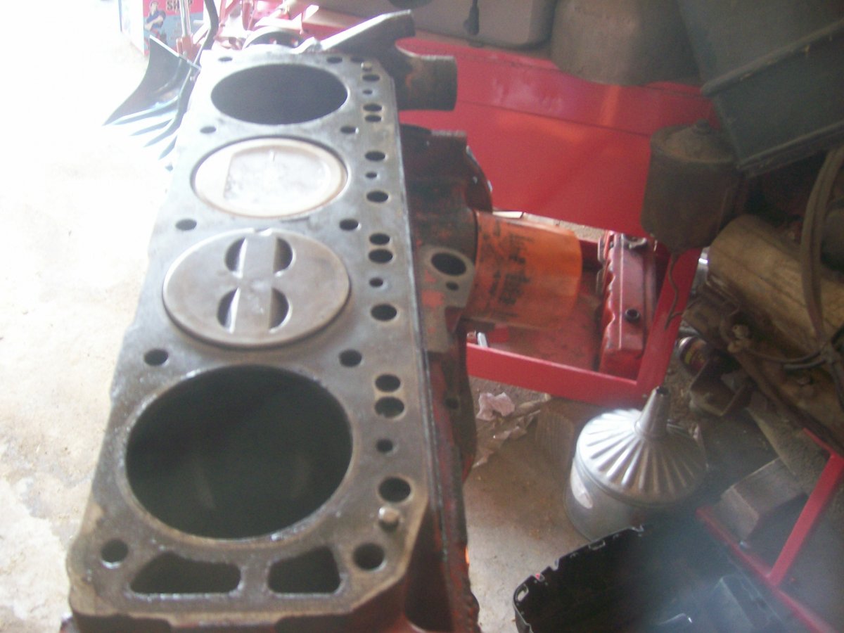

    This is a 250 six piston in my 153 with 181 crank.

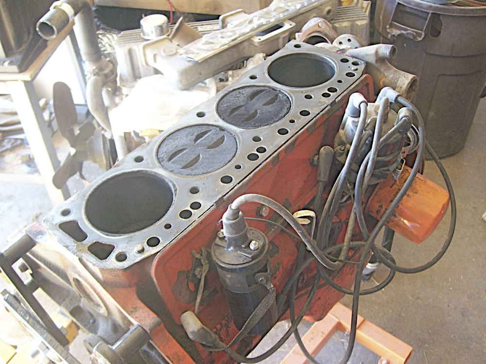

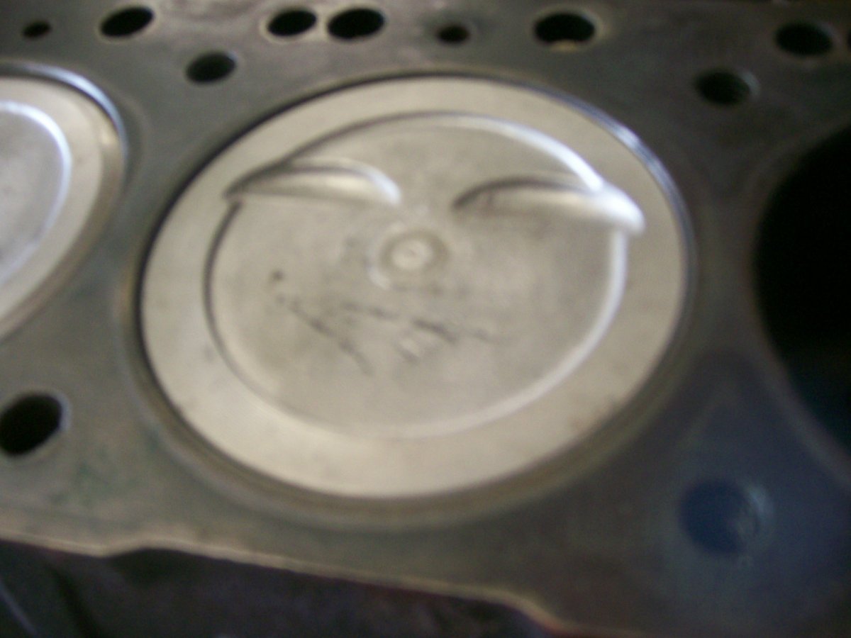

    This is a 307 piston in the same engine the only ones I've see with two cuts. Both would work fine by decking the block a bit.
    Here is the Ross forged flat top for the 250 sold by 12 Bolt Tom. I'll run these they stick slightly out the top but will be fitted to zero deck.

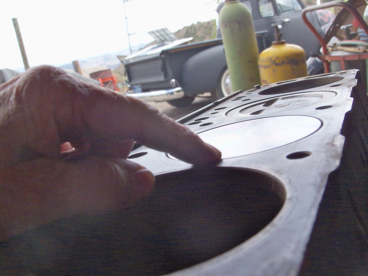

    Here is what was in my 153 when I got it. .050 down the hole with 153 crank.
    Here is one of the original ones on the 181 crank.
    I don't know what any of this means about what will work in a stock stroke 153. I know I had the deck height number when I was working on this. Got boxes of pistons but a few more blocks to fill. :rolleyes:
    29EHV8 likes this.
