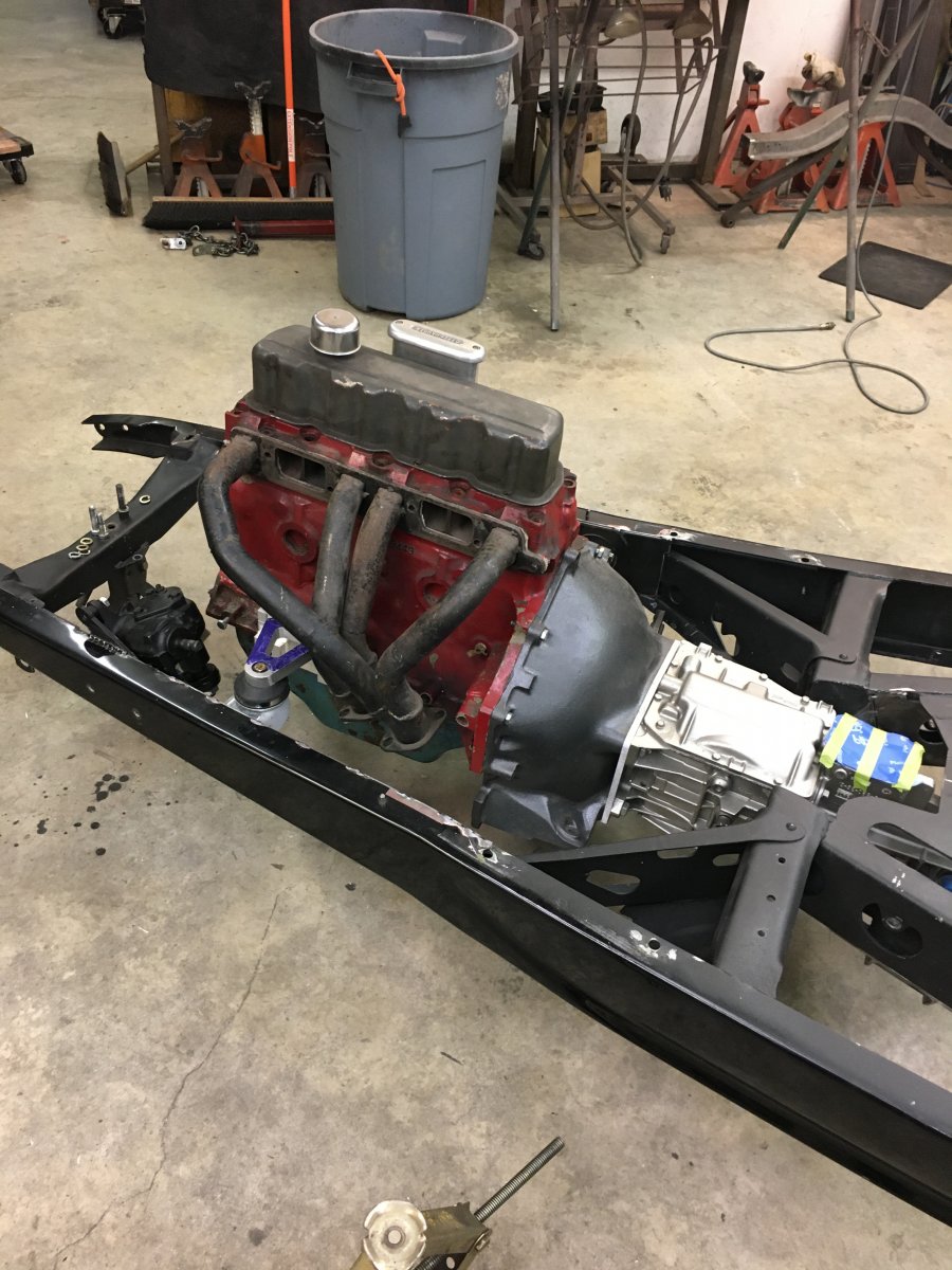

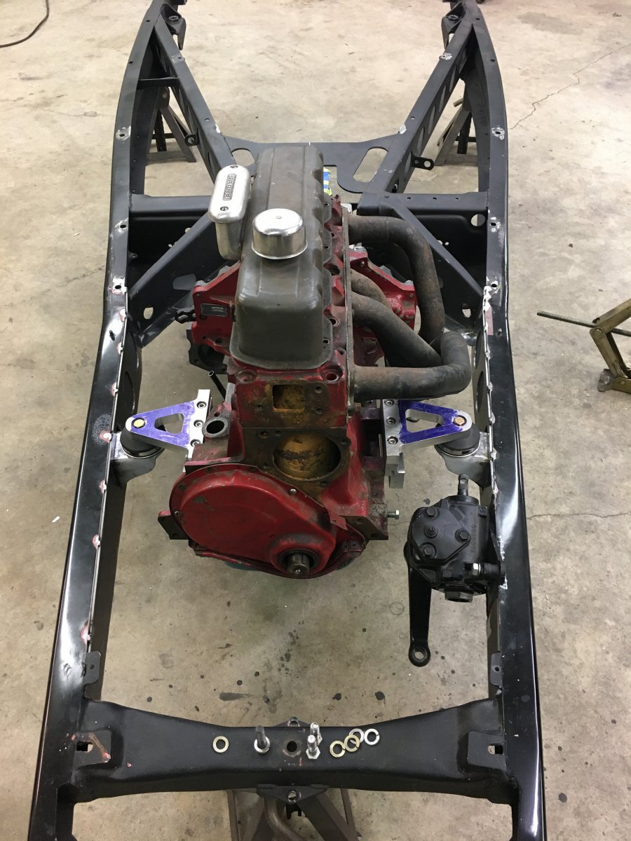

    My plans are coming together with all you guy's help. I'm waiting on delivery of a 181 block so the "real" engine can go together. In the meantime, since I have a 153, I'm using it for mock-up. Plans call for a quality rebuild using flat top Sealed Power pistons, Isky hyd cam, balanced, aluminum cam gear. I have a 181 marine head that has been ported, modified for screw-in studs, stock 1.94/1.60 valves, hardened seats etc.. I may not use the valve cover in the pics but go with a 140 mercruiser aluminum valve cover and side cover. The header is one that came with the 153 and will need some small amount of redo for steering shaft clearance. Vac advance chevy distributor with electronic module. Haven't fully decided on what I'm going to do with carb but am considering modifying a stock ChevyII intake to accept a 325 Holley 2 barrel. I already have a couple of 'transition' plates to allow me to mate this manifold to the 8 port head. The manifold itself will take some modification to the carb mount and I'll need to do an adapter that matches the carb base. All this will run thru a S-10 5 speed to a quick-change reared.

    It’s a roadster on 32 rails. The difference is in the wheelbase between Model A and 32

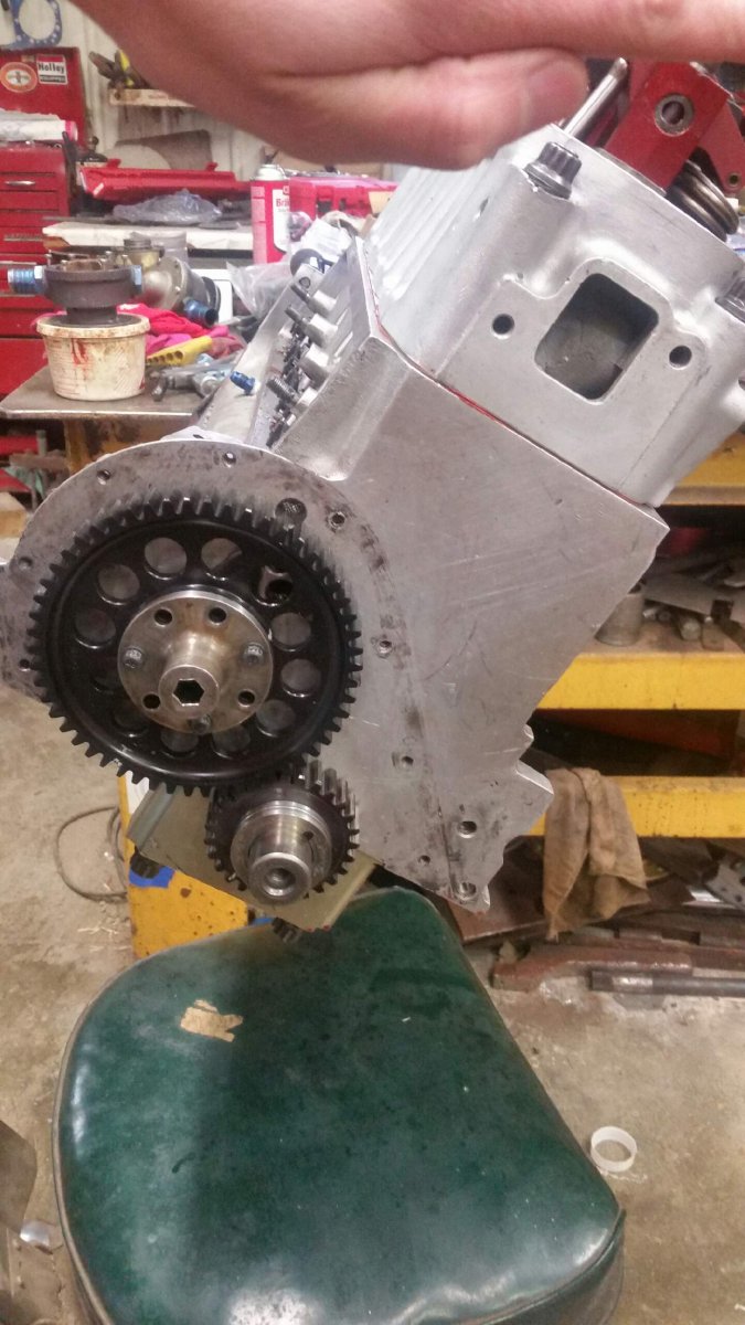

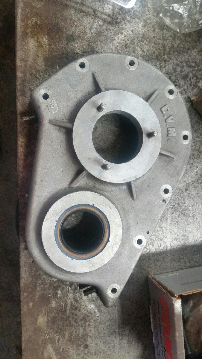

    Long and winding thread, but lots of great information. I'm building a Chevy II to go midget racing indoors. Fontana head, Arias block, (also have a Ford Motorsport block and Fontana head to build #2, it was blown up much worse than Arias block). Starting to run into issues for water pump options, atleast cam driven water pumps, have parts for a EVM marine pump, making new parts will likely get expensive for vintage pump.
    Do any of you guys have cam driven pump setups that could help me? (3 stage dry sump oil pump will be belt driven)

    I have quite a few of the 181 marine engines and blocks that were used in midgets. I also have a couple of vintage midgets with those engines.
    I guess the front of your block is the same as the Mercury? Do you have a after market front cover that will accept a cam driven water pump?
    THANX RICH
  19. Tony Main
    Joined: Sep 29, 2016
    Posts: 6
    Tony Main
    Yes I have (EVM)front covers that would accept cam driven fuel/water pumps. I will probably end up using a KSE water pump (will have to modify and find a straight vane impeller for the reverse rotation), spending 400+ on making one off parts for an old pump doesn't sound smart in long run as the KSE would be common. (We run them on our sprint cars without issue for years)
    I believe the front of the block is based on the 153, but I haven't seen a 181 up close to compare. I can try and take some photos when I'm in the shop this weekend.

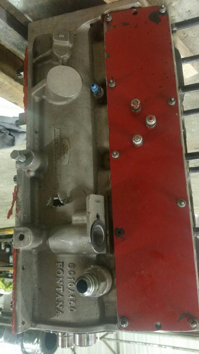

    Thought these photos may be interesting to you guys, the Ford block is very similar to the Arais the lifter cover plate being the biggest difference I've found. It kind of went boom in it's last life, we'll rebuild it some day.

    My 181 (not pictured) is about ready for final ***embly. Machining, trial fit of new pistons, cam to check valve clearances etc. accomplished. Next is to send out the rotating bits for balance. Except for final grinding etc. I’ve finished my intake manifold and the modifications to my header. I needed clearance for both steering shaft and alternator. The show goes on.

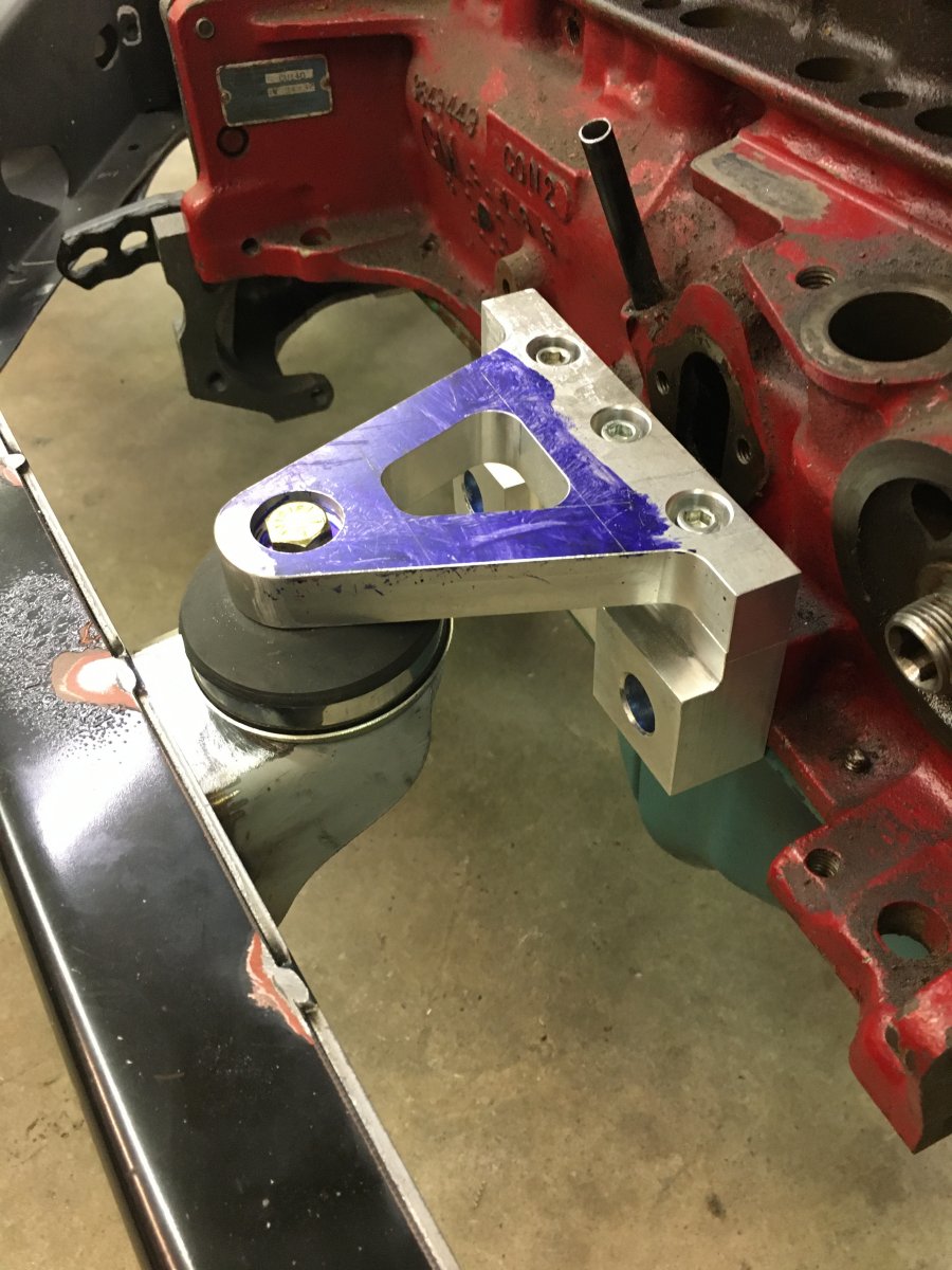

    Little more progress on mine. Next steps finish oil pump bracket, and plumb. Then get the race car ready.
