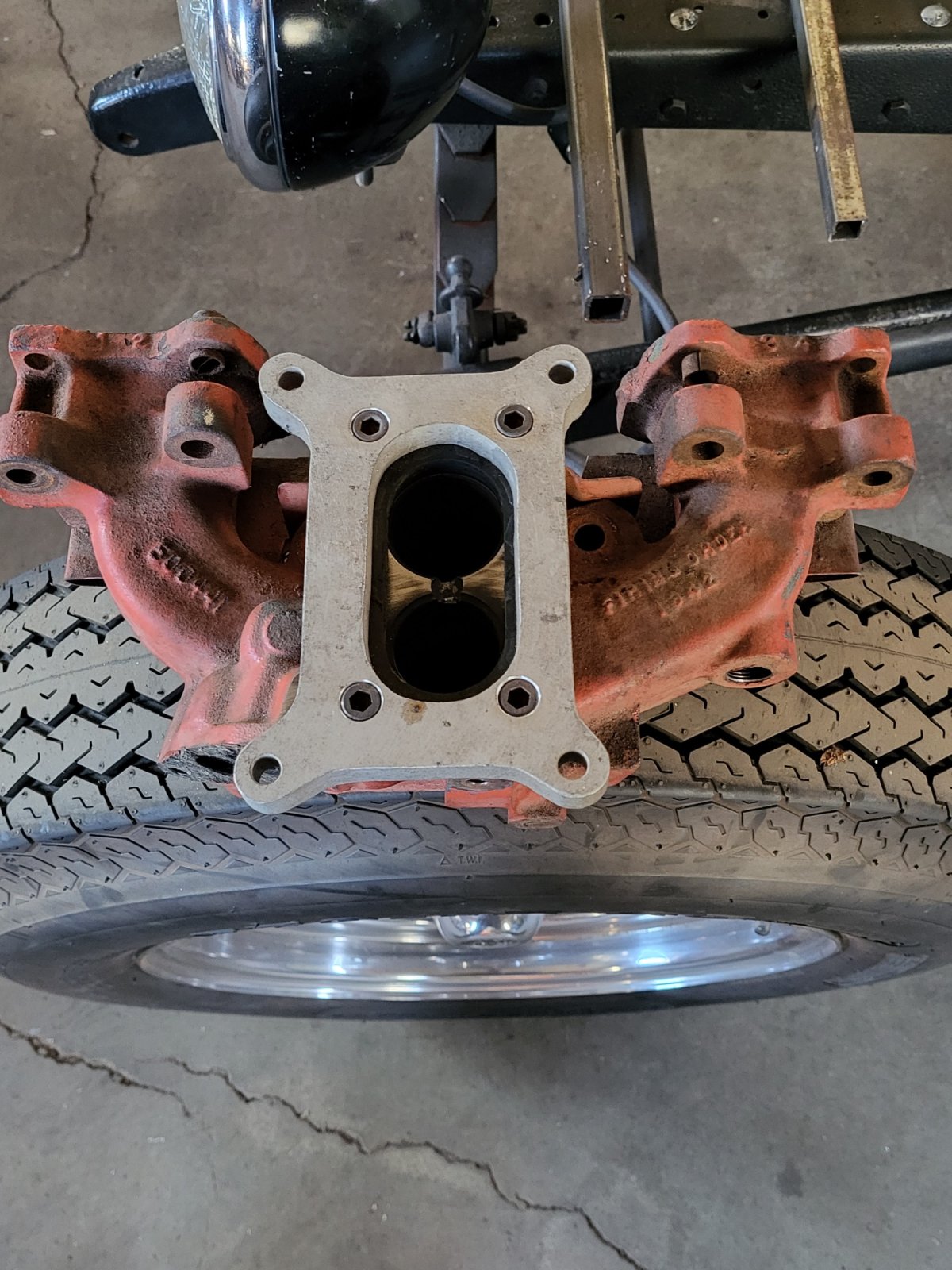

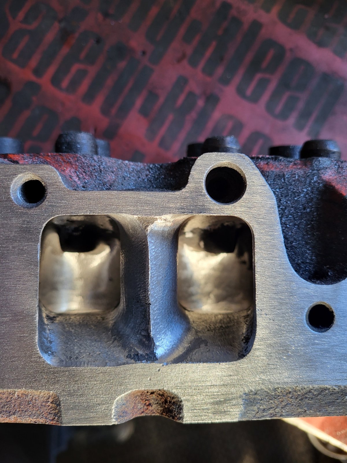

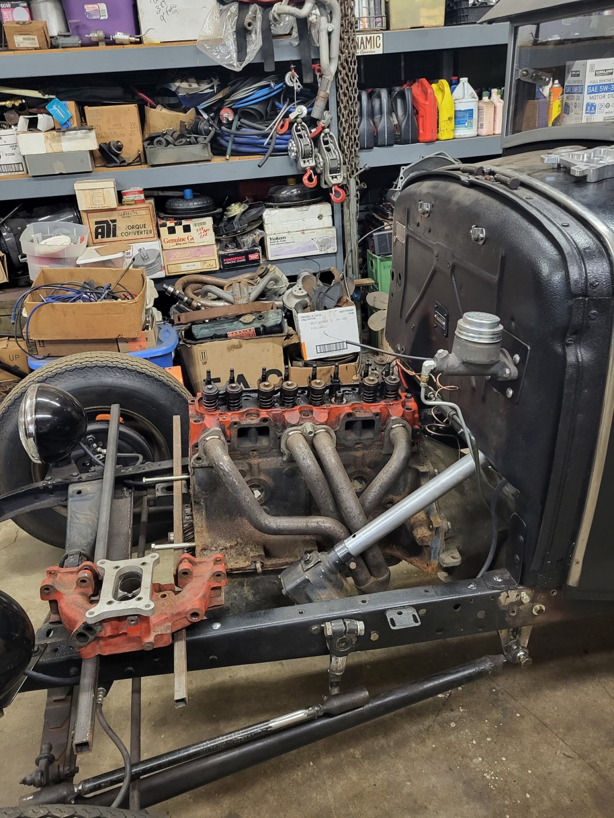

    I took some time off from shop cleaning when I uncovered my 153. I had a couple of things to check on. #1. Would my plan for using the stock fuel pump port for my oil filler & breather/draft tube work? It will with some fitting. #2 Will I be able to use the stock Chevy II dip stick location with my rear sump pan? No I can not. :( I have a fixture for mounting a dipstick on the pan but don't know if there is room on the right behind the starter or on the left tangled in with the exhaust.
    I think my pan may be from a Mail Jeep. Does anyone with a rear simp pan have a solution? I could mount the fixture on the side of the block if I can clear the cam.

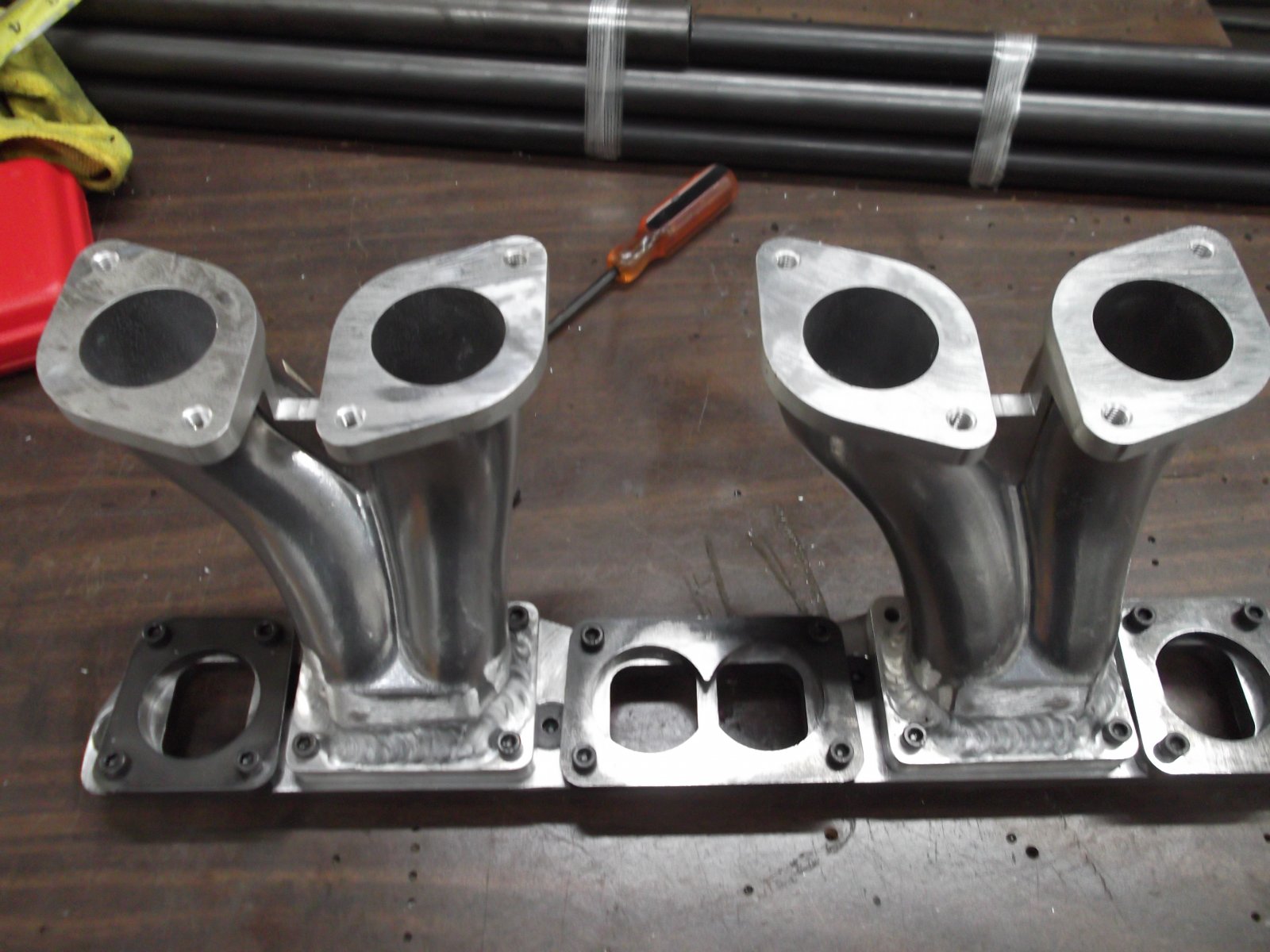

    Building one for a nostalgia dragster right now.

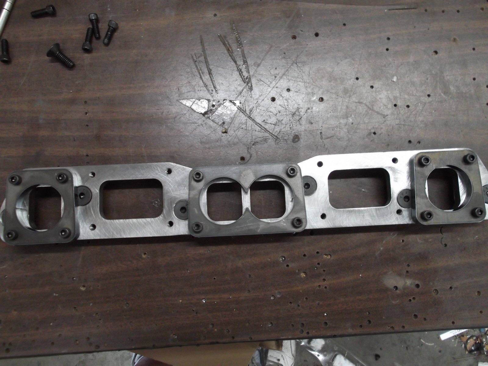

    for my build, I made a 6bolt adapter plate to bolt to the head so that I could separate the exhaust flanges and the intake flanges. The intake flanges are aluminum so that I could weld VW-Webber intake manifolds as the runners upload_2022-9-3_9-2-50.jpeg
    Shadow Creek, OFT, 38 Hump and 3 others like this.
  5. dreracecar
    Joined: Aug 27, 2009
    Posts: 3,476
    dreracecar
    from so-cal
    with intake runners

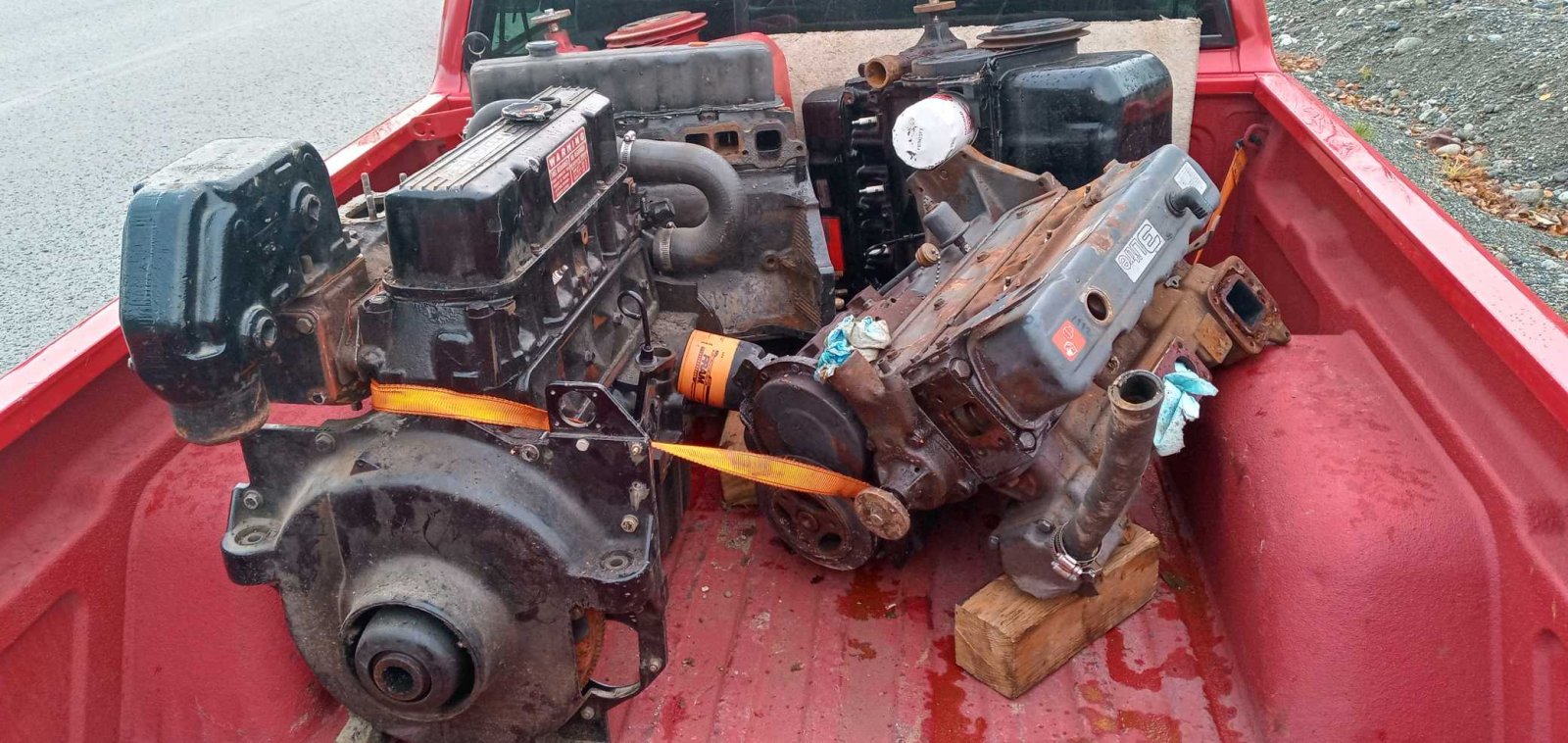

    I picked up 5 3.0's today for 100 bucks. I could of got another one but felt I had my little S10 truck overloaded as it was. 3 are Mercruiser, 1 Volvo and 1 OMC. two of them are stuck and two are one piece rear seals. I liked dreracecar intake and I have a VW weber intake, so I needed to get a 3.0 but settled for a truck load! I have the 3.7 engines so will play with these to. 10-5-22.jpg unloaded.jpg

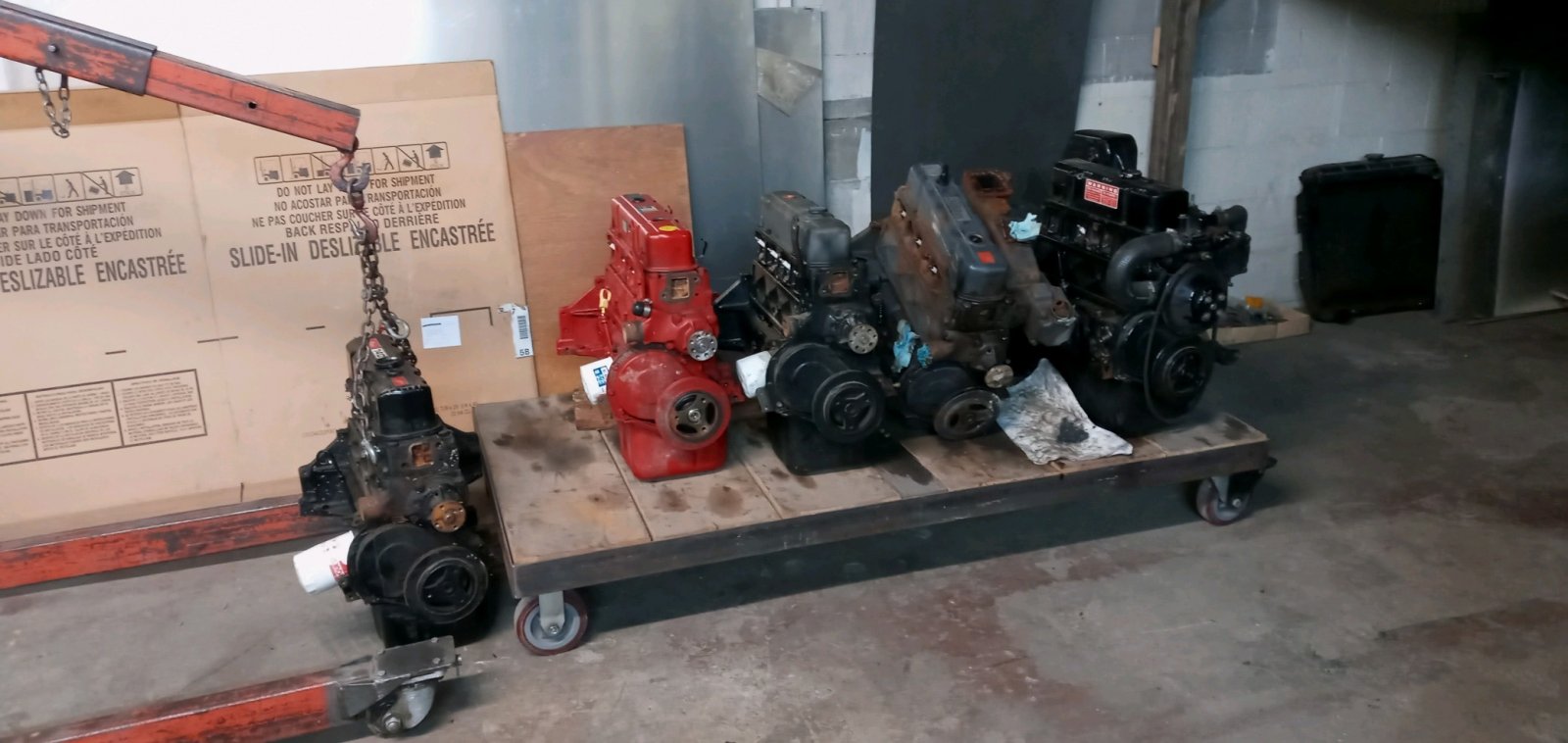

  10. Flatrod17
    Joined: Apr 25, 2017
    Posts: 744
    Flatrod17
    It was a 100 mile round trip to get them, driving along thoughts of 4 of them behind the cab of my coe..... naa, that would look stupid.... but maybe not!

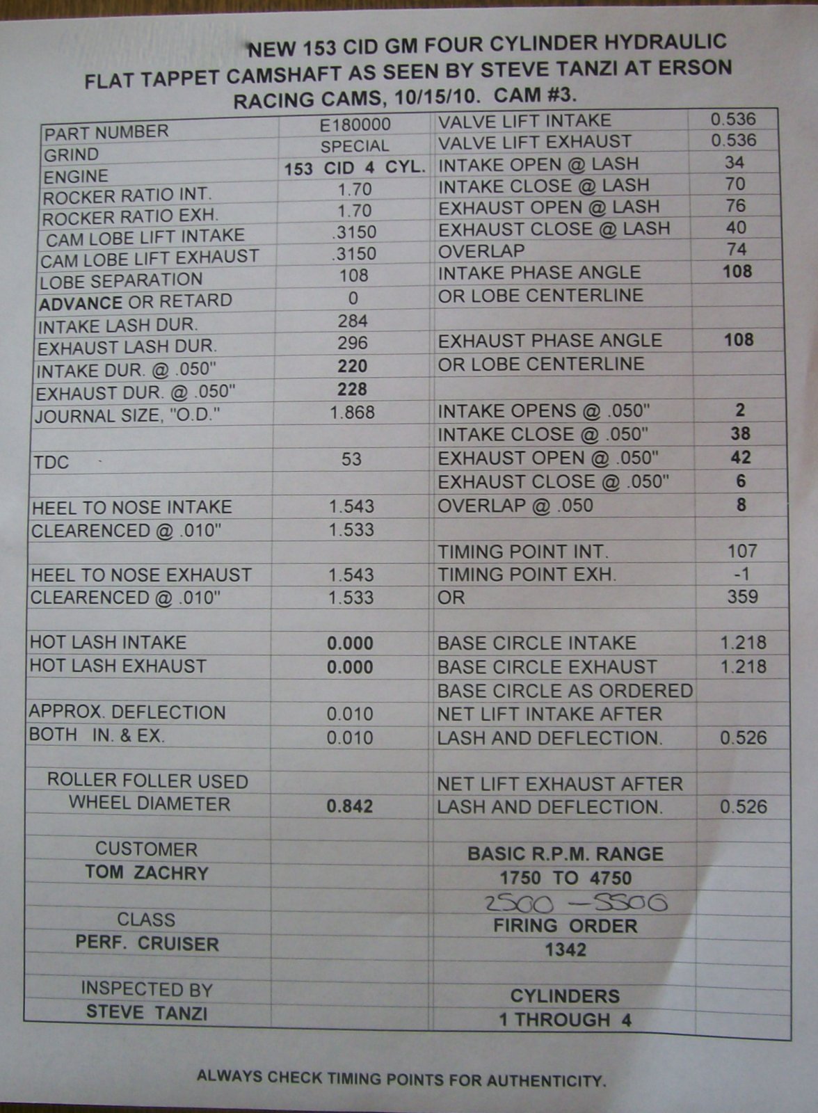

    I think there are at least 3 181 heads & two have 8 ports. One of these is better but the both have the potential to be better than siamesed intake heads. That said I don't know how much better or if it matters for a street driven car. Individual ports would be an advantage for tuned port injection. Anything that can be done to the siamesed six cylinder heads can be done to the four.
    When I sat down with Steve Tanzy at Erson Cams before they moved back East he came up with 3 profiles for my roadster. I cost the hottest of the 3 which may not have been the best choice for my REAL world use. I had the BBC 1.70 roller rockers so he used that ratio for the cams. I now have a set to the proper 1.75 roller rockers. Lucky for me when the cam came the card gives the 1.75 specs. Here are both sheets tom compare. I don't think it will matter a lot.

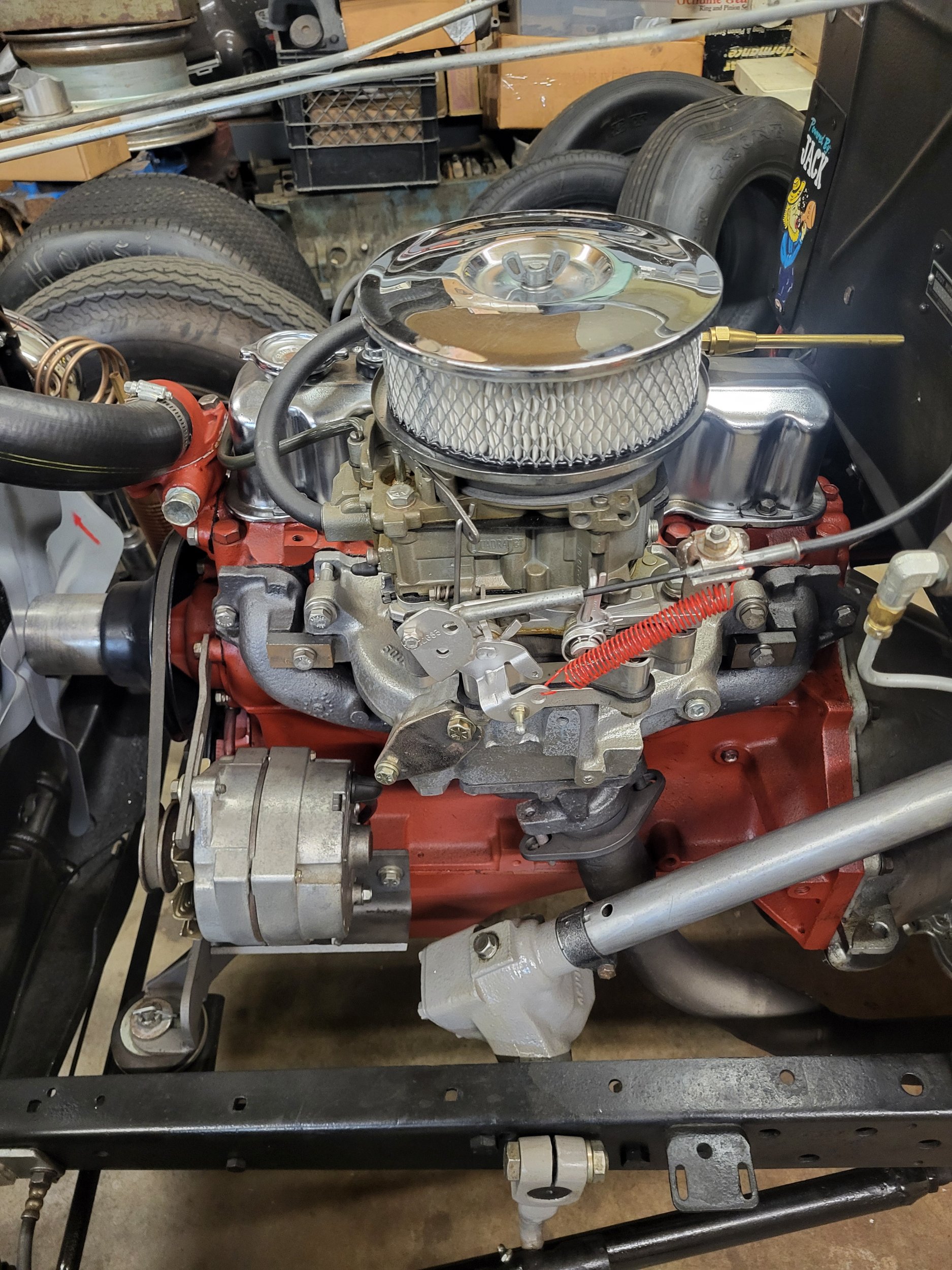

    I haven’t posted here in years, but this thread popped up while I was refreshing my memory on these little engines. I always enjoyed this thread, and the others about these little guys. I currently have two of them. Im building a header for one now. GPTempDownload.jpg
  16. Tim
    Joined: Mar 2, 2001
    Posts: 20,803
    Tim
    from KCMO
    Impressive fit in that header! Good job man
  17. Resized_20230123_192647.jpeg Hey Mr. Count...what intake is that?? Not as nice as yours, but I'm working on a header also. It's off a 2.5 Jeep...I think I can make it work without too much trouble. Gene.
    Count Scrapula likes this.
  18. Count Scrapula
    Joined: Oct 13, 2004
    Posts: 588
    Count Scrapula
    from Mid TN
    It’s a cut down Mercruiser.
