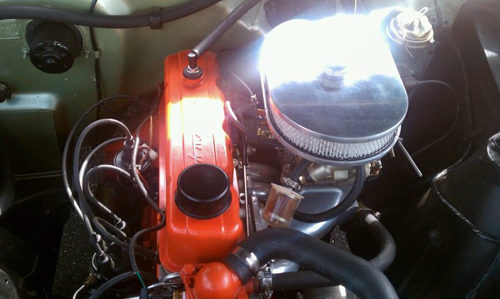

  20. Just got a hopped up 181. Going to re-ring it pretty soon. Looking to sell the Clifford intake it cme with and got to order or find a good cam for it. Plans are to put it in a lil modified one day. Does anyone know a part number for stock flat top pistons for one of these?I heard 302 Z pistons fit?
    -Shiny

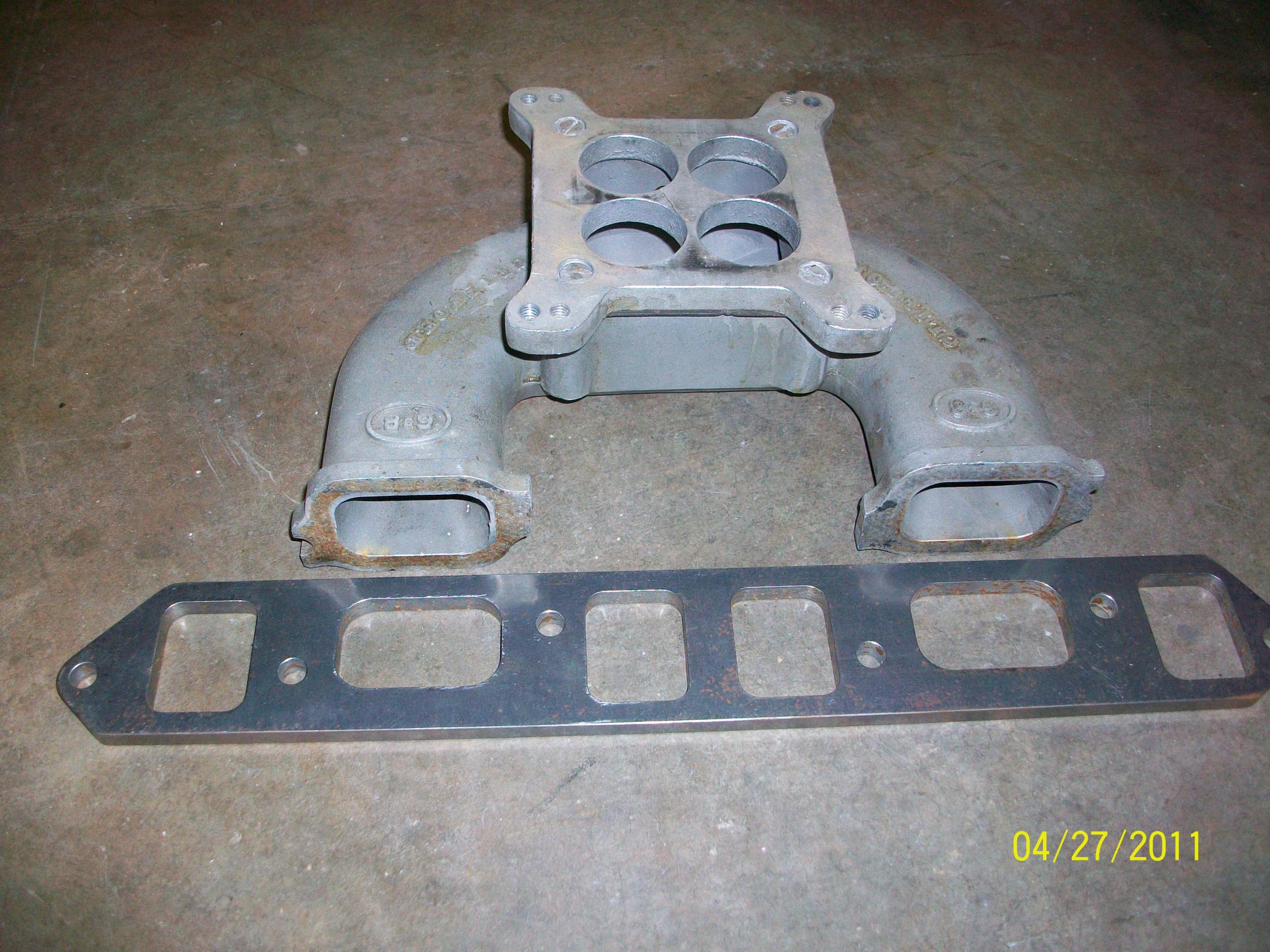

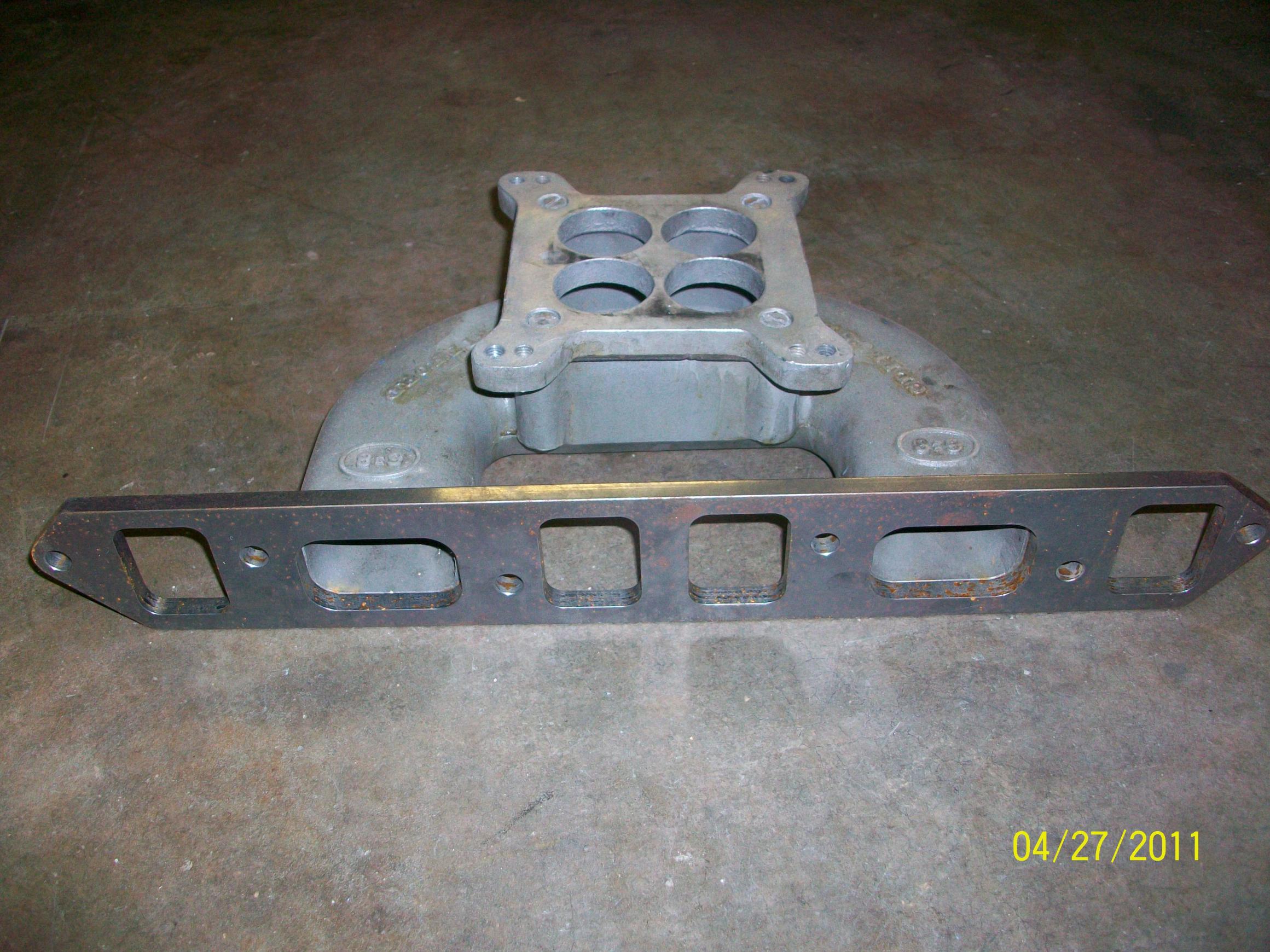

    The 181 engine as has been discussed in several posts is difficult to equip with manifolds. Cliffords does not stock any of that stuff for the 181 engine anymore. I have found a guy in Idaho that makes an exhaust plate to fit and it will accomadate the 153 intake. Hopefully I will be able to attach a couple of pictures showing this set up. His name is ted Stouder and his email address is Ted@northrim.net. He makes these in his business shop when there is time. Very high quality. You will have to finish the exhaust pipes yourself.
    The plate goes on the head with a 181 gasket then a part of a 153 gasket between the plate and the intake. 100_0751.jpg

    mahalic
    Who ever it was that tried to contact me regarding the plate as mentioned above, I was not able to attach your message. You can contact me at bentspoks@yahoo.com.
