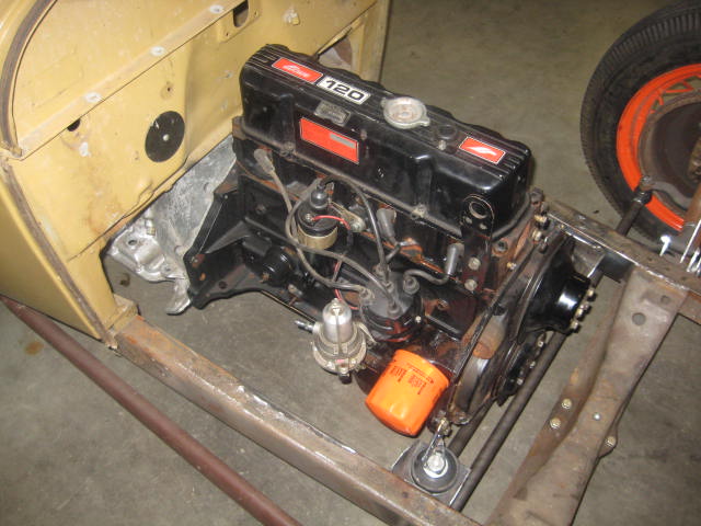

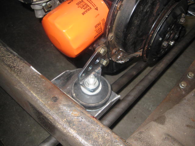

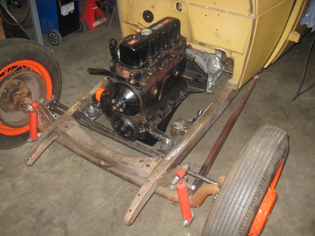

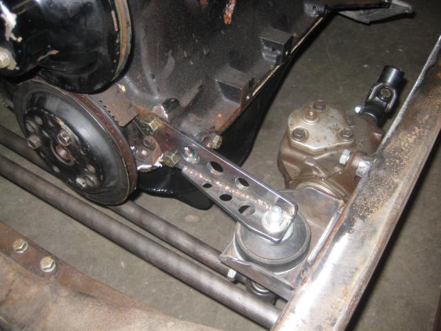

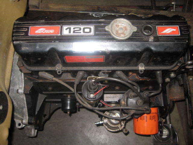

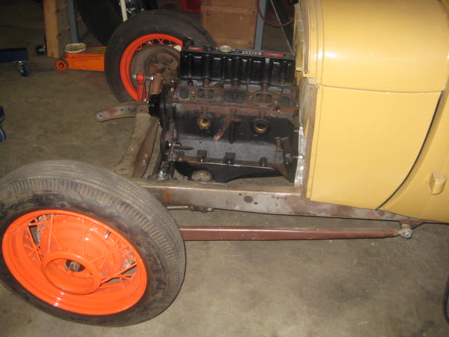

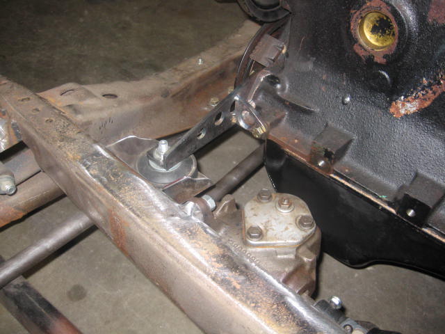

    Put my merc.cruiser in my 29 and I think the mounts turned out ok. I thought I would post some pics to get this thread on top again its been lost too long. Lets see some more chevy ll motors.

    Those mounts look great. I have a 2.5 in my 30 coupe. I just got a 3.0 and i am going to build it for more HP.

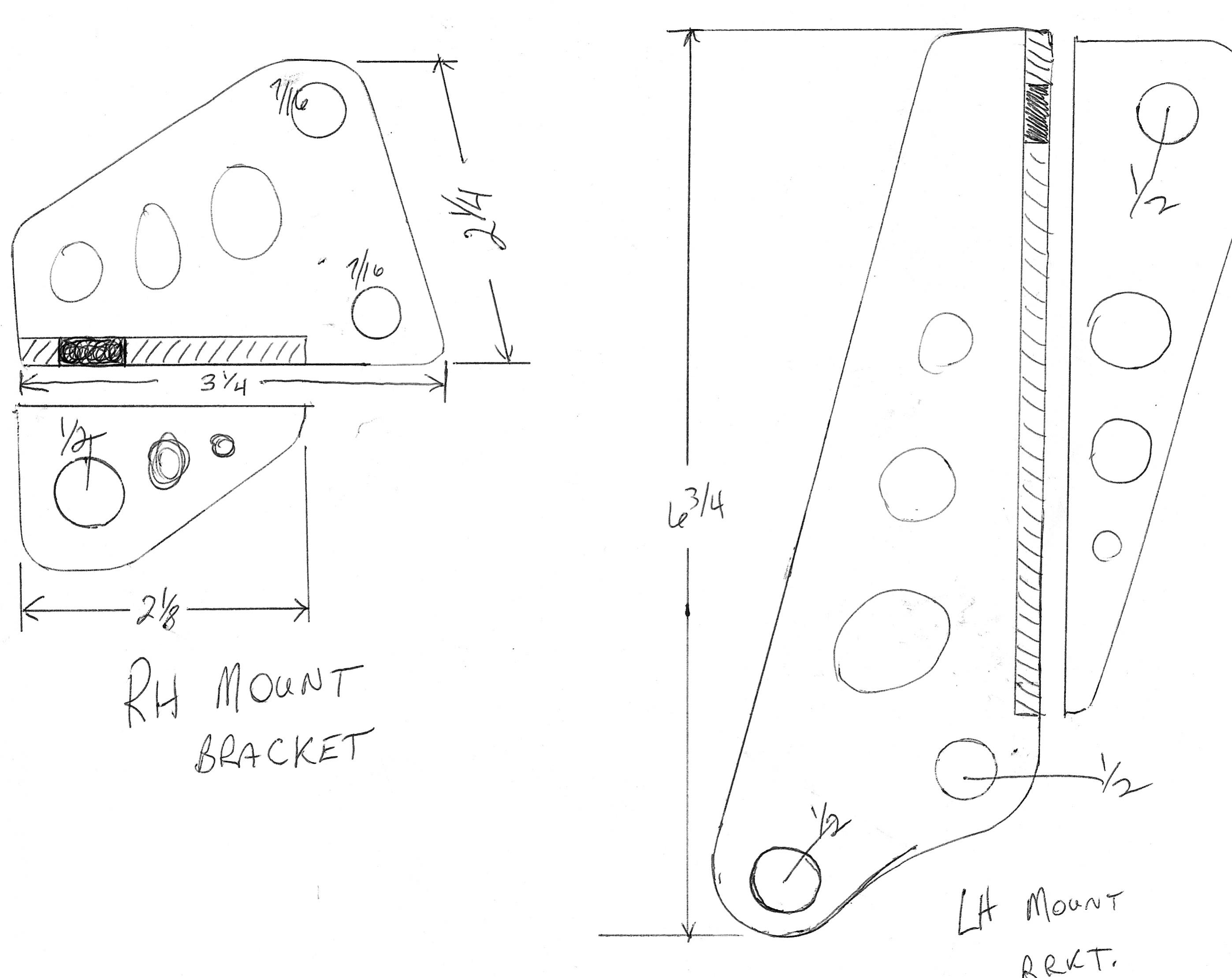

    Drew do you have the measure ments for your motor mounts front and rear plam to instal one in my 30 pickup thanks

    I`m sorry I don`t kind of made them on the fly. Just made sure engine was level and straight.

    Sorry I don't have any measurements on had. I can take a few pictures and try to gets ome measurements for you this week end. I used the front four bolt holes on the motor and made a plate that goes from one frame horn to another. The rear mounts are the original model A's with some modifications to bolt to the two side bolts on the chevy bell housing. The header came from Cliffords. I fabricated the intake maniflod from some aluminum channel, angle and conduit. Drew

    How long are your pieces of angle looks as if the driver side is alot longer speedway motor has frame mounts and pads all I need to know is the lenth you made yours want to mount the rear like Drew did his thanks

    The drivers side mount is longer. because the motor mounting boss on that side is much closer to the centerline of the engine, due to the block casting to accommodate the cam timing gear.

    QUOTE=chiliman;7282890]How long are your pieces of angle looks as if the driver side is alot longer speedway motor has frame mounts and pads all I need to know is the lenth you made yours want to mount the rear like Drew did his thanks[/QUOTE]
    Hope this will help.

    Thank you very much just what I need now if Drew will give me the same layout for the rear of the motor to the stock A mounts
