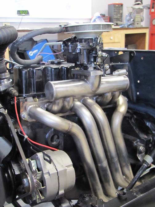

  12. This is the best one I have seen..its in Jersey Suede's 29 Pickemup!
