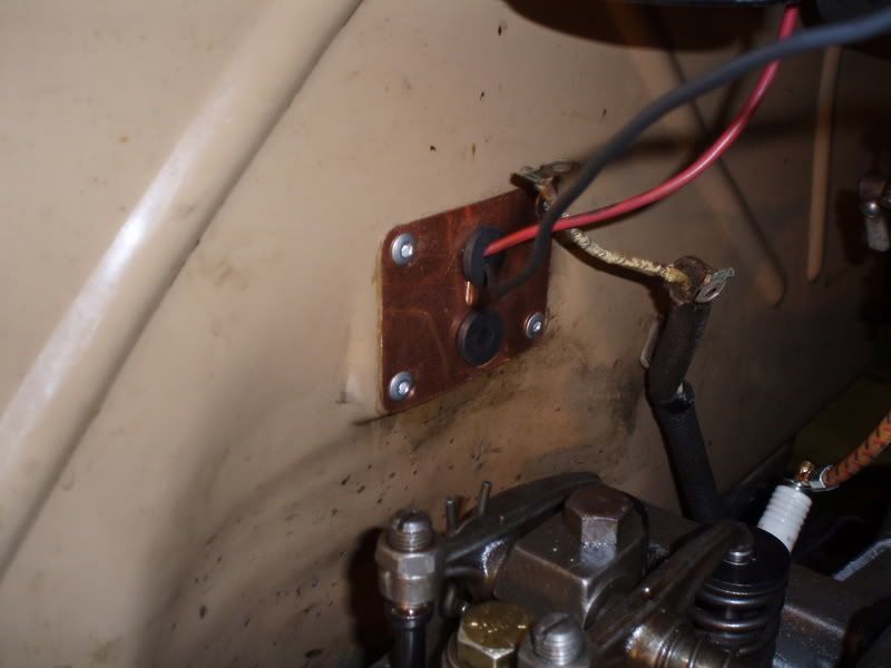

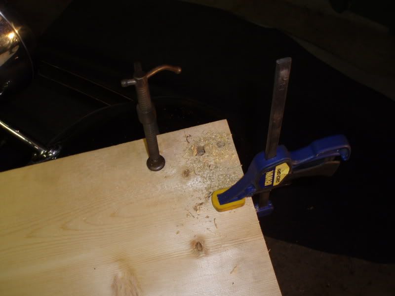

    I also needed to make a bulkhead fitting to clean up the wiring. The original plastic deal doesn't fit with the valve cover. I scored some copper sheet from a tin bender pal. Without the proper Knock-out it's tough to drill thin sheetmetal so I sandwiched it between some pine to do it with my budget tools cleanly.
    Here's the final result without doing anything that can't be undone. I am weird about butchering such a clean example of an original so I try to tread lightly. I like the idea of varying textures and materials which is why I used copper. I hope it doesn't look like I am trying too hard. Eventually all wiring will be proper fabric insulation type. The ignition wiring is an ugly necessity, maybe I can put it in a tubing conduit later.
