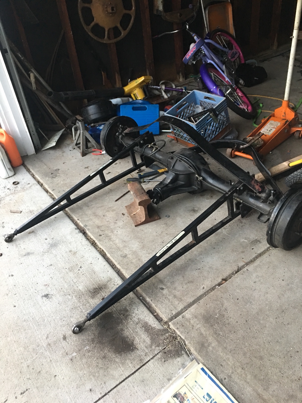

  11. jhouse88
    Joined: Mar 1, 2011
    Posts: 284
    jhouse88
    from toledo
  12. squirrel
    Joined: Sep 23, 2004
    Posts: 60,315
    squirrel
    looks like it's probably a 55-57 housing, the leaf spring perches look original.
    As mentioned, it's very common to have a different center section swapped in, especially in a hot rod.

    ^^^^^ 10 model years worth of interchange.

    Your current ladder bar set up is not going to be very pleasant on the street. If one wheel hits a bump, the parallel ladder bars will act like a big giant anti-roll bar. Your best bet is make new brackets to angle the bars towards the center of the car and use heim joints at the rear and rubber bushings in the front.
    Kind of like this
    -Abone.
    gimpyshotrods likes this.

    You seriously need to know the EXACT year of the HOUSING when it comes to axles and axle bearings; 55-56 are the same, 57 is all by itself, 58 on are mostly the same regarding axles/bearings. There are also some minor differences in the THIRD MEMBERS, but basically, 55-64 full size cars, 62-63 Chevy II/Nova, and 56-62 Corvettes are all interchangeable. But, stay away from the early Chevy II/Nova third members as they use a thinner casing and smaller bearings. It does look like a "P" case, if my eyes are't deceving me. With the 4.56 gears, you'll need to know what series the carrier is when it comes to changing to more street friendly gears; it can get confusing in regards to gear spacers, thick or thin ring gears, and solving those issues. I'm going to guess your housing is a 55-56, but if it has a drain plug, then it's a 57. The stock spring pads are only spot welded to the housing with 3 spot welds on each side of the spring pad (total of 6 spot welds). Only reason I say that is, they could have been added by someone, and would then most likely have full weld beads on the pads. Axle bearings will have ID numbers on them; that will help you figure out exactly what you have. The Corvette's are the same width. DZAUTO over on ChevyTalk.Org is the true guru on these rears, and he will gladly answer PM's from anyone. Tom Ordway is another member there with extensive knowledge of them. I am Butch/56sedandelivery
