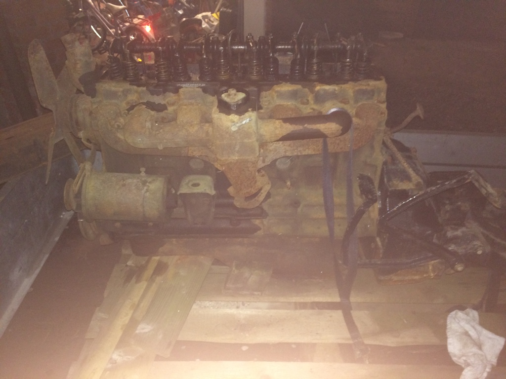

    Hey
    I finally got to pick up the engine I struck a deal on.
    The guy left it out in the rain, under a tarp, standing on a pallet, a couple of month.
    So now it's stuck, but at least it was free.
    The trans is also a little stuck, I can wiggle the sliding gear, so I have soaked everything in Diesel, and played with it.
    But I would love some ID and maybe some pictures/exploded views and some advice.
    Car or truck? What year?
    Could be syncro, could be crashbox?

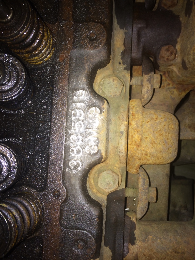

    Casting number ends on 6, that means 1946? So most be small truck?
    Thanks @jimmy six
  8. i think it is a 37-38[?] truck gear box. the trucks after that used pedals mounted to the frame.
    i had both a 37 and 38 truck here and they had a different pedal mount, i think the one posted is a 37 could be earlier. 37 was a motor change year, any pics of the engine?
    Hnstray and volvobrynk like this.
  9. 302GMC
    Joined: Dec 15, 2005
    Posts: 8,258
    302GMC
    from Idaho
    It's a '41 - early '47 3 speed truck trans. That's the one with rollers in the cluster, and is a little bit stronger than a car trans. Getting real hard to find.
    Working on two '46 4 speed trucks right now, doing Bendix brakes & 3 speed changeovers and need 2 boxes just like the OP ....
    volvobrynk likes this.
