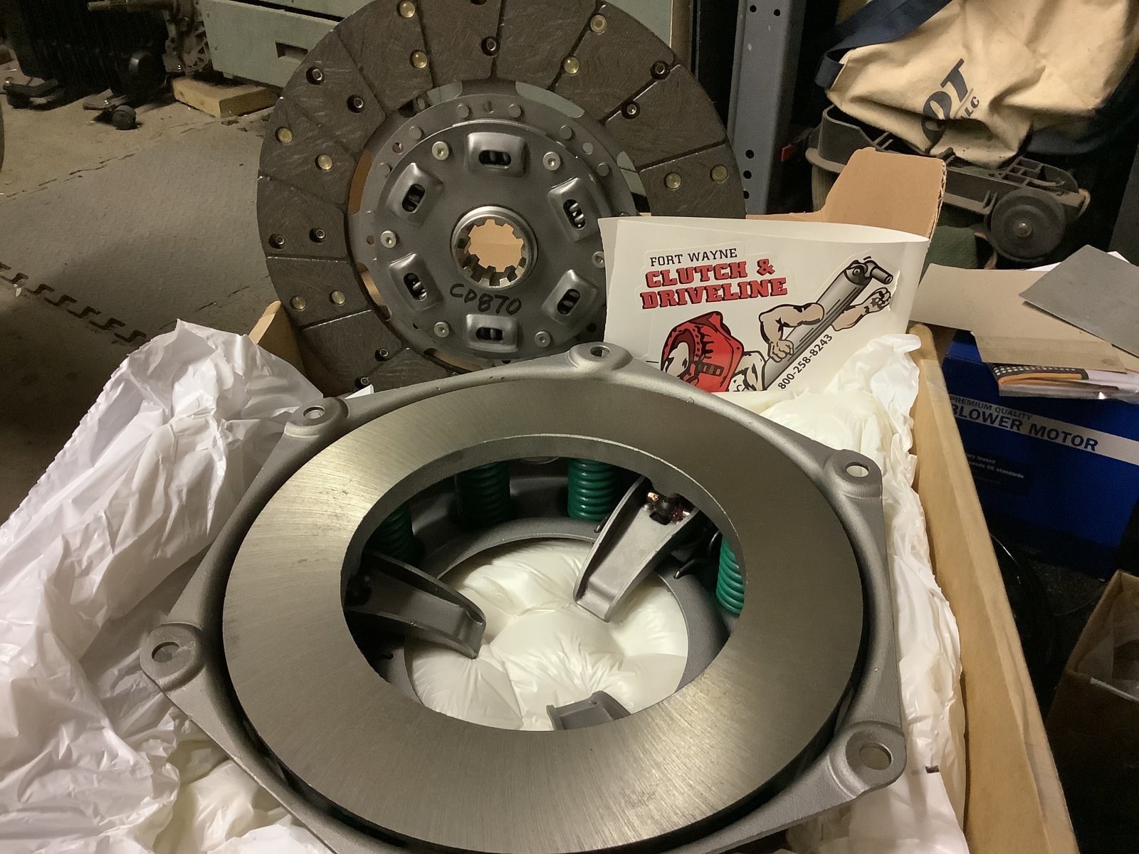

    The Mercury PP is almost impossible to get so call Fort Wayne Clutch and Driveline, he fixed me up with a PP that mounts to the Chevy flywheel and uses the Ford throw out bearing.
  13. From Ft. Wayne Clutch:
    #1310 Borg and Beck pressure plate, Ford 10 spline disc, early Ford T/O bearing, Chevy flywheel with B&B bolt pattern. Cragar Chevy to Ford trans adapter, block mounted late model stock GM gear drive starter. Core charge on pressure plate is $90 !!
    Hard to find. If you call, talk to Lou.

  16. chevyfordman
    Joined: Oct 4, 2008
    Posts: 1,501
    chevyfordman
