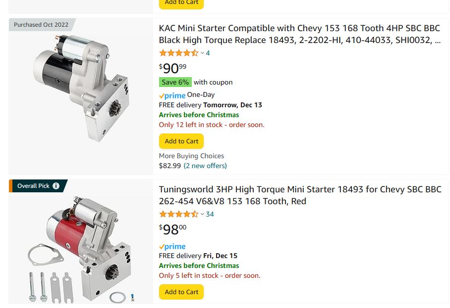

    There are a ton of generic aftermarket mini starters like this. Below are just a couple off Amazon. I never thought about machining the adapter plate itself, but that would work. You might still need a spacer between the starter body and adapter plate though, in order to get the right throw distance of the starter gear.
