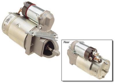

    I've got a 283 Chevy starter. I went to connect the front bracket and noticed that the starter through bolt is sheared off where the bracket connects. Anybody know where I can source that bolt? Thank you.:)

    Its the bolt that runs through the starter and hangs out the back for the bracket to mount to. You can see it in the smaller picture.

    Bolt is 1/4X20 ,get a piece of all thread . Cut to lenght and use 2 nuts ,one to work as the bolt head the other to hold the bracket. After doing this the correct part will sudenly become available !! Try a starter/gen shop is any in your area.

    with all the cool junkyards in cali why not do a search and seisure mission you might find somethig else you want or extras. also do you have a pick-n-pull near you some of the 305 starters have the same bolt in them

    Another solution would be to pretend it's like 98% of the other Chevy V8s out there, and remove the front bracket.
