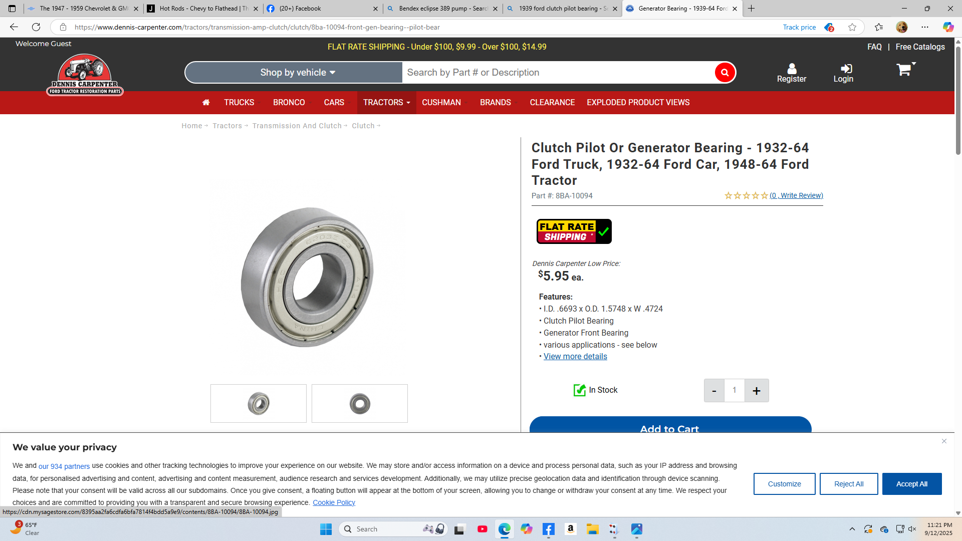

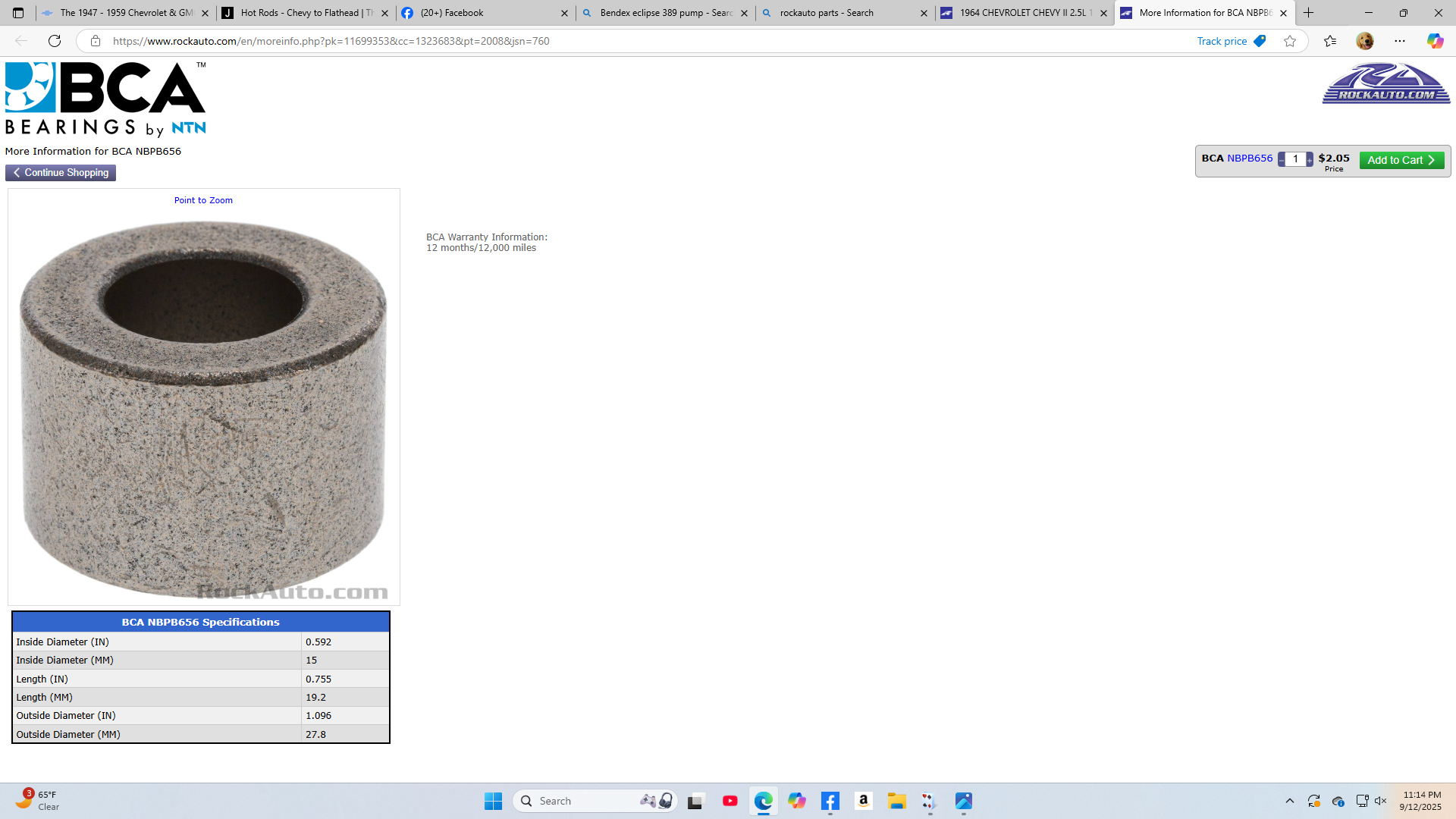

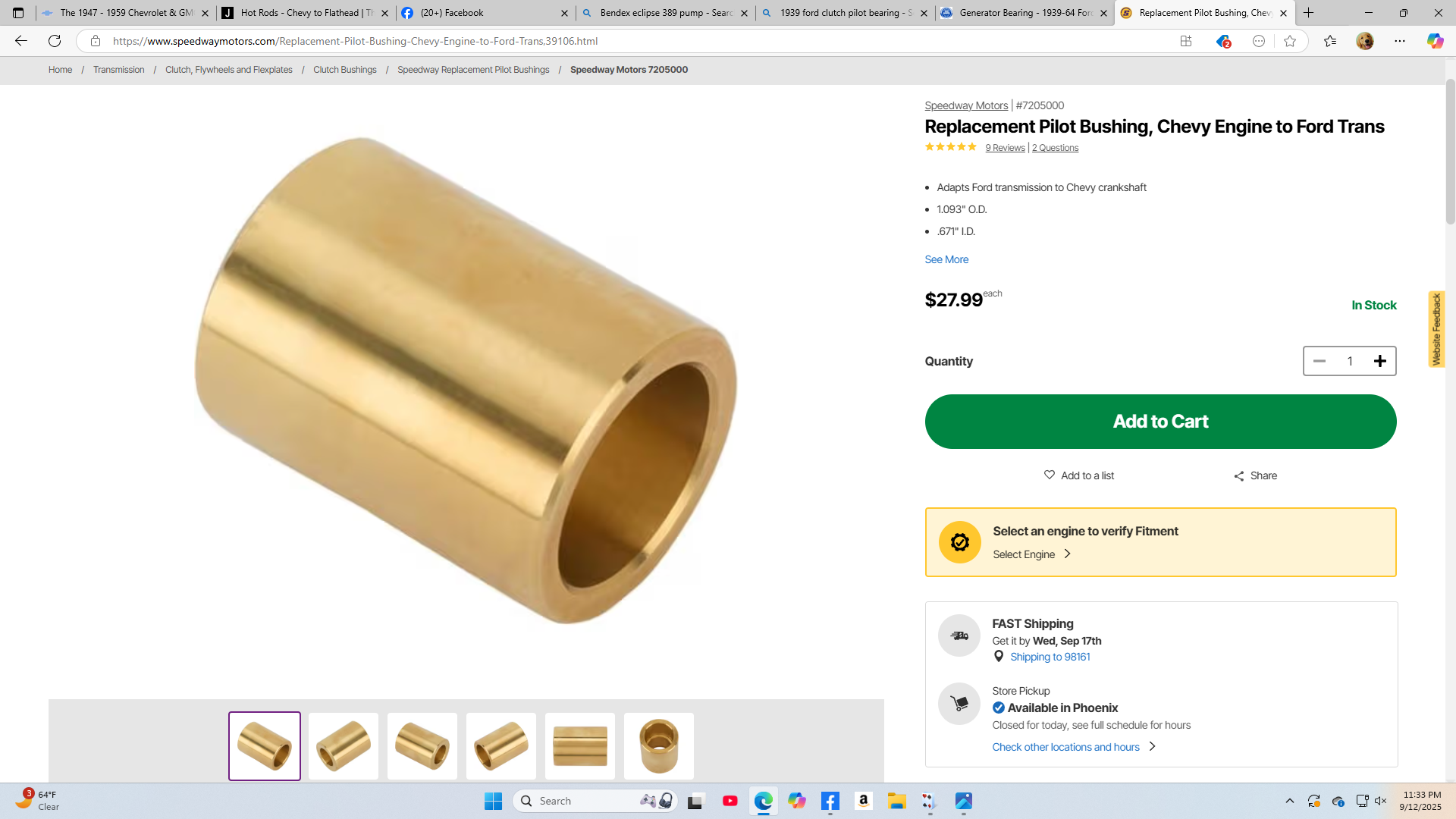

    Looking for some Examples of Ford flathead pilot bearings and ( I put in 64) chevy II pilot bearings I came up with these. ID of the Ford pilot bearing is .6693 while the ID of the Chevy II busing is .593.
    For the price the brash pilot bushing from Speedway isn't a bad deal. I'd like to have a bit more meat on the stub that sticks out past the end of the crank though. Screenshot (754).png Screenshot (757).png Screenshot (758).png

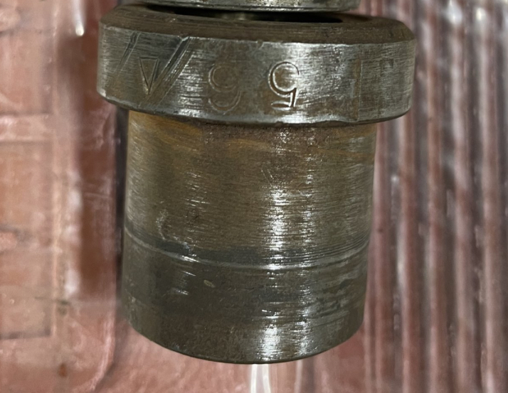

    this is the pilot bushing that came with a speed gems sbc adapter.
    Haven’t put it together yet.
    I’m using a 50 merc disc and pressure plate.
    3703870 is the gm flywheel I’m using.
