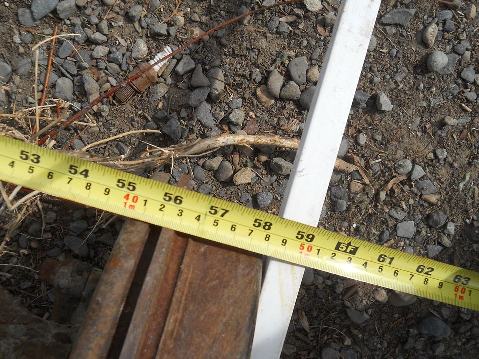

    WMS to WMS on the AD truck axle I have out here is 58-1/4.
