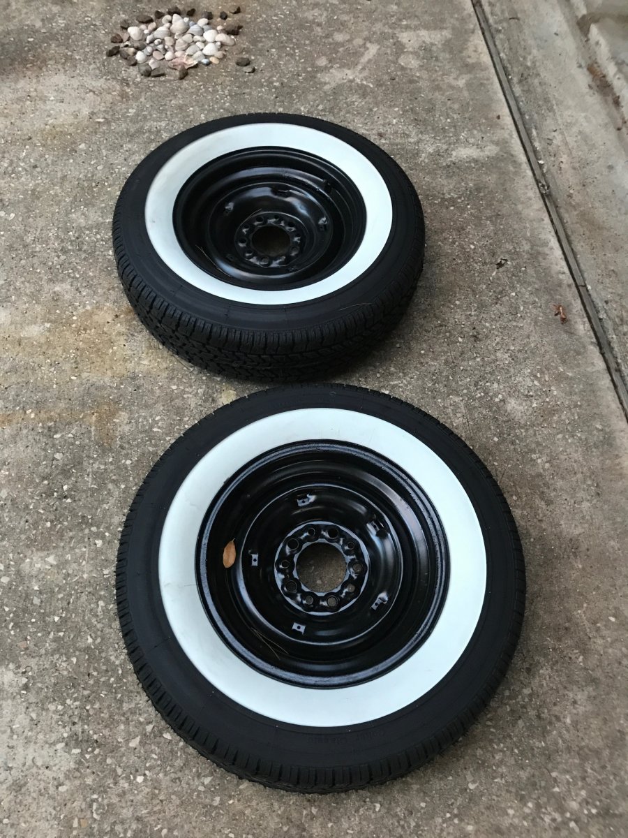

    Texasred did some measurements for me on his Buick rims and it looks like we have a match, the HAMB community never ceases to amaze me! gotta meet up and snag them since my whitewalls arrive today!!!! now to finish up replacing my chewed up wheel studs SMH. 2 out of 5 done wheelbolts.JPG

    Slow to update, but @texasred came through with his generous offer, gotta love HAMB folks! Sand blasted and painted them, cokers mounted, im rolling again!
    Next ill need to find some lancer or sombrero caps :cool:
