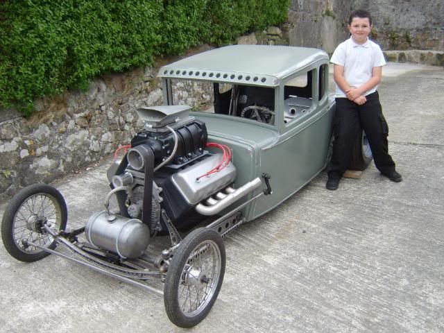

Childs play... Blown & injected A coupe

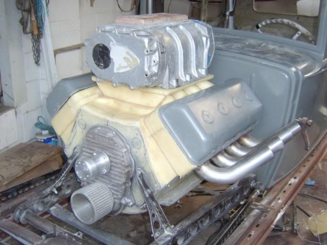

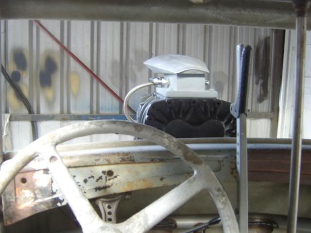

  7. Thanks to you all ... & i think i have been in trouble for a while now !!
    What with one thing & another time has been in short supply but heres a few mor pics...
    drivers view..
    the block was made from foam & fibregl***ed over
    It was then painted in resin & fine grit sprinkled over it for that cast look
    front suspension is ford pop/anglia & austin seven spring & friction shock
    The blower is a swap meet find & fibregl***, the scott injector was made the same way as the block & the hat i knocked up from some sheet ally add the idler & dummy fuel pump & some hose's make it look right ! & some other real parts !!
    And here is the ch***is with the body off for final welding

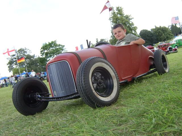

  22. This was jacks first rod he started driving when he was just five,
    We rebuilt it 4 years later to become this...
