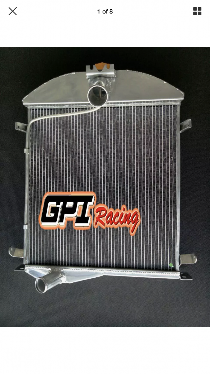

    F975F4F2-AD37-4C22-8498-A81AF954E2A8.png see a lot of these cheap O aluminum ratiators on eBay. Anyone use these? I need one for a 28’ grill for Nailhead. Ford application would work. Mistake? 255$ free shipping

    May be built in NJ? Hard to believe

    They sure are tempting price wise. The caps they provide do not inspire confidence. And they are not repairable.

    The radiator that is shown looks like it has the overflow going back up into the filler neck same as the original.
    If that is the case you would be unable to pressurise the radiator.
    Alloy radiators are easily repairable, we repair motocross radiators, and in many cases press them straight before repair.
    If you use an alloy radiator make sure it is well earthed, one wire to the frame and one back to the battery.
    There are plenty of additives to use with your water without having to use distilled water.
    Many modern cars use alloy radiators.

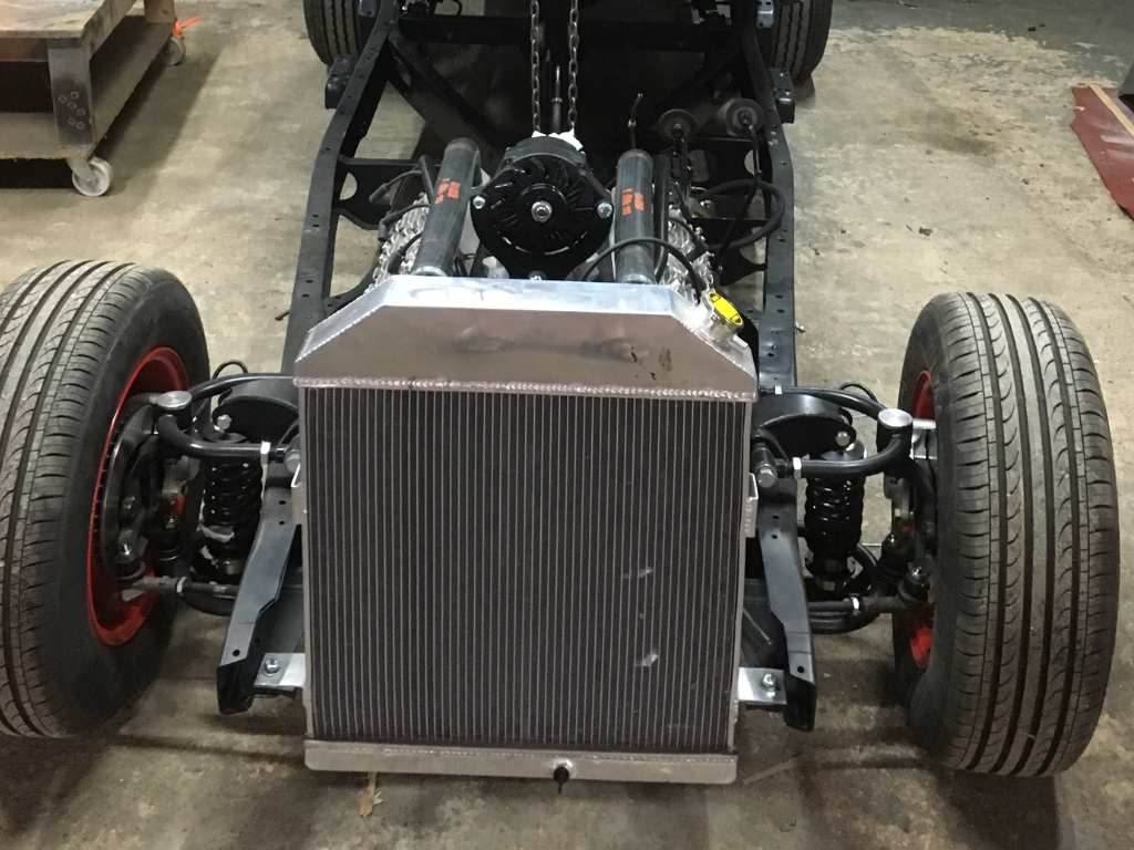

    Bought one off ebay for my 58 AMC three years ago. Bolted right in and haven't had an issue yet. I also bought a Honda civic rad that had a fan and shroud on it. I needed a low cut rad due to my roadster project being channelled big time. Haven't tried this one yet but the outlet for the rad hose are on the same as sbc and I can get a straight up or 45 degree water neck for top. You can get them in three or four core. I included a picture of a similar one I bought minus the fan and shroud. I'm not running a hood and with the shroud I think it will work out.

    Man thats some ugly welding, no way I'd trust that kind of worksmanship. Better to spend your money on a radiator like those produced by U.S. Radiator. Worth every penny. In 1996 I ordered one from them, put it in my avatar on a Friday and the following Monday started a Virginia to California road trip cooling a 400+hp 429 towing a trailer, didn't worry about the quality because they had a good reputation and had NO problems. You get what you pay for.

    Update: GPI racing on eBay got back to me with the radiators are built in China and some customers feedback saying they will not fit and do not recommend. benderb426 on eBay said: they build custom radiators br*** and copper. The are around 600$. Conclusion: as said above, you get what you pay for
