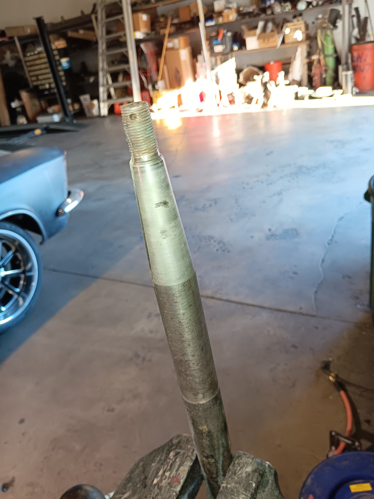

    20230921_112325.jpg Thanks to 1oldtimer, I finally got the correct axle. Hopefully, I can get the job done Saturday morning.

  18. It's the tapered part that does most of the load of holding, the key is a backup and the engineered breaking point. If the key material is too strong and the tapered fit is to weak it will break the axle like your other one. The screwdriver should be ok, just make sure you lap your mating surfaces together (axle and hub) before you finish up. I think there was a post on here about the process of tightening up the axle nut AFTER lapping. Something about tightening up, then driving around the block, tightening again, then driving again and finally using a torque wrench to get the final 200 or so foot lbs.

    Lap the hub and axle, clean it well, then install the key and torque the nut to 220 lb./ft.
    And then check it a few times...

    When you lap the hub and drum. Are you using valve lapping compound or some other compound?
  21. warbird1
    Joined: Jan 3, 2015
    Posts: 1,296
    warbird1
    Yes, just some good old Clover or other brand of valve lapping compound. Slather some on the axle, slap the hub on and work it just like lapping a valve. Back and forth for a bit, then shift the position of the hub a quarter turn or so and repeat until you get as much contact between the axle and hub as possible. Afterward clean things well 'specially the keyway...

    I lapped the axle to the hub this morning. And it didn't take too long and it came out pretty nice. 20230925_082030.jpg 20230925_082023.jpg
