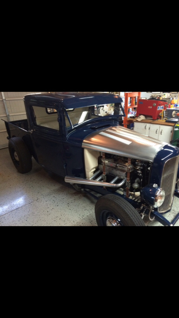

    I chopped mine 4'' and didn't mess with the pillars. It might look a little thick at the top but no one has noticed. I did have to finesse the ws frame to reinstall it. [​IMG]
