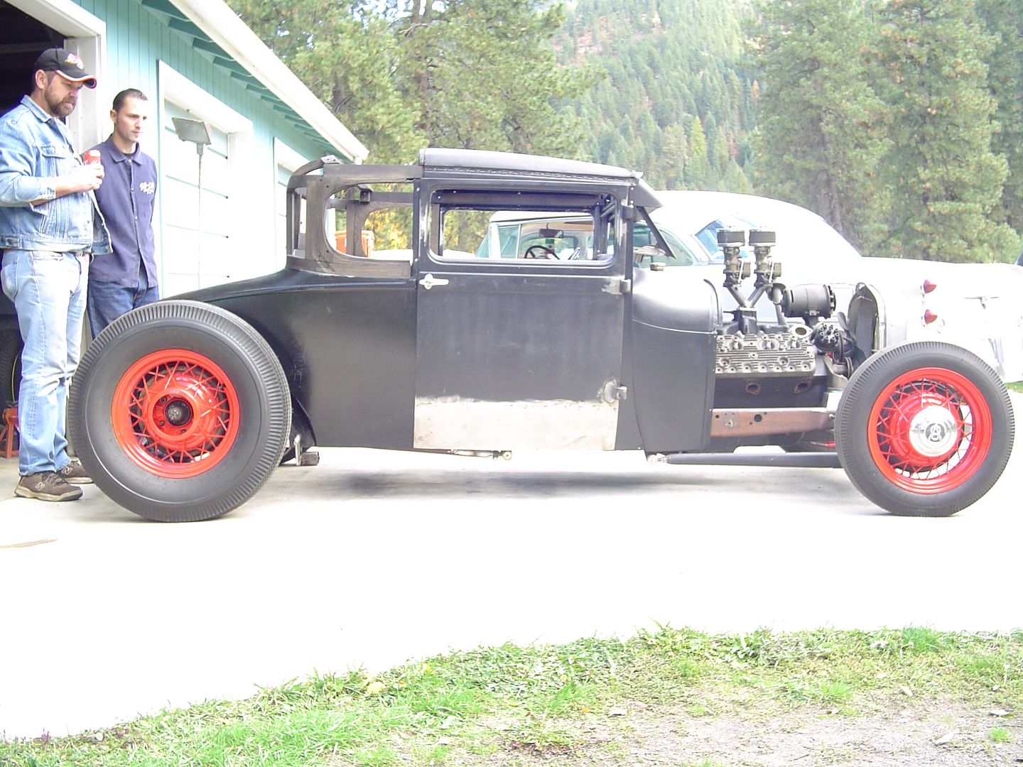

    Heres my pal's 29 special and other friends 29 coup.e Both chopped/channeled.

    Yes that's one of the builds I've been following. Beautiful car.
    The full vinyl roof is starting to grow on me. I have the kit with my car and think I'll be doing the same.
