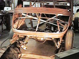

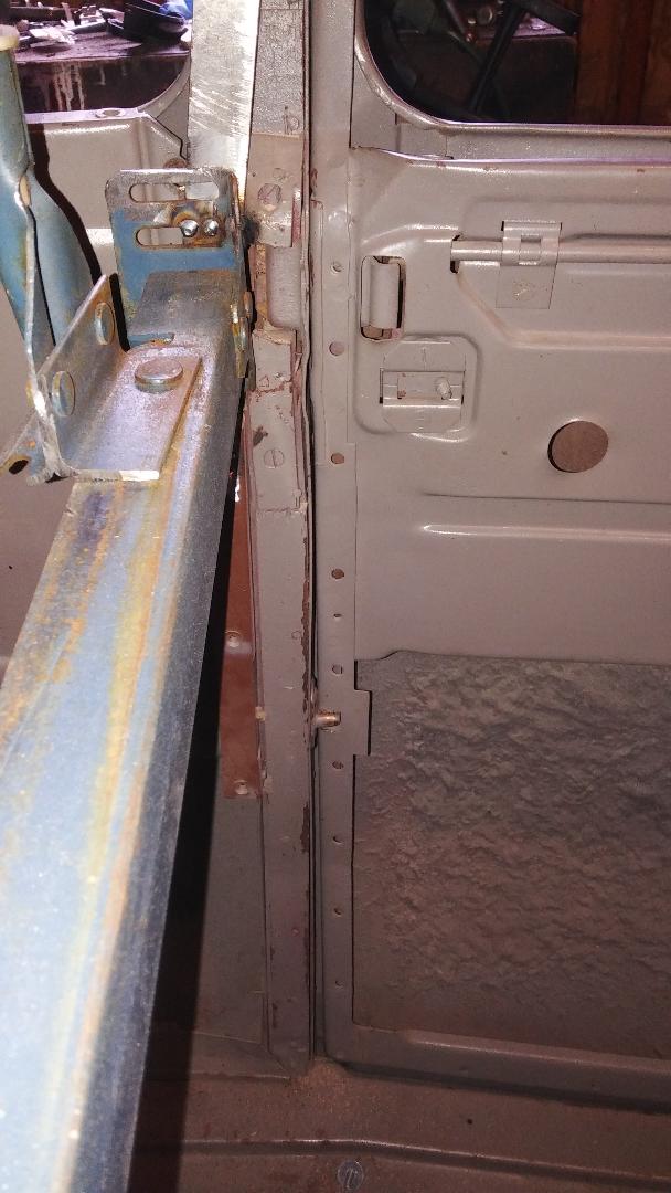

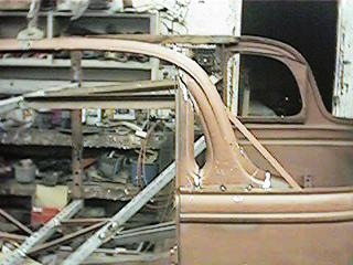

Don't remember if there was a gap at midpoint when I put the body on. The body could have had stress on it as I just put blocks between the body and frame. Every thing lined up ok so I didn't shim it. here are a couple pics of bracing and gap at door top and bottom. Have 1/4" gap at bottom and none at top. just trying to figure out at what point to start straightening the body. I guess put the top back on and see where it sits?
Is that flat bar going across from door to door? Flat bar does not have a lot of rididity (sp) to it when under stress from the sides as the diagonal bars could load it up. As has been stated the body could of been stressed at the mounts now causing this twist. I would try losening the body mounts or torquing them down little by little to see if the car “ springs” back Side to side and diagonal measurements are in your future by the bushel full. Good luck! I’m sure you said this more then once !
Bed rail angle is not good for welding to. Nothing sticks very well or very long. It’s a MF to drill or saw cut too. The stuff makes great straight edges because it’s too damn hard for anything else. The Body envelope is kinda sturdy and might span gaps, but if you open the envelope by cutting the top off it’s sorta like jello. Get the shims right, bolts right and it will get a lot better on its own. Then you can play with pushing and proding
If you are positive that the frame is not swaybacked on the side... Then leave the roof off until you get that gap correct. See the body bolt that is close to the B pillar?, add shims under that mount until it is perfect. or you may need to also shim at the A pillar closest bolt. I always check the bare frame first. I use 4 foot bars across the frame rails every 2 or 3 feet. Then I sight down low to see if all the bars are level with each other, and if one part of one rail is low or high, you will never miss it as that bar will just look wrong. One other thing when shimming just one side: You don't want to end up with one B pillar bowed out, or in too far...this is where you dry fit the roof, then stand in back and front, sight down both sides of the body from every possible viewpoint. I always spend a lot of time on gaps, whether chopped or not, striving for perfect in the beginning. If you start with a "close enough" at***ude in the very beginning, bad gaps will just make everything messed up the more you go... with welding or even patch panels, etc. Any extra hours will pay off with a finished good build.
