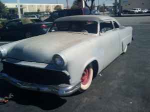

  9. my first attempt:
  10. Tank
    Joined: Nov 8, 2002
    Posts: 749
    Tank
    ouch.

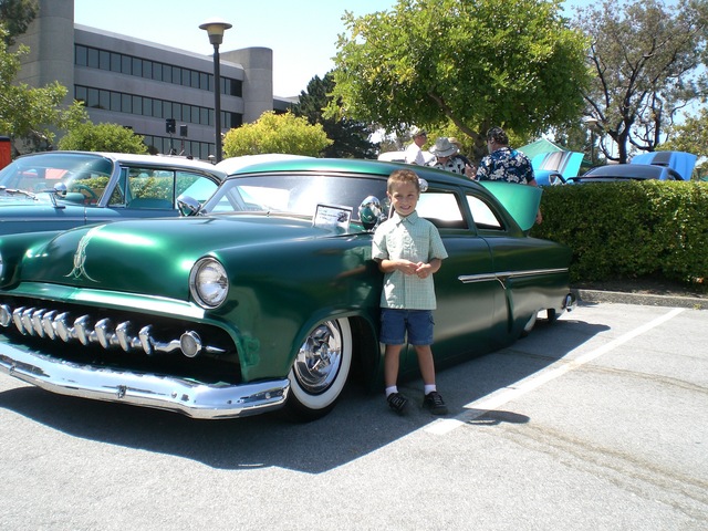

  11. Here's a local car. Sorry about the dark pic.

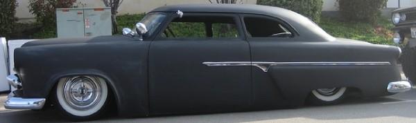

    Wisht I had a side view of this one. Looks nice- Move kid! :) Doing the same, making the call in the morning. The person that is doing my chop is an asskickr and a perfectionist. I'm particular, so it not being done right isn't an option. Plus, I get to do all the grunt work- yes!

    Here are profile pics of that car SlmLrd.
    It uses a 49-51 rear backlite, if I remember correctly.

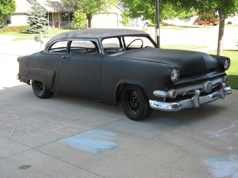

    Thanks for all the info. With the good examples given, I'll be able to figure out what I am going to do. Gonna roll it by Ian's next week to brainstorm. Here's a pic of how it sits now. Couldn't find a good side shot on my computer though.

    That Jimmy Vaughn one shows how a little restraint can work wonders. A couple of inches out will improve the lines while still making people think it came that way from the factory.
    But, if you want people to know it is chopped, it looks like a shoebox rear window is the way to go. To me the heavy rear pillars seem to make it look older, but that green one, and SlmLrd's opic above definitely have a nice flow to them.

    I was looking at the square chopped one and to play the snobs advocate Id say looks like just enough chop but the side windows look funny. too much meat around the glass inside of the molding? too long? not shaped swoopy?
    Looking at the other chopped car at the car show what doesn't look like it belongs from the front is there's this beautifully curved hood and roof but a windshield topline that's straight as Olive Oyle. It'd be a bitch to do anything about changing that but... a well designed visor matching the shape of the roof and hood would hide the top of the windshield perfectly and be period.
    The chopped down back window looks odd. Replacing the back glass looks fine but I'm almost certain you could retain the wraparound backglass without trimming it or recessing it into the package tray.
    move the back glass and it's frame foreward some, keep the angle and height as is so it still looks right at the trunk and it should meet the high portion of the roof skin before the roof skin turns down as it goes back.
    You'd have to totally redesign the side windows to match the contour of the back glass.
    I can see it like that
