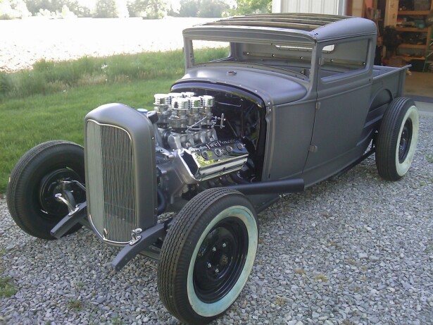

    Thanks dude! I was gonna use the stock exhaust manifold, not header. I'm going to lob it off where it dumps around the cowl and run a V8 torque tube I got (big ol *******) it has a lot of taper and is very wide at the end.

    Doh! No, I haven't had a chance to measure yet... It's over at a club member's shop right now or else I'd just go measure it right now...
    My chop was measured by laying out 5" worth of painters tape, and cutting on the outside of that line... So maybe 5 1/8" at most, and it was measured several times, it's 5".
    Keep in mind too that it will vary from 28/29 and 30/31, because the earlier (28/29) years had larger windows, so 5" of chop looks like less than it would on a 30/31.
    I'll try to remember to measure it when I'm over there, or when I bring it back to my house..

    So, I'm getting lots of **** done on the coupe. Got it running ***s, got my 40 ford wheel ready to go on, etc. Also got to tearing into the front end and one thing led to another...
    Started out with "let's just freshen up the brakes, get some camber in it, fix the tie rod, etc." Now we're splitting the wishbones, drilling the axle, reversing the eyes on the spring, new shoes, wheel cylinders, lines, turning the drums, sandblasting and painting everything, etc. etc. It went from an afternoon job to a week job in about 15 minutes of pondering and a little peer pressure from the other club guys.. ****ers corrupted me.
    At least with splitting the bones I'll be ready to drop a flatty v8 in it, or maybe an old 283 or something once the banger blows up.
    One things for sure though, this thing is gonna drive nice when I put it all back together. Thinking about an F1 box too. Why not, I've gone this far already....

    Making a little progress. My plates came in for the wishbones, hopefully will get them on and the wishbones split tomorrow. Doing some experimenting with pulling leafs from the front spring, checking out the stance vs position of the shackles and trying to find a happy medium. It was raining like hell so I didn't feel like pulling it out for a side shot right then, but you can get an idea.
