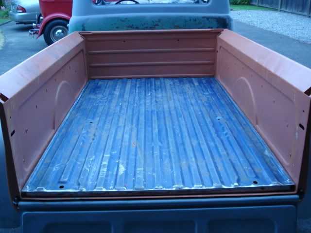

    An update on the truck. I have filled the cowl vent and the gas filler and misc. mirror holes and finished stripping the hood and two doors to bare metal and fixing a small rust hole in a corner of a door. I have also used a modern Ford p.u. box floor to replace the wood one. Far less expensive than buying wood and runners and hardware. The truck will now go back in the corner, while i work on a new project for a friend. Hope to get back on it in the fall, i would like to drive it next summer in some shade of tinted primer of course.
