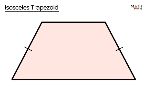

    I would like to reshape a curved rear back gl*** from essentially a rectangle to an isosceles trapazoid like this: The curved sides would remain but the top total gl*** width would be closer than it is right now. The lower total gl*** width would remain the same. Make any sense?
    I picture 4 cuts which would remove 2 pie shaped pieces. Is this even possible with tempered 1959 gl***? If so, what kind of shop should I be looking for? (please excuse my complete lack of knowledge on gl***). thanks

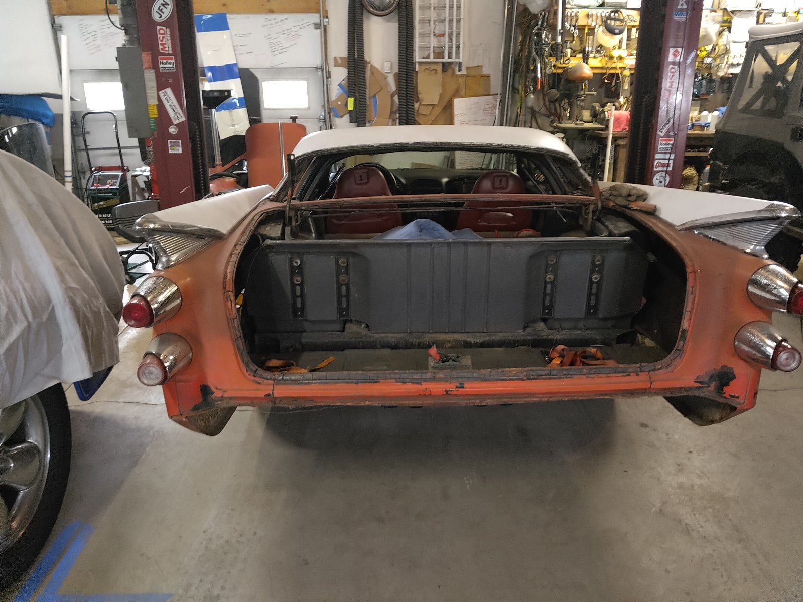

    I think this is a wise idea... I just mocked up the back window with a 6" chop and I really like the look. (and putting it back together is within my neophyte skill set)... I think the process will be get the opening where I like it. Maybe a form that I can flip side-to-side so I know they are the same, then create a full size template. Not sure how I might do this... cardboard then fibergl***? Look for a custom gl*** place like this one https://www.procurvegl***.com/ or just use lexan... any thoughts?
    here's the victim...
  19. junkman8888
    Joined: Jan 28, 2009
    Posts: 1,085
    junkman8888
    wetskier, a side picture would help, from the one you've posted the only option I can think of is 1970 Camaro back gl***
