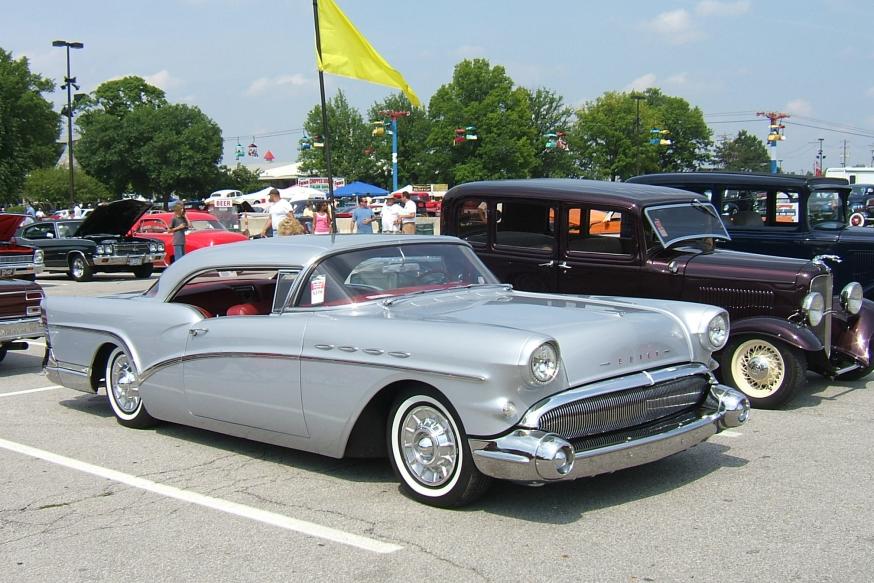

    When I chopped my 57 Buick I sunk all the glass
    TwoChops
    kidcampbell71 likes this.
