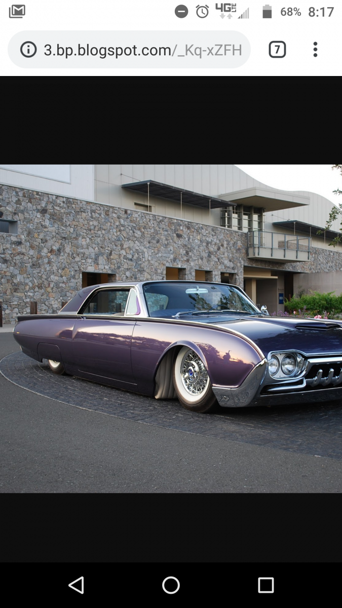

    Looking for something like this. It has been done. Agleast three times that I can find.

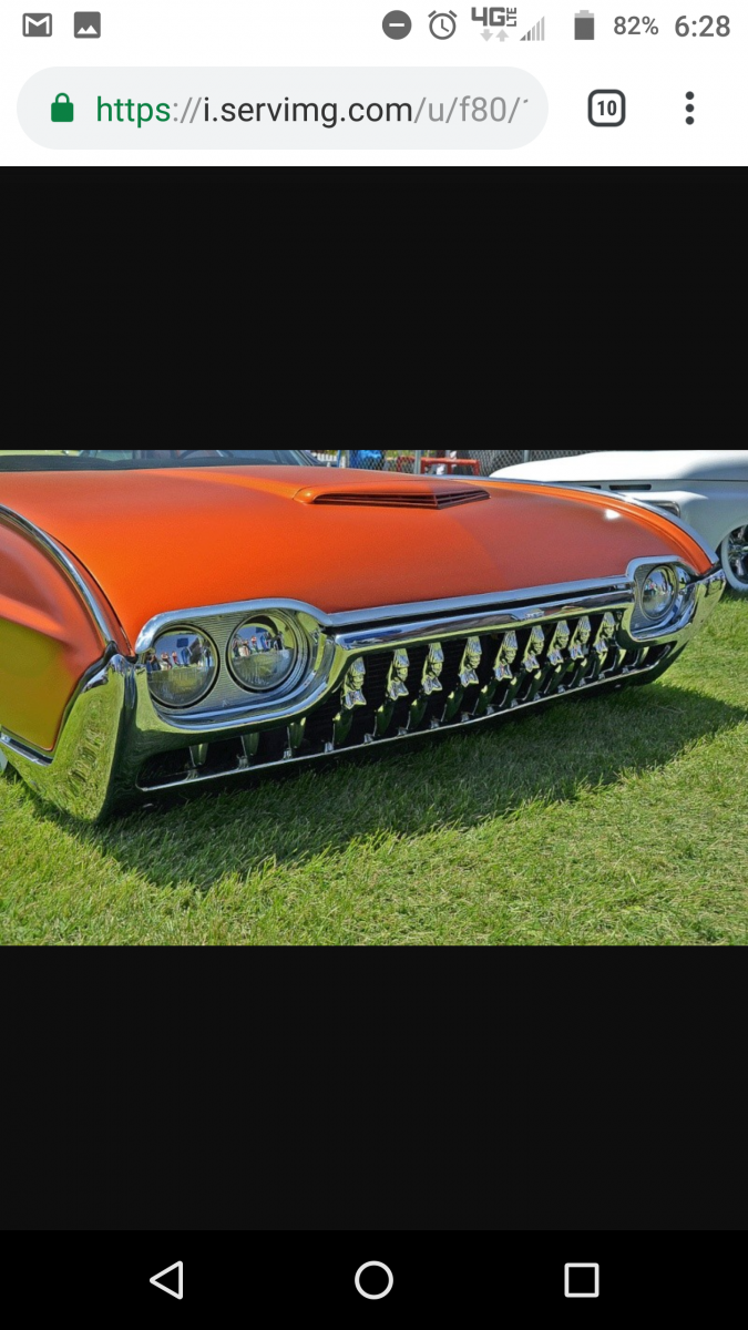

    Porkn******-thanks for that. With that though wouldn't I have to lean everything else in as well including the wide b pillars and windows as well as cut the back window to match that lean?
    Apologize for the picture of the grill. He's anithra chopped bird.
