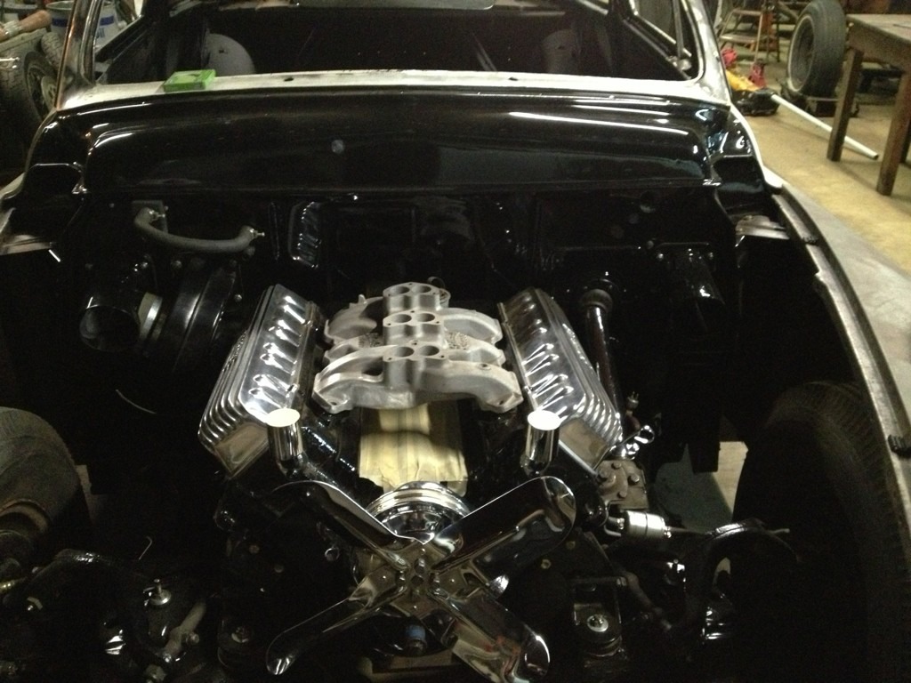

    I modified the hell out of that water pump and made my own cross over tubes out of the heads that house tiny little Honda thermostats.
    I'm running the stock Merc/flathead radiator with the two upper hoses.
    Trying to clean up the front of the engine!
    Here's a ****py small picture of the housings and the water pump.
    I also made up a nice little oil filler to get rid of the oil filler/fuel pump stand on the front of the engine... It's the simple things that make me happy:)
    I just got this back from chrome..But forgot to snap a recent pic

    Hell yeah Jeremy.That is what I´m thinking of doing with my waterpump too.Did´nt noticed that at first.Looks good.

    I have a friend who´s running volvo thermostats in the tubes on his flathead and it works just fine. I think it would be a cool thing keeping the stock radiator and both inlets, giving it more of an original look.Did you get any trubbel cutting the tubes of off the pump?......Kenneth.

    I didn't run into any trouble with the water pump at all. Just welded up the hole in the top where it connected to the crossover. You could also tap it for a pipe plug and do a nice stainless plug
