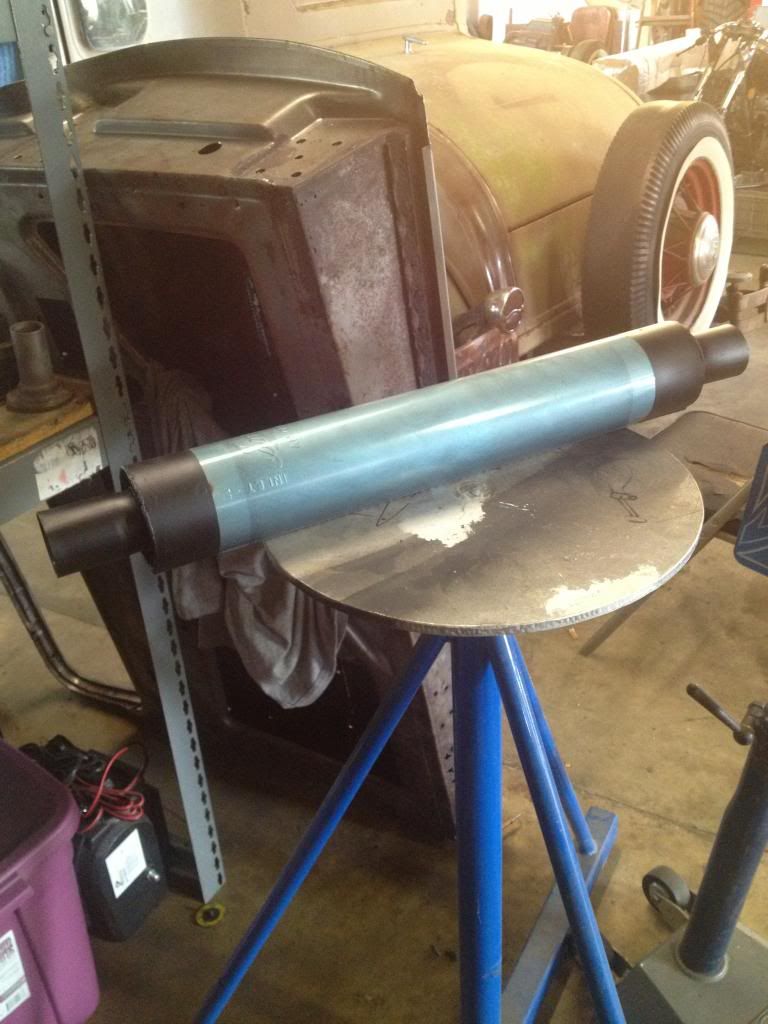

    and I know I'll probably catch some flack for this, but I had a few set of smitty mufflers but I didn't want gl*** packs...I wanted steel packs.
    so I cut those apart and made a few changes to the baffle core and repacked them with stainless steel....I know I know boring stuff but I am pretty excited to hear how they sound!![​IMG][/URL]
    [​IMG][/URL]
    I'll probably end up chroming these.... the paint is temporary.
    [​IMG][/URL]

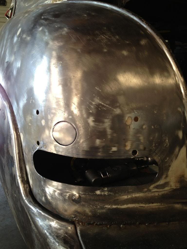

    alright on to fun stuff!!!!
    I had a very productive weekend and am really happy with how these turned out.
    here's how the process started
    with a set of lenses and round rod from winfield
    gotta make a few holes go away
    all tacked in... lets not focus on the bs holes that some *** clown put in the side of my quarters to get fibergl*** to stick.... still need fix them.
    and the finished result!
