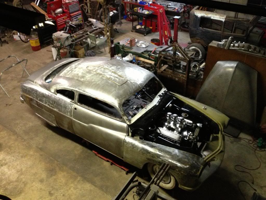

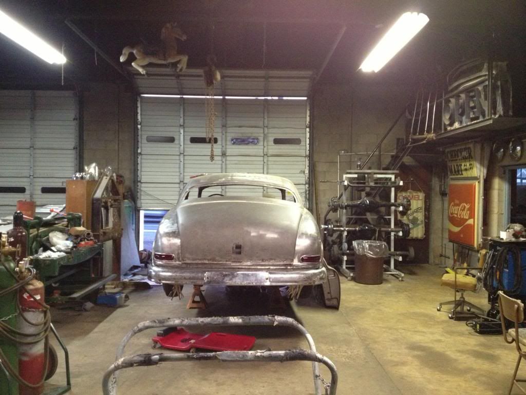

    here are a few pictures from today.
    I really need to find a better rear bumper, but this one is good enough for mock up (its dented and twisted all to hell). stay tuned for the Kaiser bumper guard install. I am hoping to start on that this weekend.
    and here's an over all shot of the Iron lords shop.... the junk the clutter and the projects. 6 guys in one shop isn't always awesome but it has made for a ton of good times!
    panoramic of the place.....cleaner than its been in a long time!
  12. BRENT
    Joined: Jun 22, 2005
    Posts: 252
    BRENT
    Did you make a buck and bend the rod with a torch to form the shape for the tailights?
    Brent
  13. JeremyJames
    Joined: Aug 11, 2008
    Posts: 432
    JeremyJames
    from concord NC
    that's how they were done. the lenses and 5/16 round rod cam from Winfield. they were priced affordably enough that it wasn't worth my time to build a buck and make them.... normally I would do this type of work, build a buck and bend them up but I was really excited to have parts from gene Winfield.

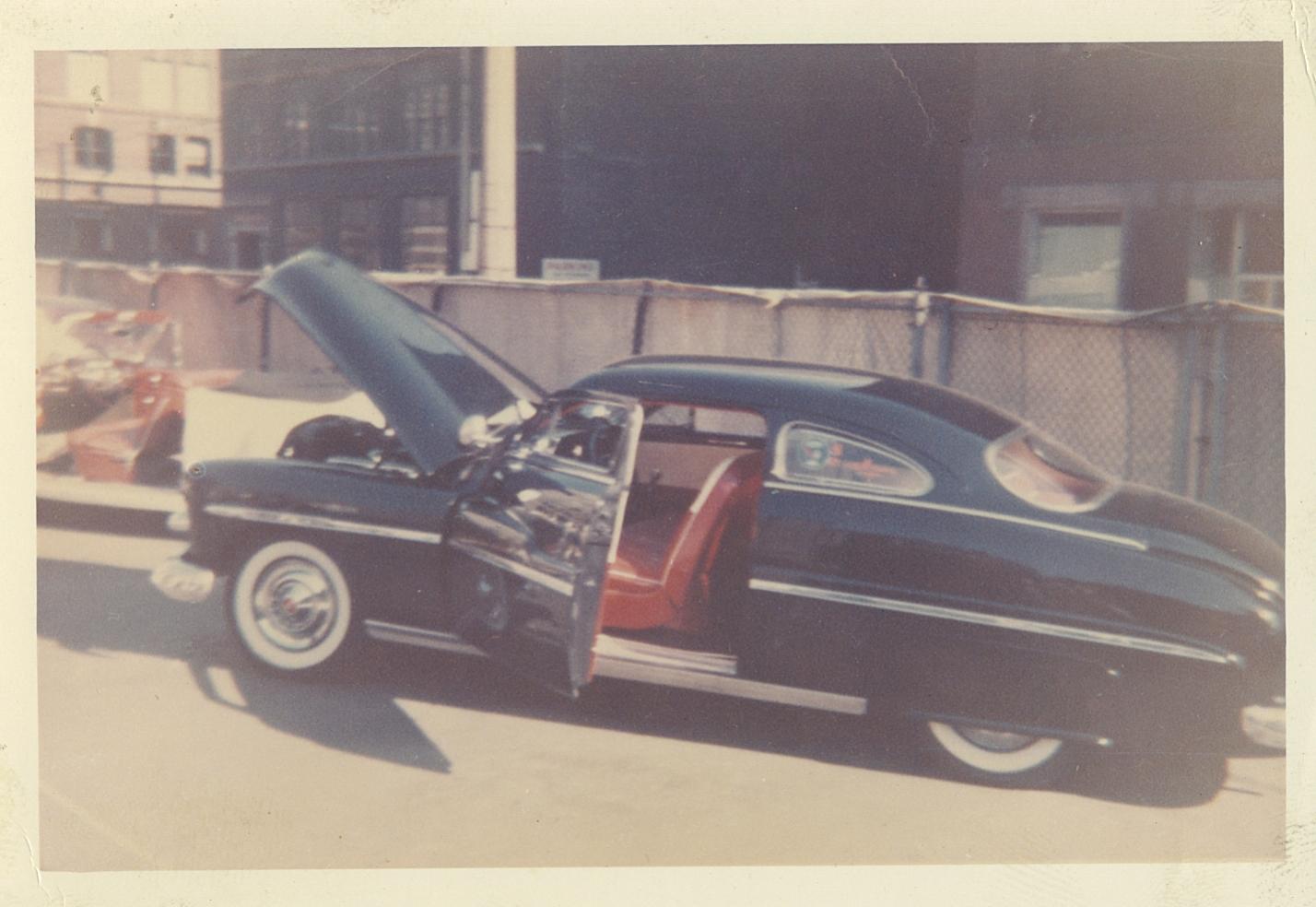

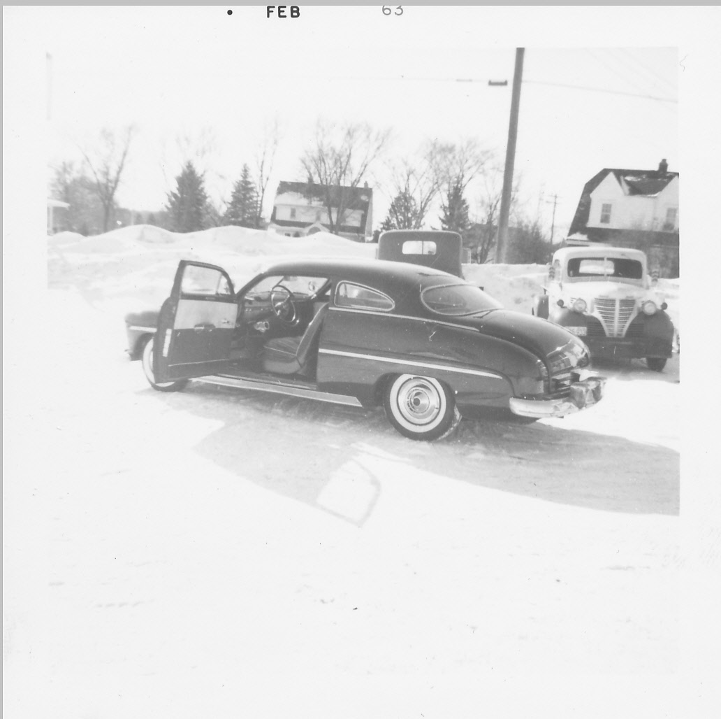

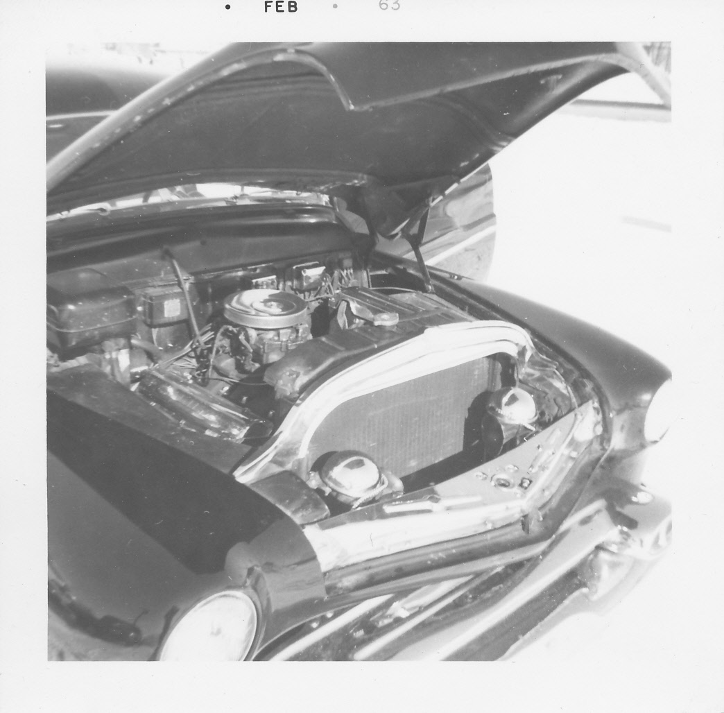

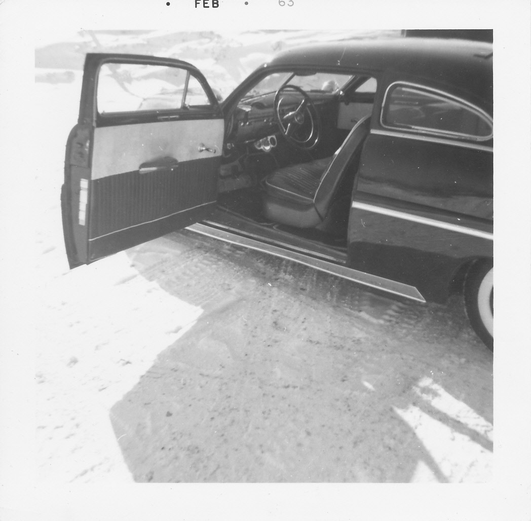

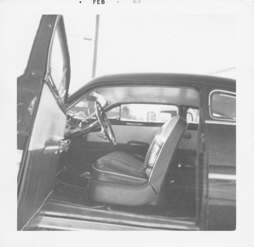

    Here is why the build is right on. See the pics of a Merc built in Milwaukee, Wisconsin. Build start was late 1953.
    The color picture was September, 1955.
    The black and white pics are 1962-63. In 62-63, the Merc was my daily driver, snow and all.
    But, the cool thing, the Merc had a 331 Caddy, Cad-LaSalle 3speed side shift with a floor shift conversion, lowering blocks-rear, lowering spacers on the front control arms, beautiful red/crème rolls and pleats, mile deep black lacquer, obvious body mods. A few things not visible in the pictures or not typical of chopped Mercs at the time were 2 small motorcycle running lights for tail lights mounted to the inside of the rear bumper guards, the original vent shades over the front door wing windows, opening rear quarter windows and chrome rocker moldings. Between 1955 and 1962, the dual quad carbs were removed and Chrysler Air Temp air conditioning was installed along with the air intake scoops on the rear quarters.
    It was daily driver for all the owners from 1955 thru 1965. Only shown at two outdoor shows and one indoor show during that time period. During the mid 50's, this Merc's build quality was at very high level and a street driven custom.
    After chasing rumors and stories for ten years, a few years ago I found the remains of the Merc in a storage building.
    Getting a bit long winded here, just wanted to let you know that your Merc hits it and why.
    Thanks for sharing and keeping it right.
