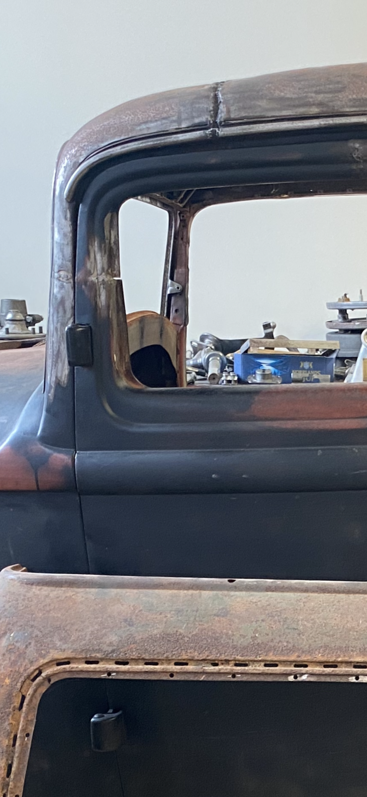

    26236F65-22E2-489E-B708-758A0C224FA5.jpeg This is how they did on my car ( 3” chop )
    Might to a re-chop and lean back pilars.
    I think the Henry welds is to right.

    Yes, that’s the original fusion weld to the left of the garbage done during the chop job. Since your chop is so sloppy, I would not call it wasted time if spent rechopping.
