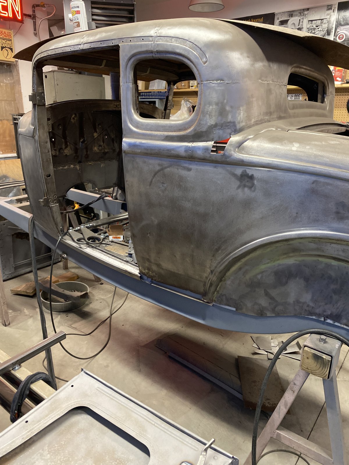

    I showed some pictures before on the chop and inside the roof.
    Its a matter of taste how to do it plus the best way to fix the chop
    Right now its a nightmare.
    Doors upper is bend and to much gap so it might need a small re-chop.
    I'm no metalguy so I has to say what I like to be done.
    If I can get rid of the ugly parts of the old extension on roof say 1/2" I might lean pillars back, but I more start to enjoy the std pillar ( plus if that was the old way )

    Now I understand your dilemma……..
    Hard to say, just looking at a couple of photos, but it looks like you would would be better off to chop it again and trim out the undesirable pieces.
    Whether you lean the pillar back or add in a new piece of roof, is just personal preference.
    Traditional way would be to add in the roof section, as @alchemy and @krylon32 have already alluded to.

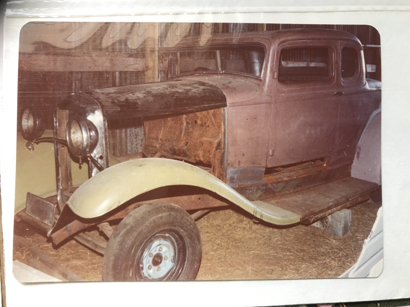

    This is the only shot I have on my phone right now. This coupe’s lineage can be traced back to 1973, and it was a beat up old hot rod then. I’d say it was chopped in the 50’s. About a 5-1/2” chop, straight down.

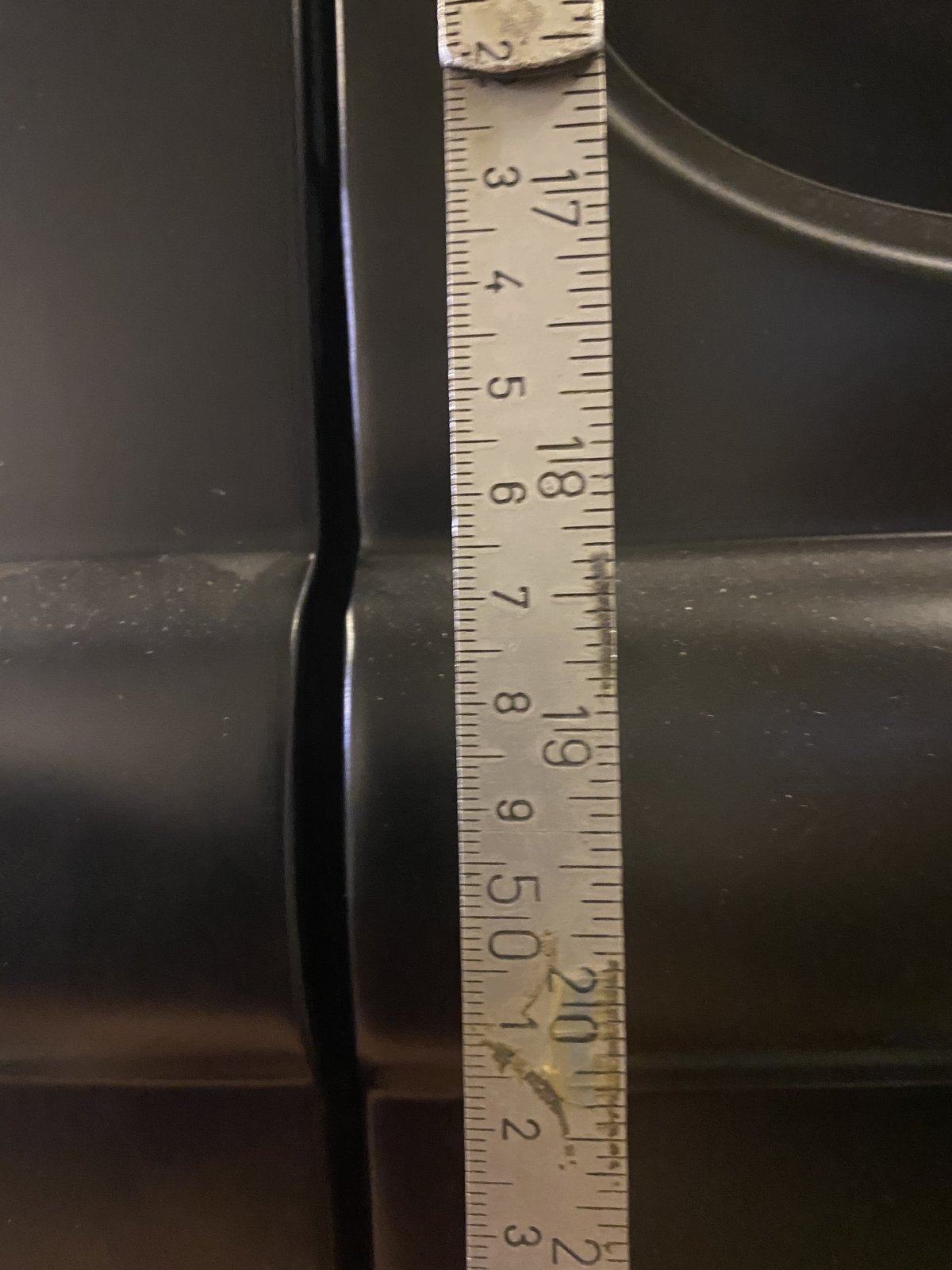

    Today I checked a std 5W coupe.
    Behind the door from upper body contour to the water drop list it was 463 mm or 18.22".
    My car had 387 mm or 15.23".
    That mean my car is chopped exact or very near 3" ( as I knew since before )
    This might be the most easy way check a cars chop.

    chopped in 1973, maybe not old enough, but at least it does have the traditional ‘caravan’ rubber moulding holding the windshield in.

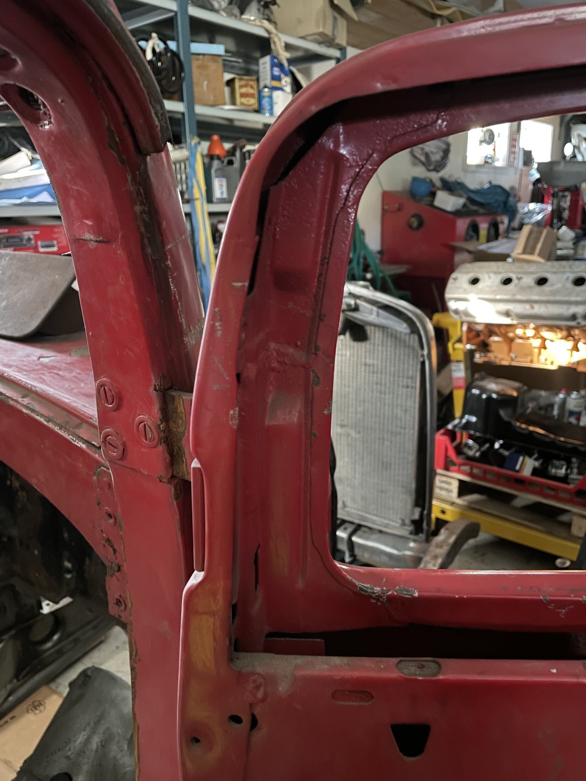

    I saw a other 5W today and it had roof not extended and lower part of pillars was std angle but half way up they had bended it ( old time chop )
    Another body ( red ) had the same style of chop.
    Maybe it was a common way.

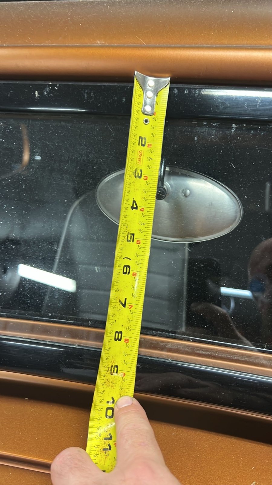

  15. Chopped Tudor
    Joined: Feb 14, 2005
    Posts: 654
    Chopped Tudor
    from DETROIT
    I will get out there and measure tonight or tomorrow for sure.
    pprather likes this.
  16. Chopped Tudor
    Posts: 654
    Chopped Tudor
    from DETROIT
    Mine is 15 1/4” as well from body line to drip rail

    ACC85AD0-272E-45EC-8BBE-0292D270955B.jpeg 9 1/2” on the windshield and the back window is 6”

    5CD0ABC7-B6B1-4AC8-8198-DF367FF88312.jpeg My is almost equal in front window at 9.5”.
    Rear window is 6”.
    The numbers I think tell the chop best is on my car 15.25”, se picture.
    I checked a very nice totally std 5W and it was 18.25”.
