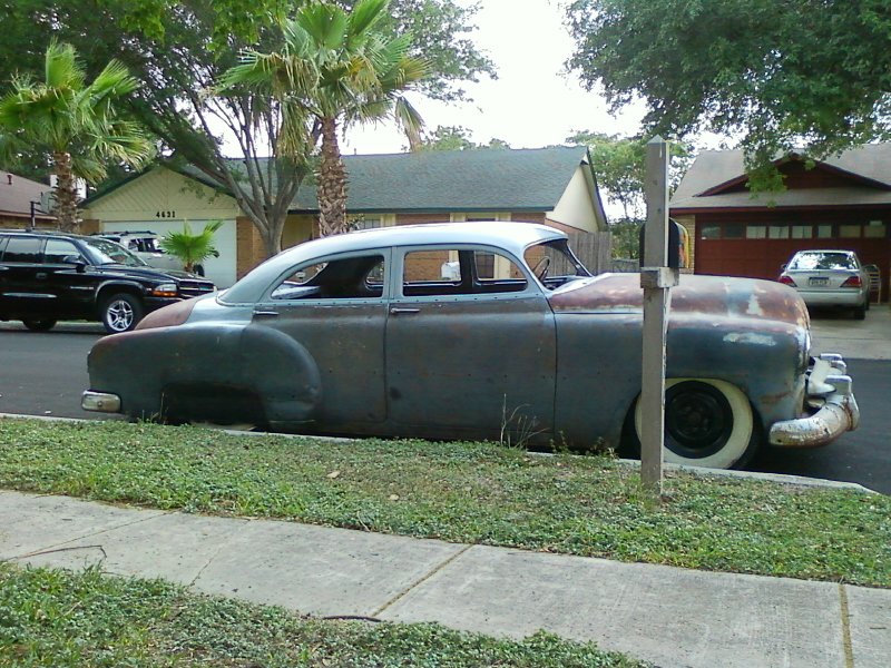

  21. droplord49
    Joined: Jan 12, 2004
    Posts: 1,721
    droplord49
    from Bryan, Tx
    Chopping a 4 door is ALOT more work then doing a 2 door, which is all the more reason to do it. The hardest part of the 49-54 Chevy cars is the rear of the roof/beltline area. Getting the window to lay down and still follow the contour of the beltline trim is real tricky. That is why you see so many of these cars with the rear gl*** moved up and a filler piece between the bottom of the window and the beltline. Here is the most recent pic of mine: chopped 4", rear window moved forward 3", drip rails molded, and roof skin sectioned 3/4" above the drip rail.

    ^^^^Should of came from the factory like that!

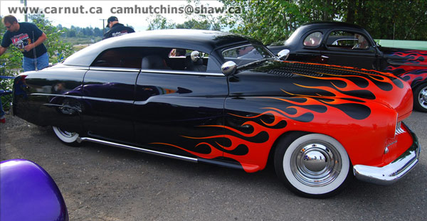

    Ok. Now i know this is obivously not my car. but a good friend of mine worked on this when he worked for Bo Huff. The "Dixie-Deluxe" I think is the nicest done 4 door merc!!! (just my opinion)
    So hell yeah!! Chop that ****!!!

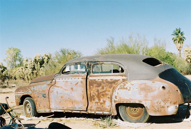

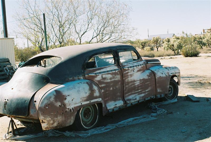

    The rear doors are a lot of work figuring out the geometry, and making it look right. I had to make the rear parts of my rear doors. Sure its a lot more work than a 2 door, but it is possible to make a decent looking car. Not all of have the luxury of money and availability of buying 2 doors.

    looks good so far,I like it
