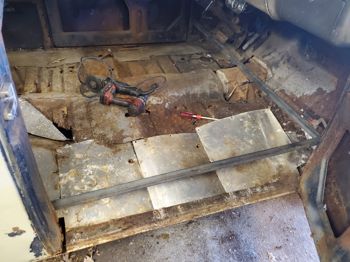

    Fast foward a few months ive finished floors after removing someone's attempt at using flashing and plywood and rivets for previous repair,i had to build new floor braces. I used generic one piece floor pans which I wouldnt recommend for most but since I built my own braces and inner rockers they worked out nicely

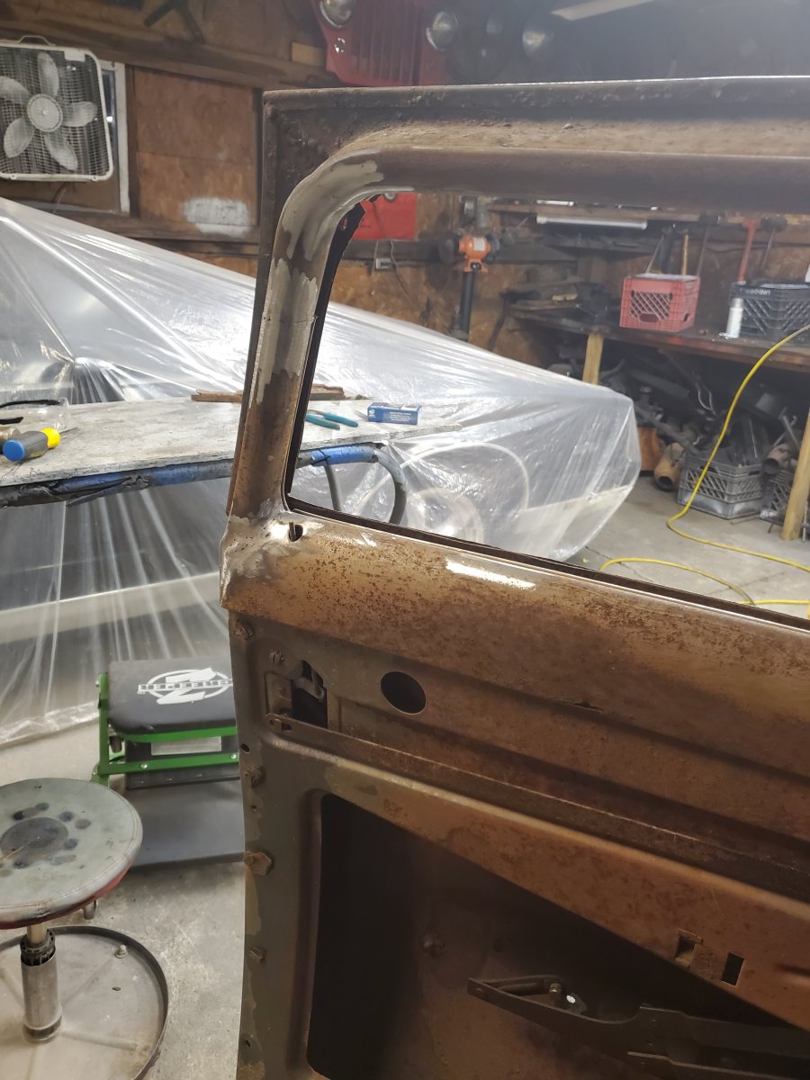

    I've gotten started on the vent windows ive finished the outer frame and pretty happy with it ive got it mocked up still need to heat and bend the window frame after I repair the broken window pivot.

    Cut down the gl*** and re***embled this evening still a few more adjustments to make but it is functioning. My next thing is reshaping the outer stainless trim I have a few extra sets so im thinking of making it two piece instead of one because of the tight curves with the slanted b pillars.

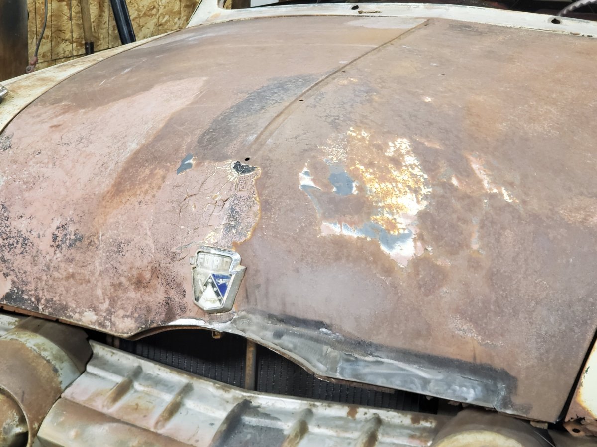

    Thank you for the encouragement. I've finally got a functioning hood now. I removed the rear brace, heated and removed the broken bolts for the hinges and after some adjusting on the hood latch panel I have it latching. The driver side was pretty rotted and I've been debating on patching middle to mimmick a 51 hood but decided to just repair rust for now.

  25. In the 50's most everyone wanted the 51 hood look, it's been only lately that the 49/50 bullet grill and hood is popular, I'd ditch the bump in the hood.
