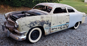

    Made the windshield templates and cut down the rubber I decided to make them out of hardboard so they were sturdy enough to test fit in rubber and install especially with the price of gl*** I only want to do it once. I got them fully installed and fit like a glove. While waiting on gl*** ill iron out some body work on windshield frame and roof

    I got the windshield installed. I also decided on a color and painted windshield frame before installing gl***. I'm very happy with the fit. My next step is to tear the front suspension apart and replace bushings tie rods ball joints etc. And hopefully make this thing a driver and enjoy it a little while before winter hits and then it's back to bodywork.

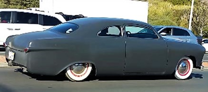

    Coupes usually do not chop well with the short roof. I thought wow, this coupe chop looks really good.
    Looking close....It's not a coupe. It's tudor sedan. This is why this chop looks so good.
    Your Tudor Sedan looks really good.

    I finished rebuilding the front suspension new buschings tie rods ball joints . I ended up cutting 1 1/2 coils off new springs sits about right. I couldn't resist sticking a fender on to get an idea of how it will sit. But I am stuck on identifying the trans as I need a dipstick tube if anyone can help it would be appreciated. Best I can tell is a 68 cruiseomatic it's a pan fill I've not been able to find anywhere to get a dipstick
