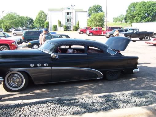

    here is a pic of my buddys 53. we started the chop in the middle of april, he was able to drive it down to minniapolis for btt50's at the end of june (painted). we used a donor roof off a 52 buick which helped lots. the chop is about 5 inches. we ended up cutting the roof into 4 sections, lining up the pillars all the way around, then we placed roughly 3" strips overtop the gaps. welded them in, cut out the whole back window frame, cut some material out of the top of rear fender and bent parcel shelf down, moved the window about 0.5" towards the trunk. laid the window frame down, and was able to use the original window. shaved the handles, hood, trunk, drip rails. that was about it. then we used a gallon of fibregl*** over all the welds. then about 2 1/2 gallons of bondo.
    like i said we started mid april, and just working weekends we were able to have it painted by mid june. there was about 3-4 of us usually working on it. and for all of us it was our first chop.
    sorry i don't have a better pic of it. this is all i have. if you really want i could take some more detailed photos.

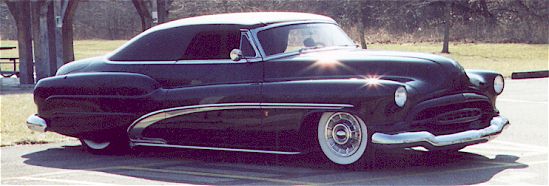

    This one is my favorite:

    ooooo, you have hit the nail on the head with that one!
    keep em coming chaps!

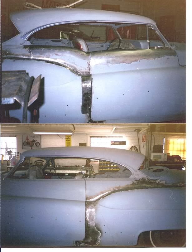

    Heres some semi ****py pics of a 53 I did some work on a few years ago. I grafted the dip from a 56 Buick to the side of it to make sort of like a Skylark hardtop. The interesting thing was it made the car look like it was sectioned, and really took a lot of bulk out of the side of it. Sorry I don't have any better pics of it.
  23. That looks sweet Terry- it accents the roofline......

    Thanks Ken, it actually made it look not as chopped because of the larger window opening. It was a unique effect.

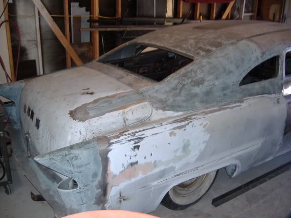

    chopping one right now, anyone else knock one of these out since 2006?

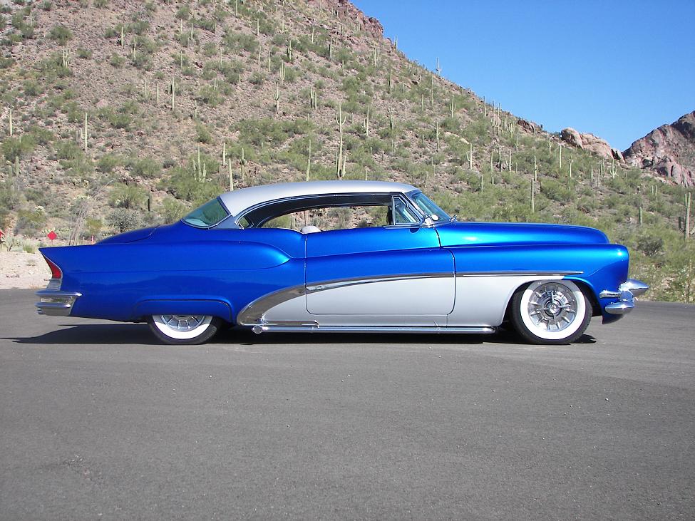

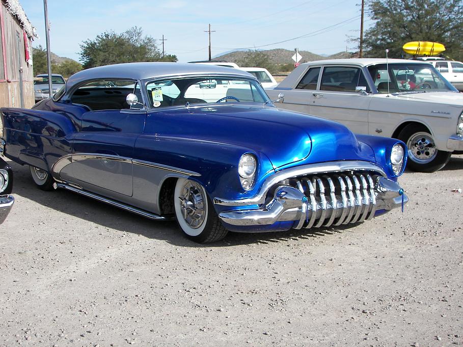

    Here are some pics of the finished 53 Bick Super. Terry does some fantastic

    Here are some pictures of the finished car

    what was done to the back window? aftermarket cut down, moved, sunk..
  30. padorey
    Joined: Jan 20, 2007
    Posts: 282
    padorey
    The rear window frame was cut out, leaned forwardto meet thecut roof. this left a about a 3 inch gap between window frame and the panel above the trunk. That panel had to bee hand made. Using the stocr original rear gl***
