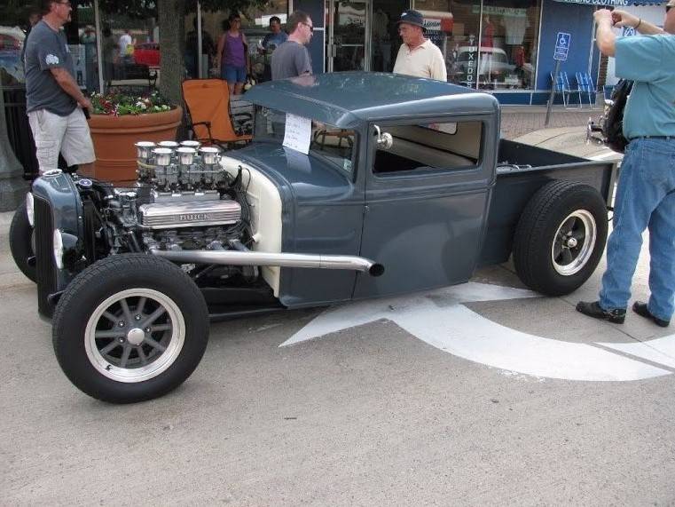

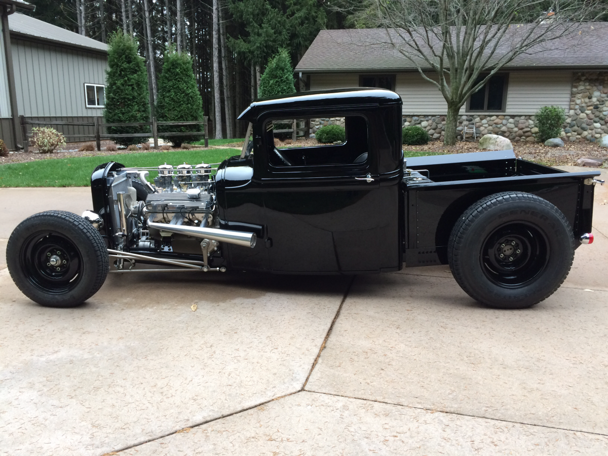

    As much as i like those pickups and I do....they are more shop truck less Hot Rod for my liking. If it comes out half as good as Jeff Norwell's or 1927Graham's I'll be a happy camper.

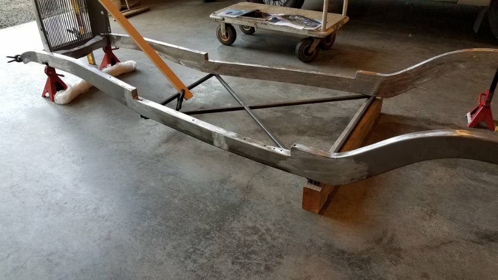

    Rick Flake's "Barebones" 34 sits on 32 rails. He kicked the rear and pinched the front. barebones1.jpg
