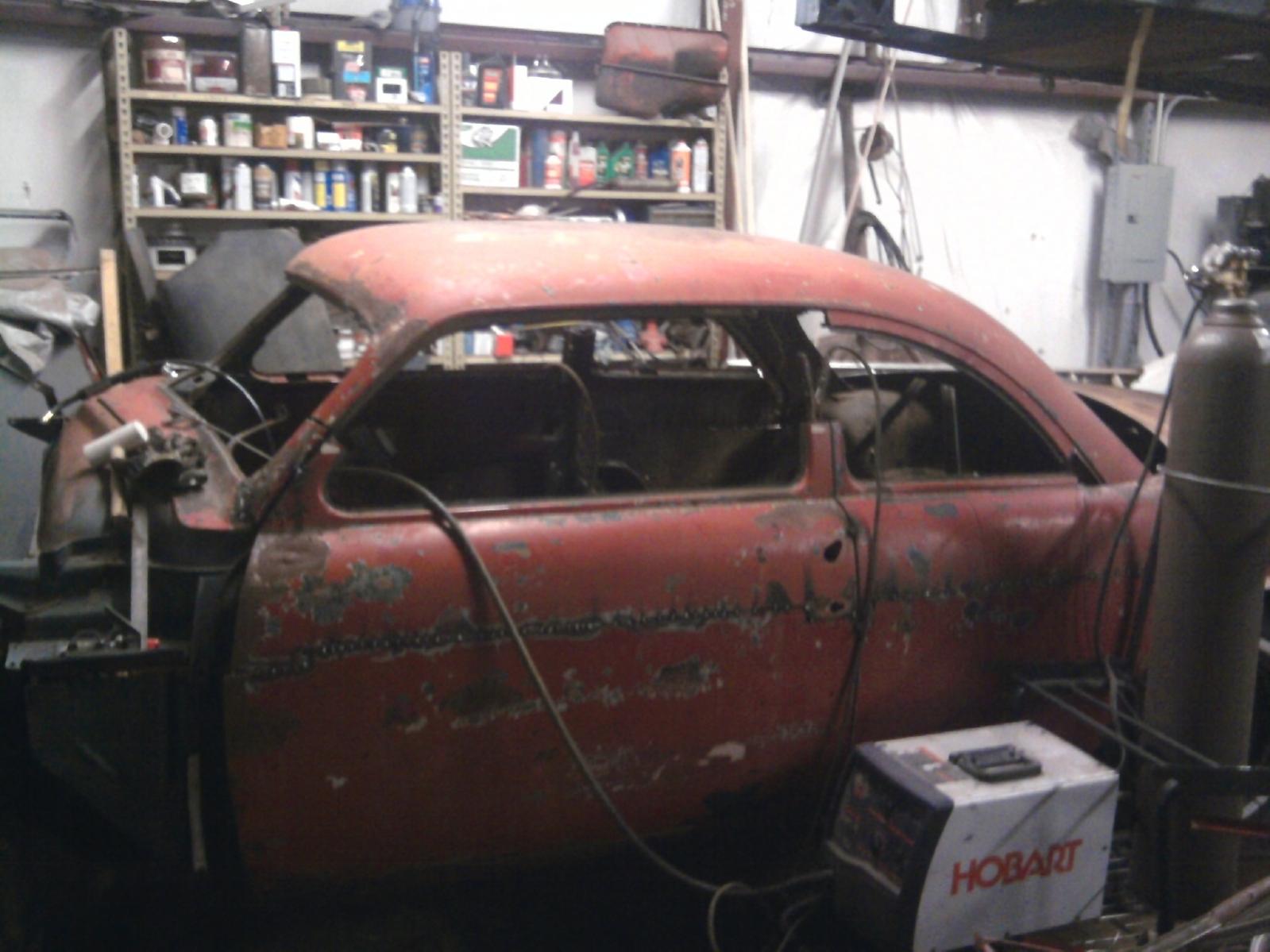

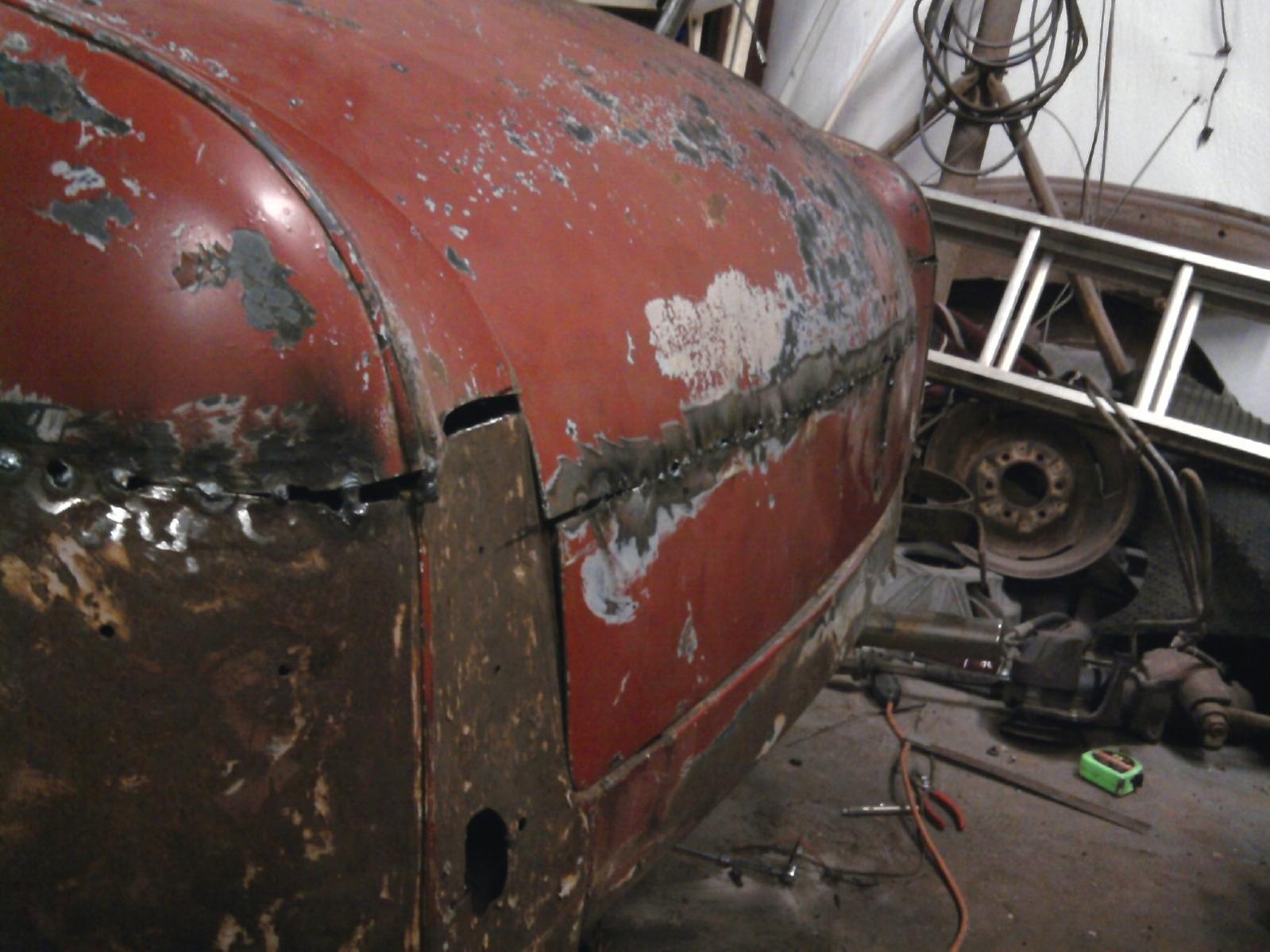

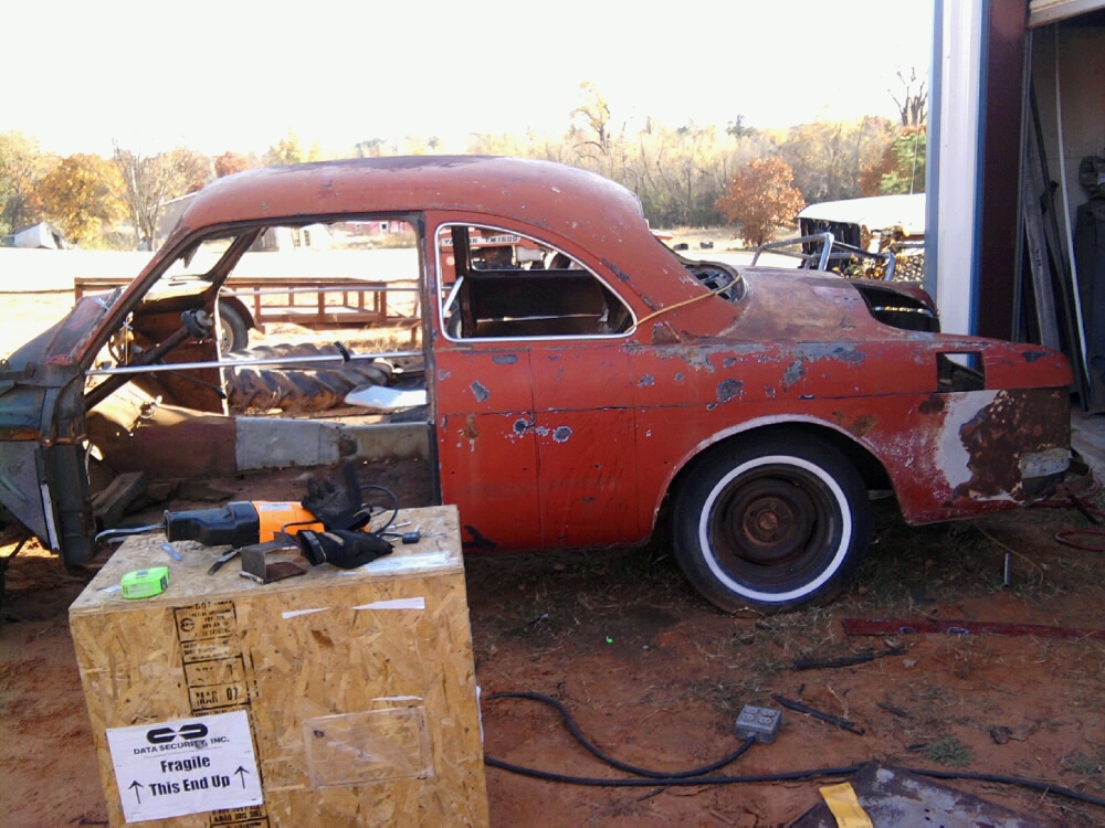

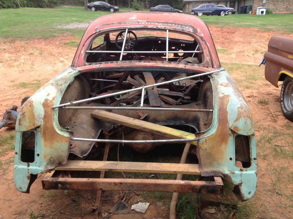

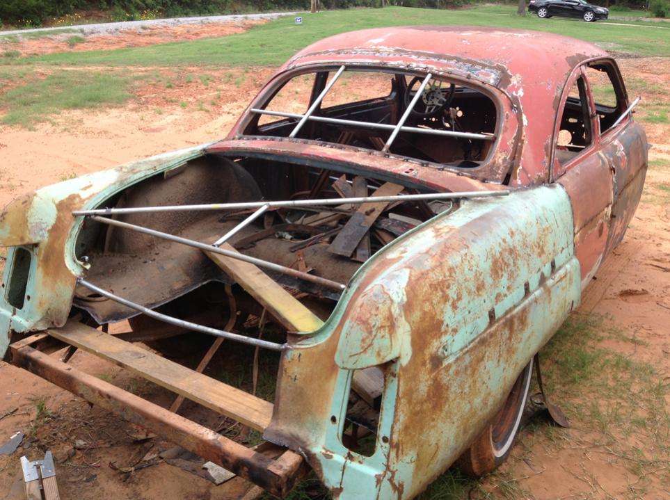

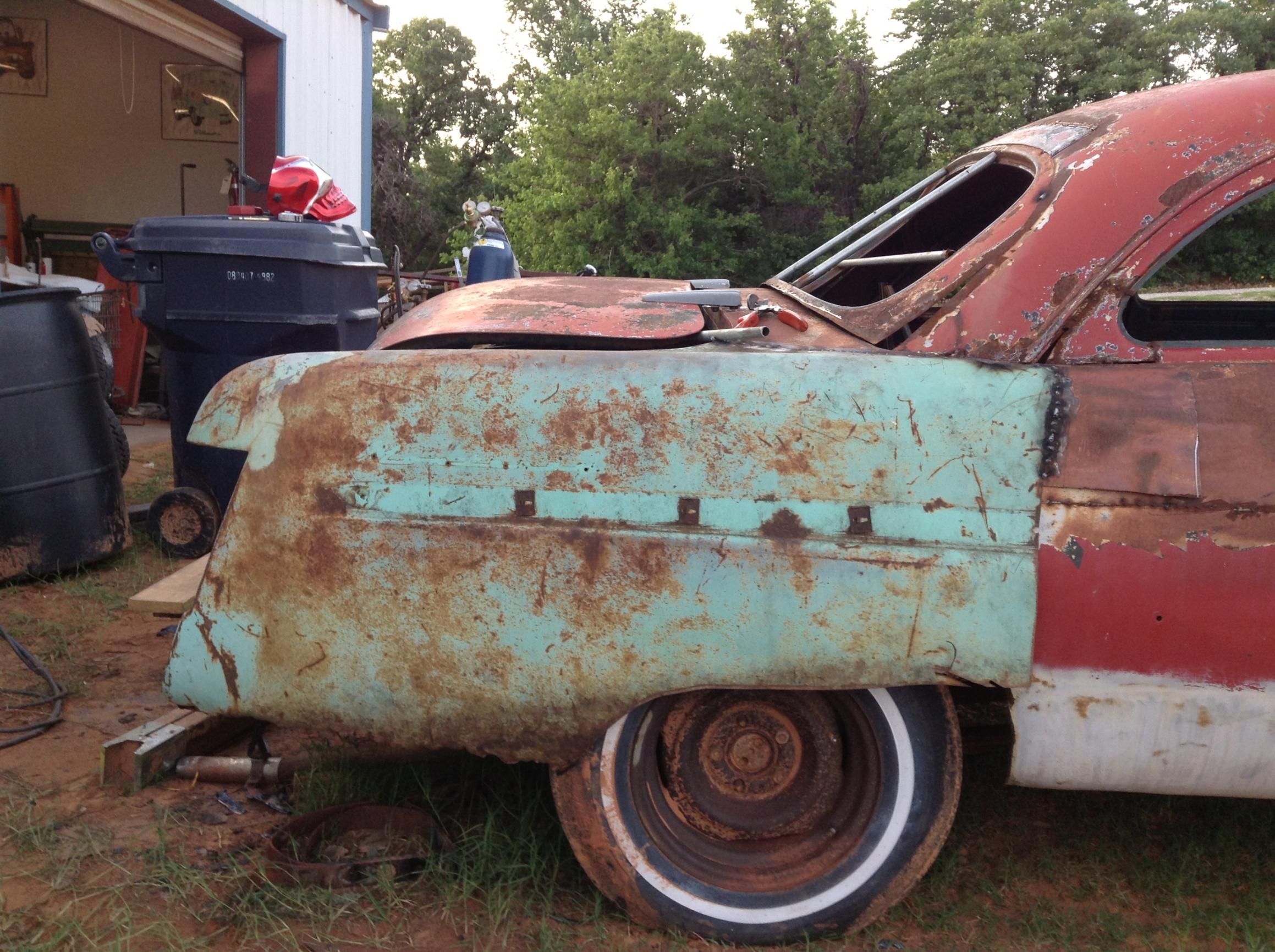

    I finished my first mild custom, another Shoebox, last year and have been itching to start something new since. My dad had this sitting in his yard with no plans to do anything with it, so I convince him to let me have it to tinker with. My main goal is just to learn as much as I can while working on it and improve the skills that I learned on the first one while pushing myself to step outside of my comfort zone. I started out knowing that I wanted to chop and section it, but I don't really have anything else set in stone. Here's progress so far. I sectioned it 4 inches and chopped it 2, and I'm working on getting everything lined up and looking good before I weld it solid and clean it up.

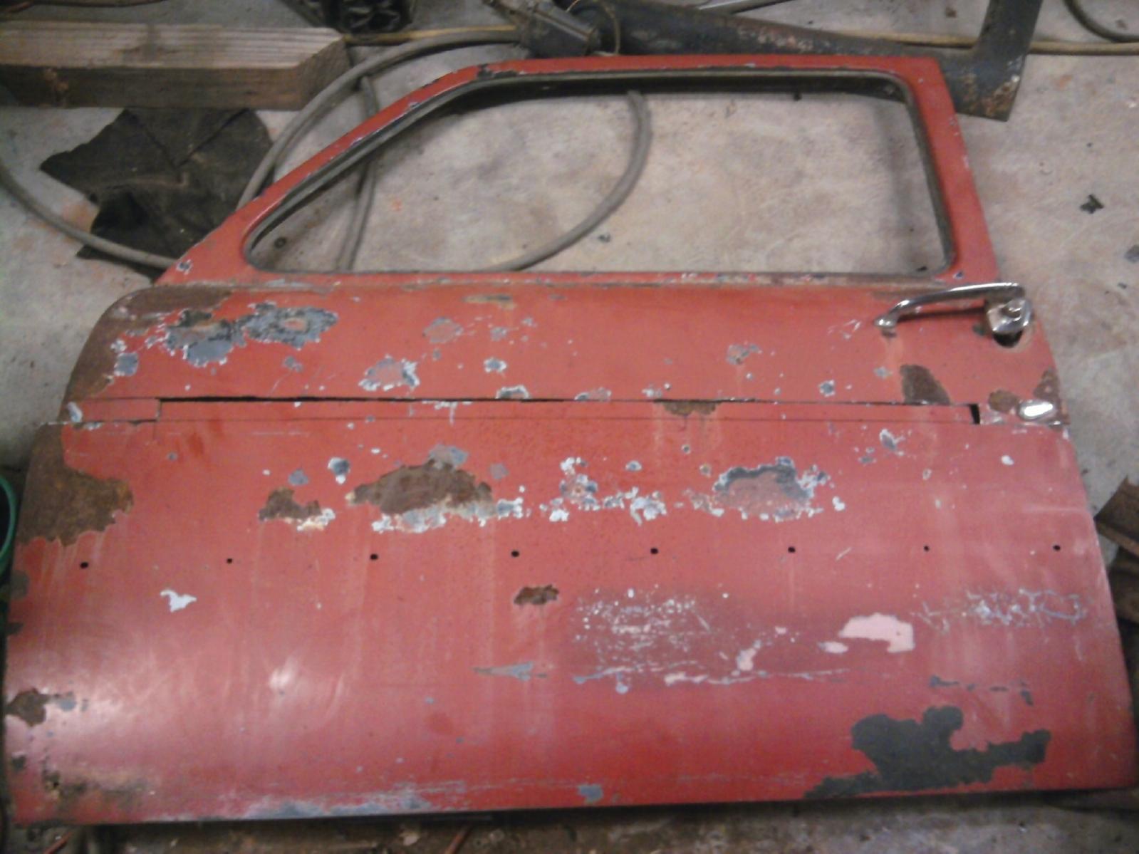

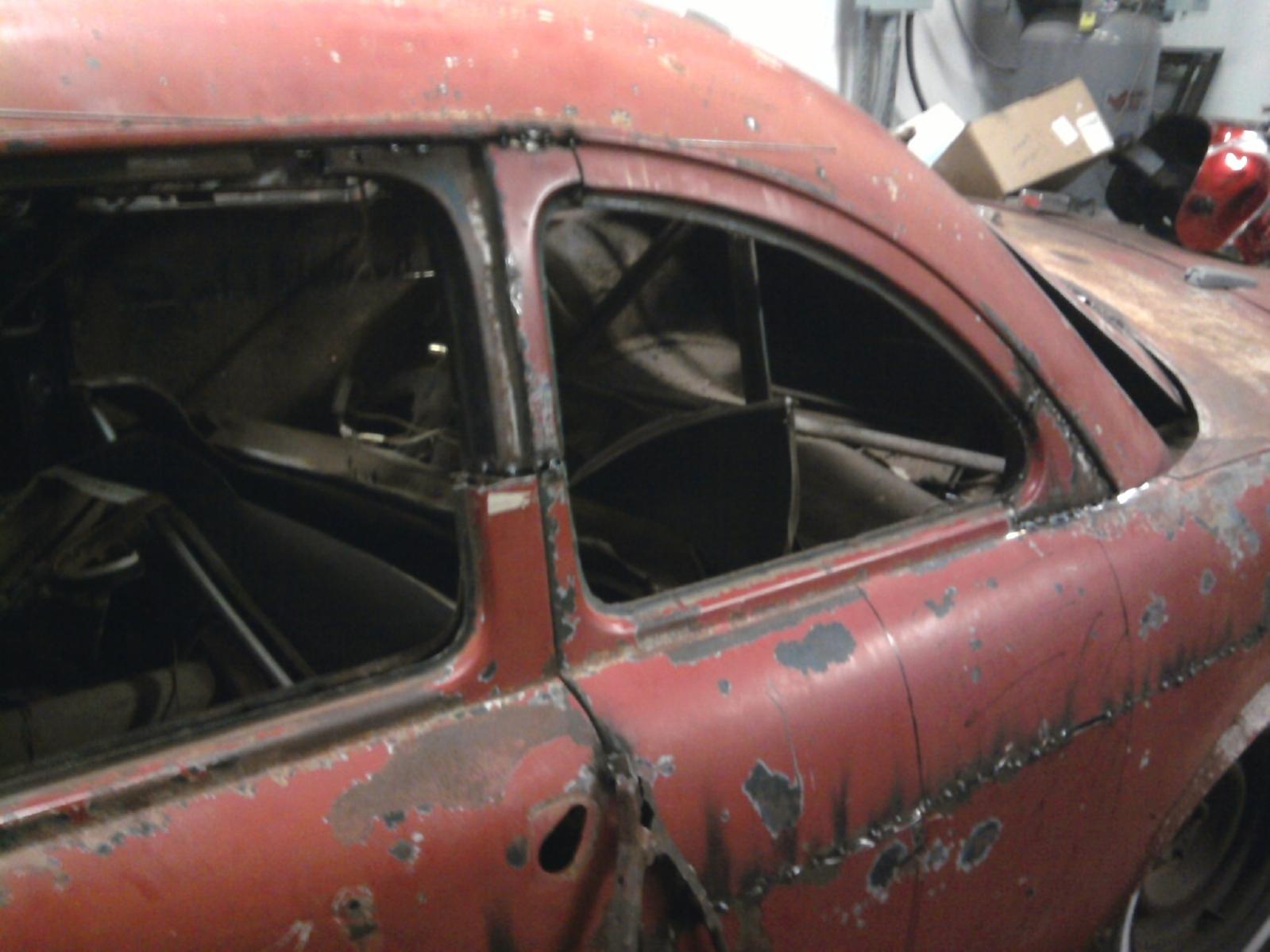

    Some more pictures. I try to work on it most weekends, but it's been pretty busy lately.

    awesome car. was the sectioning a nightmare? or prett straight forward?
  4. Young_Thiel
    Joined: Feb 6, 2012
    Posts: 22
    Young_Thiel
    It actually wasn't too bad. I made sure to measure everything about 3 times before and after cutting. The worst part was the back quarters. They're so far gone that they're really flimsy, and it didn't help that someone had cut out the quarters to accommodate wider tires.

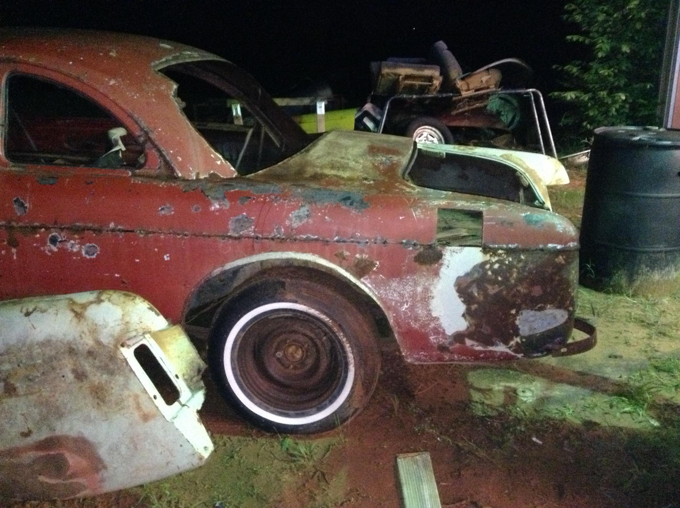

    More

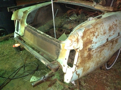

    Got back from work training and started right back in. I got the quarters attached, so I started building the lower back part under the trunk. Once I got a piece made and put in there, I made the channel to go around the bottom of the trunk opening. I started relaxing the curve of the trunk inner support tonight to fit the curve of the new quarters, and I'm hoping to have the inner supports of trunk done by the end of the week. This means I have to make a new support structure for the bottom part of the trunk(which I also started tonight) and blend it in to the existing supports in the next few days. It's actually starting to take shape. I'm pretty excited about it.

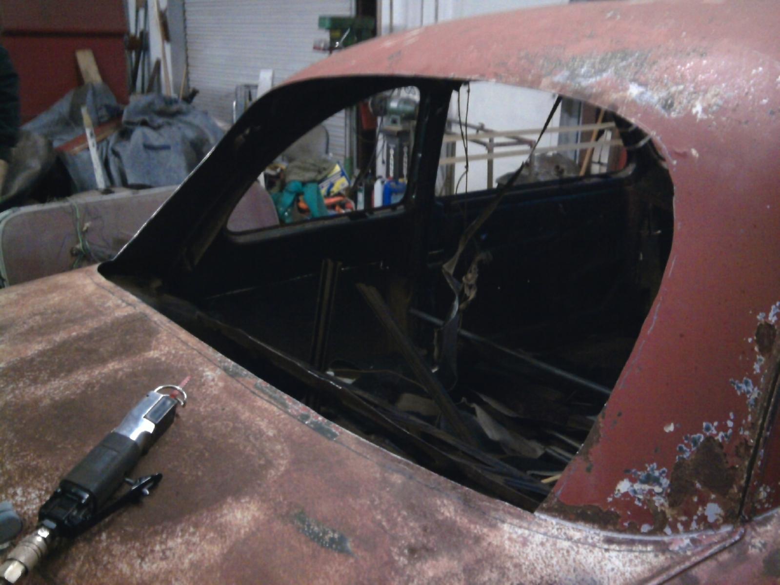

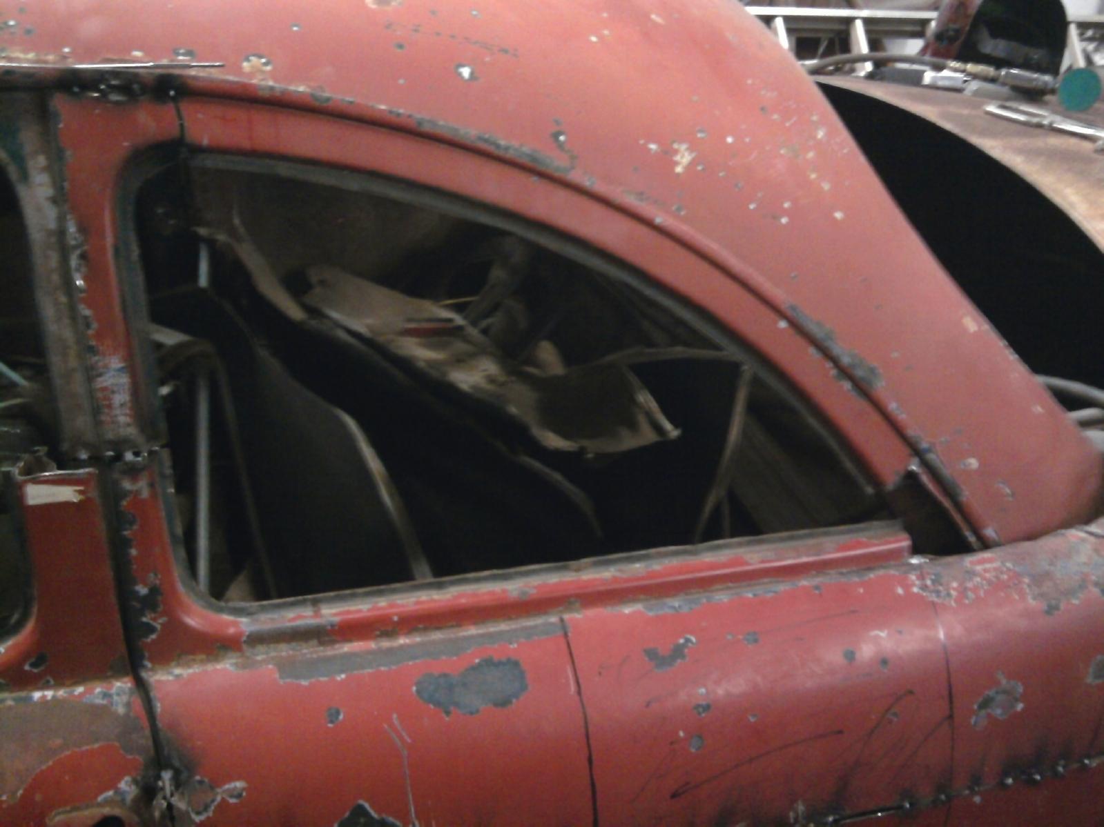

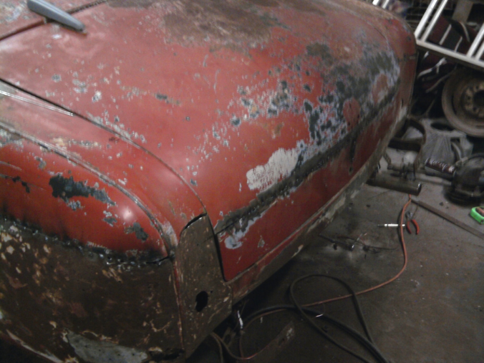

    It's been awhile since I had an opportunity to get out and work on this project. Life seems to always get in the way of working on the fun stuff. The good thing about a prolonged break from a project is that it can give you new perspective. I realized the back window needed to slant forward a bit more, which meant I need to lower the back end of my chop a few more inches. IMG_3790.JPG IMG_3812.JPG

    Got out and did a little more work this weekend. Got the driver side cuts in to match those on the passenger, then once everything was in place I got it welded up. Earlier this week CB_Chief was messing around with a pattern for the back sail panels, so I used his pattern to cut out some sheet and shape the panels. Once he and I had them pretty close to the correct shape, we cut out the excess medal and tacked them in place. I have to say, it doesn't look too bad for the amount of time it took.
