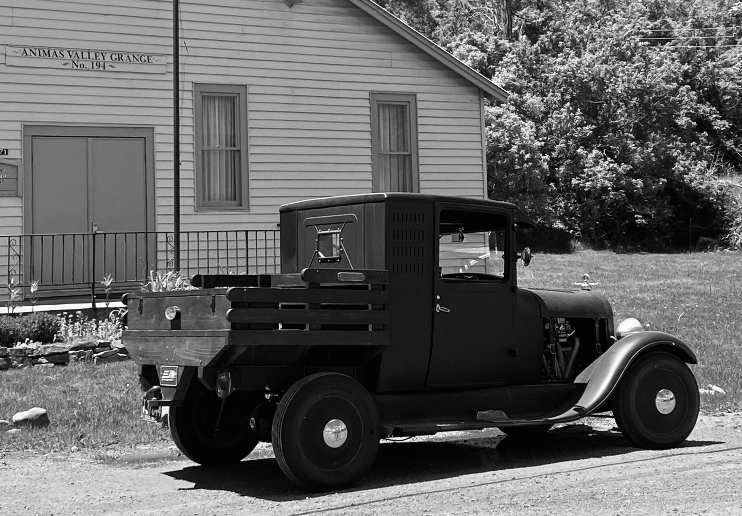

  15. denis4x4
    Joined: Apr 23, 2005
    Posts: 4,430
    denis4x4
    from Colorado
    You can buy extended 28-29 cab corners and rework the top wood to give a better profile. These corners are 6-1/2" longer than stock
  16. 05snopro440
    Joined: Mar 15, 2011
    Posts: 3,223
    05snopro440
    Full fendered 28-29 closed cab pickups with a good stance are just the best.
  17. krylon32
    Joined: Jan 29, 2006
    Posts: 11,183
    krylon32
    from Nebraska
    Chopping screws up the proportions. There are cabs that look better after a chop but the 28-29 pu cabs aren't one of them. The black one flatpete shows is a textbook of how to build a 28-29. Check out the 28-29 pickup Jack Linden from Prescott AZ built a few years ago. It says it all. Leave the sheet metal stock and slam them on the ground. Just thought of another, windshield wiper Bob from Newport Engineering has been driving a stock bodied/slammed 28-29 for decades. It's powered by a Chevy II 4 cylinder. A couple years ago he made the trip to the LARS pulling his gennie teardrop camping trailer. I've done several slammed customer ch***is for 28-29 trucks using the 4.3 V6, plenty of power and they fit between the stock firewall and radiator under a stock hood. Good luck.

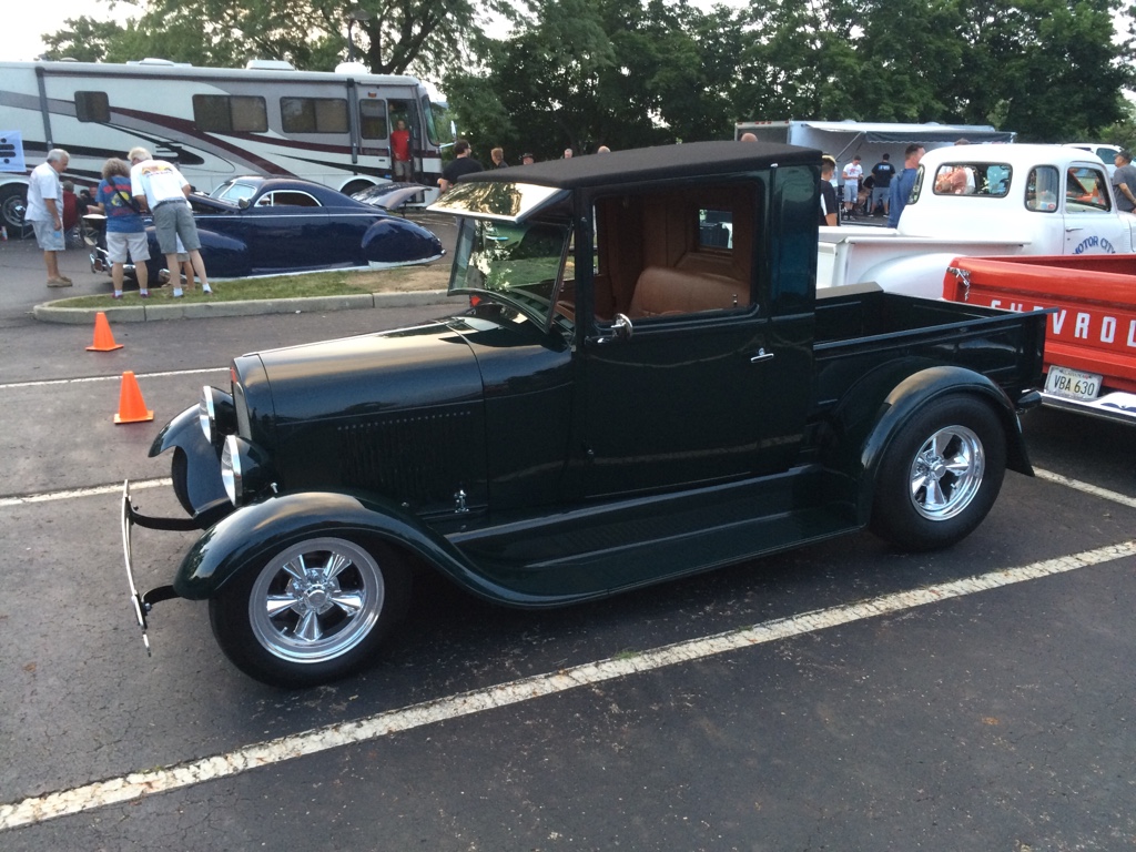

  18. chickenridgerods
    Joined: Jul 22, 2003
    Posts: 1,561
    chickenridgerods
    from DSM, IA
    The '28-29 CCPU just doesn't lend itself well to being chopped. Any chop has to be a very subtle one to work well. Super easy to screw up the proportions as @krylon32 notes.
  19. Just Gary
    Joined: Oct 9, 2002
    Posts: 5,907
    Just Gary
    Case in point:
    @Jersey Suede 's CCP.:cool:
    SOHC427, charleyw, jet996 and 3 others like this.

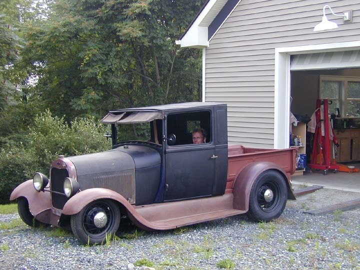

  25. clem
    Joined: Dec 20, 2006
    Posts: 4,730
    clem
    05snopro440 and Jess Rockatansky like this.
  26. 05snopro440
    Posts: 3,223
    05snopro440
    That type of subtle modification is what was done to the truck we were discussing in the 3 posts directly before yours.
